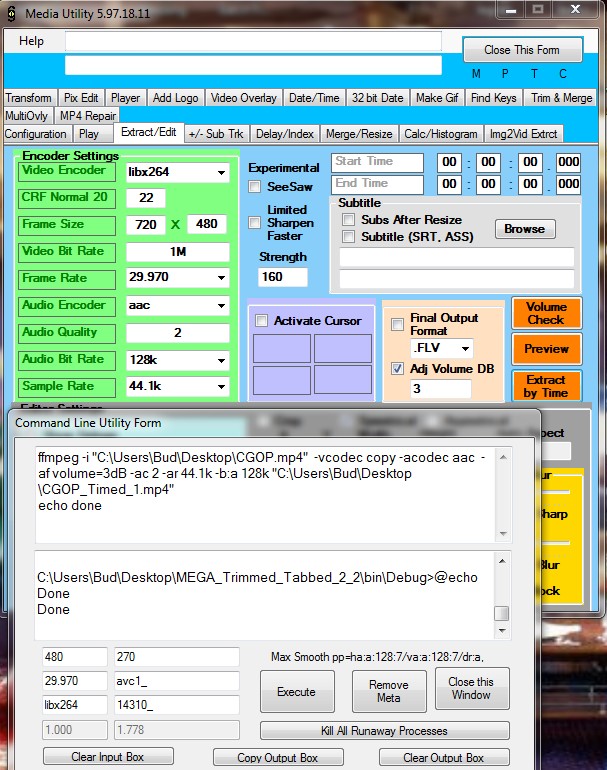

    Since audio files tend to vary throughout, you can use ffmpeg to get a relative indication of how many frames will be affected by the +/- setting.
    The mean volume below is -18.5 but has roughly 25000 out of 11823104 total that may be distorted if raised too high.
    "ffmpeg" -i "C:\video.mp4" -af volumedetect -f null NUL
    Data: [Parsed_volumedetect_0 @ 00274240] n_samples: 11823104
    Data: [Parsed_volumedetect_0 @ 00274240] mean_volume: -18.5 dB
    Data: [Parsed_volumedetect_0 @ 00274240] max_volume: 0.0 dB
    Data: [Parsed_volumedetect_0 @ 00274240] histogram_0db: 698
    Data: [Parsed_volumedetect_0 @ 00274240] histogram_1db: 2774
    Data: [Parsed_volumedetect_0 @ 00274240] histogram_2db: 7673
    Data: [Parsed_volumedetect_0 @ 00274240] histogram_3db: 15107
    NOt a visual indication you would have to weatch all the way through but a snapshot of the whole file.

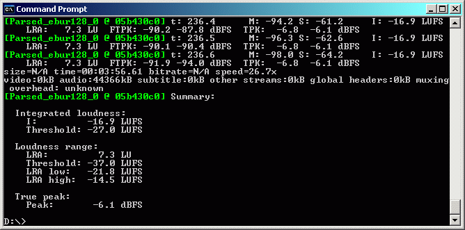

    Screenshot 1 is an ffmpeg scan. The volume is -16.9 LUFS (effectively -16.9 dB).
    Screenshot 2 is after a foobar2000 scan. The scan resulted in the same volume, but it's shown as the adjustment required to achieve the ReplayGain target volume of 89dB, or -18 LUFS (effectively -18 dB).

    However I can't pipe the ouput to a file e.g.
    ffmpeg.exe -nostats -i u80_258a.mp3 -filter_complex ebur128=peak=true -f null - 2>&1>outputfile9.txt
    writes an empty file.
    At one stage it wrote a log, but I can't get that again. Is there an instruction to always wrote a log ?
    If I can export the data somehow my aim now is to run a batch and compare Summarys, This may identify when files need levels adjusted.
    PS Is it possible to get a Summary only ?

    ffmpeg will adjust the level of the audio but if you use the
    -af volume=3db
    format, this calls for re-encoding audio. The other option would be to use ffmpeg to write the correct tag or add it if that is possible for ffmpeg.
    Tested below for reencode:
    [Attachment 47034 - Click to enlarge]
