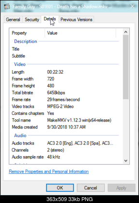

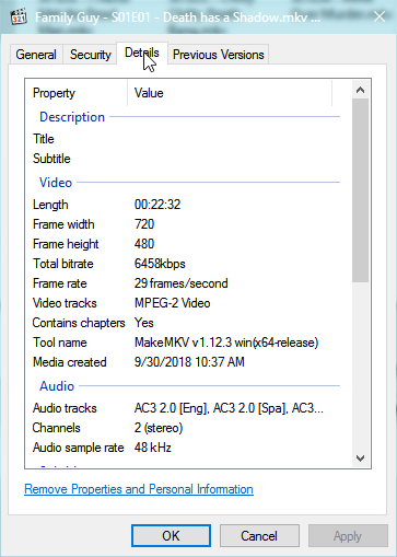

  1. I used MakeMKV to REMUX a Family Guy DVD (Volume 1 Season 1). The weird thing is, in MediaInfo the FPS shows up as:
    Frame rate                               : 24.586 FPS
    Original frame rate                      : 23.976 (24000/1001) FPS

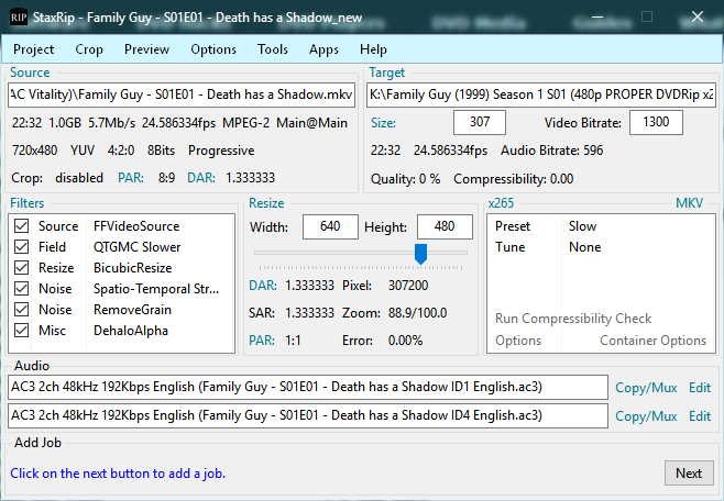

    But if I right click the MKV it says 29 frames per second. When I opened it in StaxRip it shows up as 24.586334FPS. When I tried to do an x265 encode everything was screwed up, the audio was out of sync, ect (while that encode always said 24FPS). I'm confused, aren't DVDs normally 29FPS? I did not IVTC, only QTGMC Slower. Why would a Remux of a DVD be 24FPS? I am 100% sure the source MKV is not re-encoded.

    It sounds like a small section of it is either hard telecined or interlaced. The majority of it has pulldown flags so it's 23.976fps, but some of it, even just the studio logo at the start, or maybe the credits, is either interlaced or hard telecined, making those sections 29.970fps.
    I don't use StaxRip, but by default ffms2 ignores pulldown flags and outputs the average frame rate. The small section at 29.970fps would explain why the frame rate is shown as something a little higher than 23.976fps. 24.586fps would be the average frame rate.
    Maybe when you switched to opening the vob file, StaxRip switched to decoding with DGIndex instead and it decoded the source differently. Or it told ffms2 to obey the pulldown flags It's probably not MakeMKV's fault.
    All the above is theory, but it's a logical reason. ffms2 needs to be told to obey pulldown flags with the rffmode option. Something like:
    FFVideoSource("D:\video.mkv", rffmode=1)
    That'd cause ffms2 to decode everything at 29.970fps, and then you'd have to apply IVTC and/or deinterlacing as required.
    The only way to know if that's likely to be the problem is to see the scripts StaxRip was creating for encoding.
