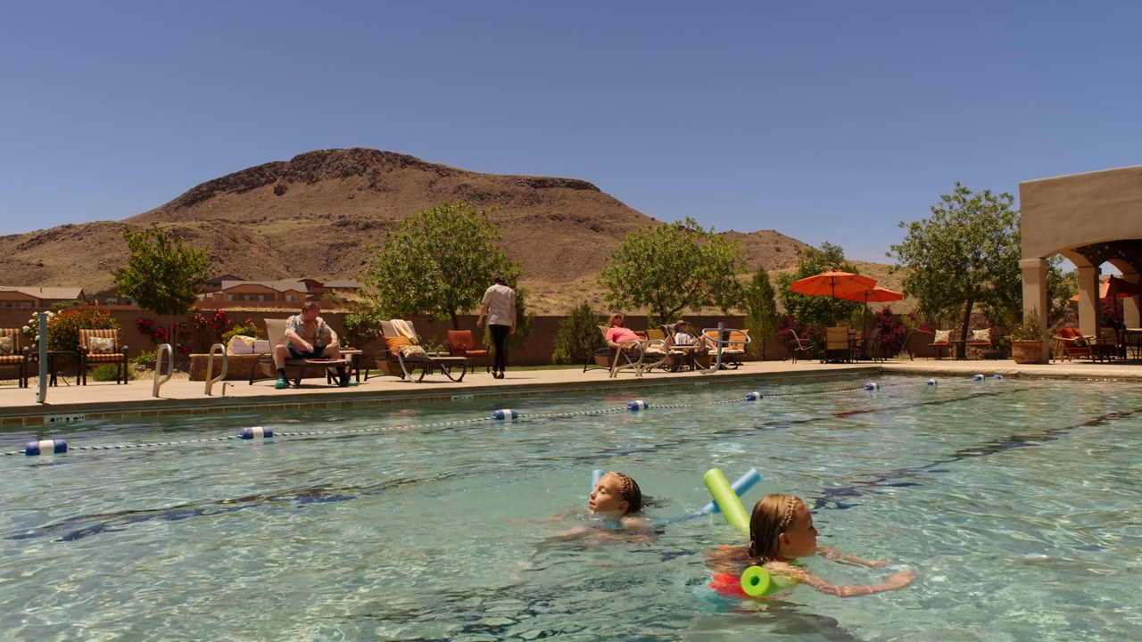

    Anyway, I gave it a spin (Spline36Resize). A 720p image downscaled to 640x720 and back to 1280x720, and also downscaled to 1280x360 and back. Often there wasn't a lot in it. One part of a frame looked better when the width was downscaled and it looked better in another part when the height was downscaled. If I had to pick a loser though, it'd be the height downscaling. It lost here due to the pool rope, but overall it did more damage than the width downscaling. Chances are I could have hunted for a different frame with more fine vertical detail (lines and edges of objects in a vertical direction) and the Top Over Bottom version would've looked better, but I suspect the horizontal edges here would be more typical.
    1. Original
    2. Side By Side
    3. Top Over Bottom
Name:	Side By Side.png
Name:	Top Bottom.png
