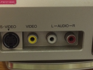

    My VCR has bank of yellow, white and red connection points at front (see Photo). When I connect the Capture cables, red, white and yellow, (video and audio L and R) , press play button on VCR and switch on the Capture record button, I should be able to capture the film on my laptop. However it doestn't work. The problem is with the JVC bank of sockets - although the connection is properly made they are inactive. How do I activate the bank of sockets. See the Photo of them below.
    Image Attached Images
  2. Apparently, you have to first access the menu and set the VCR for either IN or OUT:

  5. Originally Posted by EamonX1 View Post
    My VCR has bank of yellow, white and red connection points at front (see Photo)...
    Those jacks are input-only, you have to use the output ones at the back.

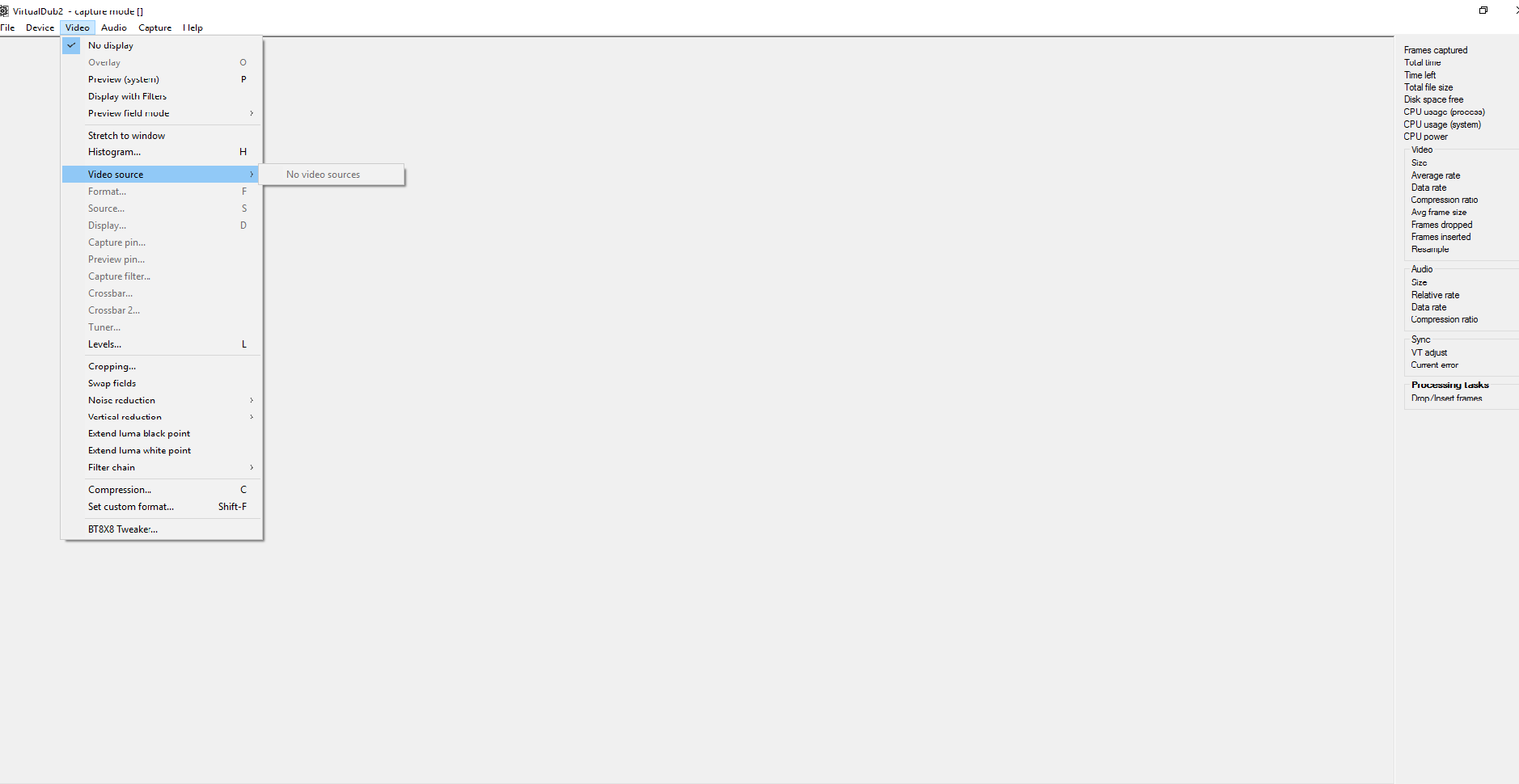

  19. What software are you using to capture on a pc? If you use virtualdub it sometimes "forgets" or switch the input with some tv capture cards( from Svideo to comp or tvtuner ) you should select again
    [Attachment 47000 - Click to enlarge]

  21. In VirtualDub2 -- what's in the Device menu? Try both 32 bit and 64 bit VirtualDub2.
  22. In VirtualDub2 -- what's in the Device menu? Try both 32 bit and 64 bit VirtualDub2.
    Mine capture card was not connected (usb ) that's why it didn't show in sources and devices, I wanted to show him that sometimes virtualdub (switches sources without notice tvtuner/svideo/comp my card was avermedia pci card that had the problem ( driver software compatibility problem probably) and after recording (set to svideo) was returning to tvtuner ( or it stayed unselected) and had to manually set each time to get the picture out of vcr.

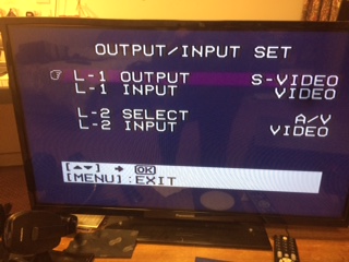

    I checked the user's instructions for the Capture program. The name of the program is Ezgrabber and it is a program on the One Touch Video Capture (Diamond) CD. There is no instruction about the S-Video setting. In any case I downloaded the VirtualDub trial program and ran it, with the same result. It recorded the Audio but NOT the Video. Does that indicate a problem with the VCR. I attach a screenshot of the VCR Input-Output set screen. I have the Output set to S-Video. (I think i have uploaded the screenshot - click on My files below)
  24. Member
    May 2015
    Ireland
    The Screenshot does not seem to have travelled. I enclose it here.
  25. Member
    Aug 2010
    San Francisco, California
    The s-video jack on the back is output only, according to the manual, so you shouldn't have to fiddle with any menu settings. What does "NO VIDEO" mean? Black? Snow? Something else?
