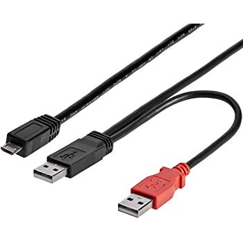

    Also, is there only one plug coming from the cable connecting the drive the the computer or are there two? If there are two, they must both be connected, again to ensure enough power going to the drive.
    [Attachment 46987 - Click to enlarge]
    I had an external Blu-Ray drive that only had a single USB 3.0 plug and even when it was connected directly to computer, it would have a problem spinning up. I returned it and got one with dual cables and it works fine.
