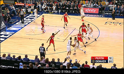

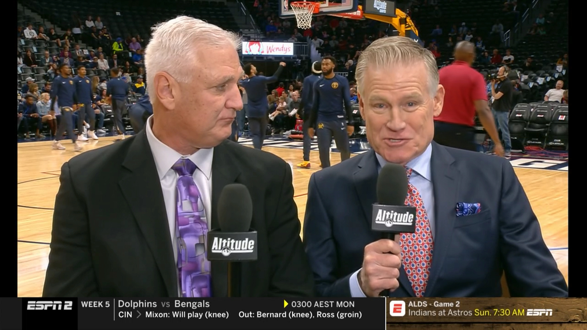

    I want to get rid of the pillarboxing and the ticker. But it's interlaced, so I'm assuming it's not as simple as a crop-and-resize by the relevant number of pixels.

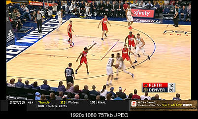

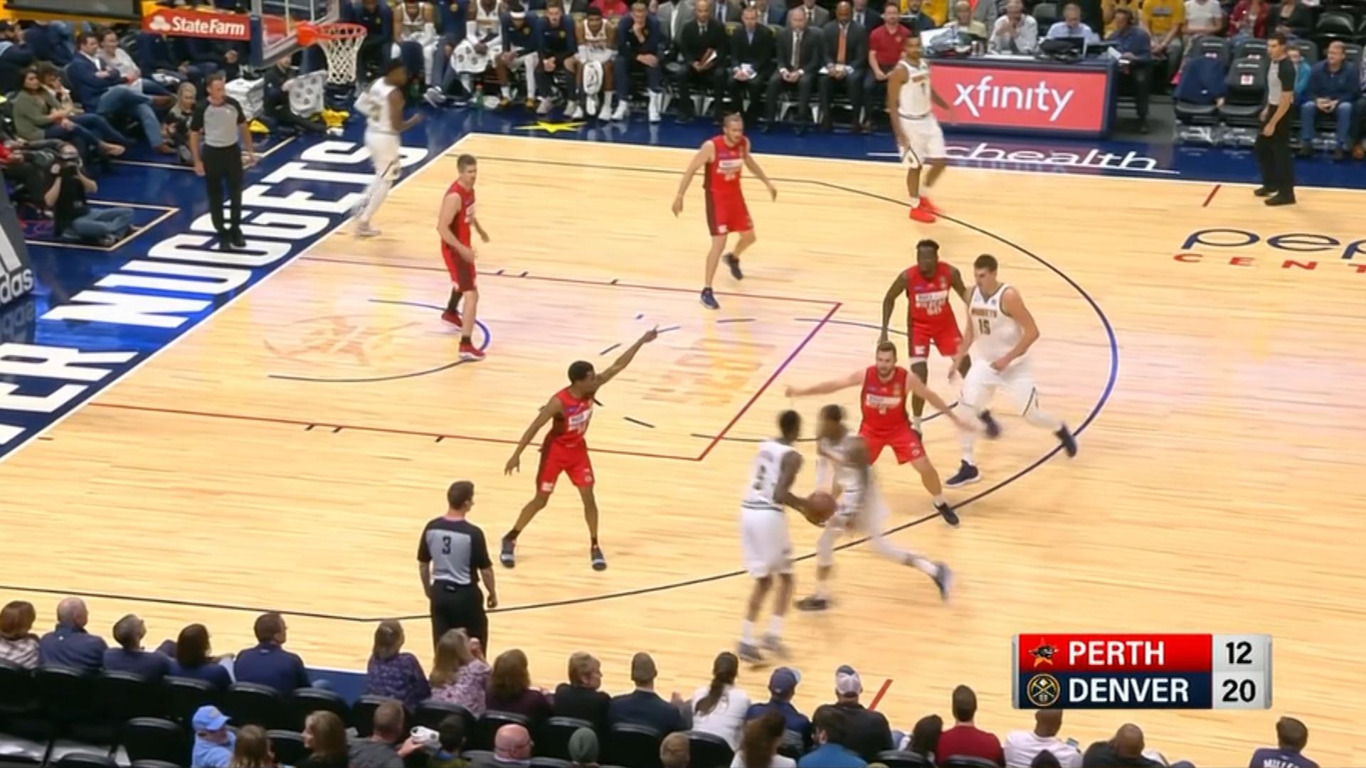

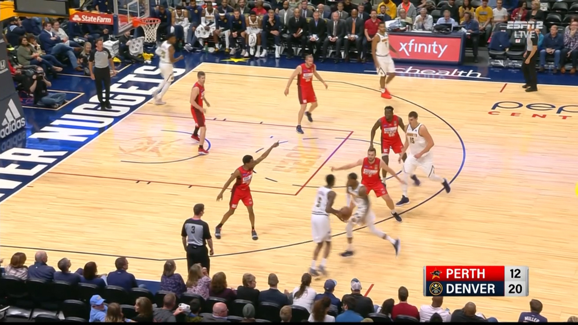

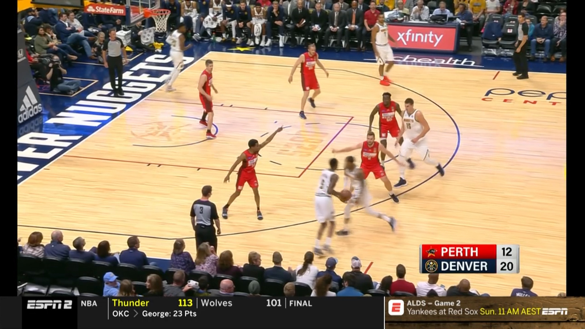

    Yes, it's capped from a cable box, and yes, it's broadcast pillarboxed. Presumably this is an ESPN Australia thing. On replays, they add that ticker to the bottom, and pillarbox it so as to avoid obscuring whatever graphics need to be seen at the bottom of the screen. Live broadcasts omit the ticker.
    Live broadcast:
    Replay:
  15. Then you should be OK, except that live image has about 10 lines missing at the bottom or it was broadcasted like that. Or you just made up that image?

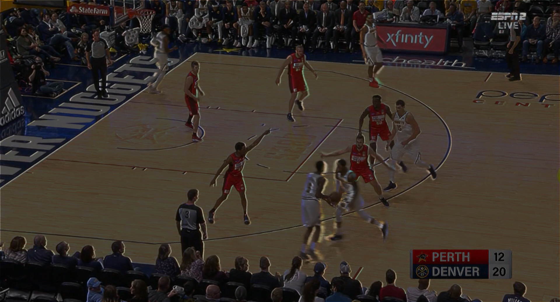

    Here is result. Original bottom layer and resized relay on top substracted. Logo is exact i think, yes there is bit shift, but i think it is very small and whole layer can be centered also it is affected by progresive and interlaced content.
    If i were you i would play with it bit more.
    [Attachment 46935 - Click to enlarge]

  20. Yeah, obviously they zoom out a bit when adding the stuff at the bottom, while also cropping a little from the height, but it still results in black bars down each side. The aspect ratio looks fine.
    In Avisynth-speak, and keeping the cropping mod4, I worked it out to be
    crop(88, 0, -88, -100)
    Spline36Resize(1920,1080)
    That leaves a few rows of black at the bottom, similar to the "live" screenshot. To remove the black at the bottom completely
    crop(96, 0, -96, -108)
    Which is exactly what jagabo suggested yesterday. Maybe he was overshadowed by the bad assumption that followed.

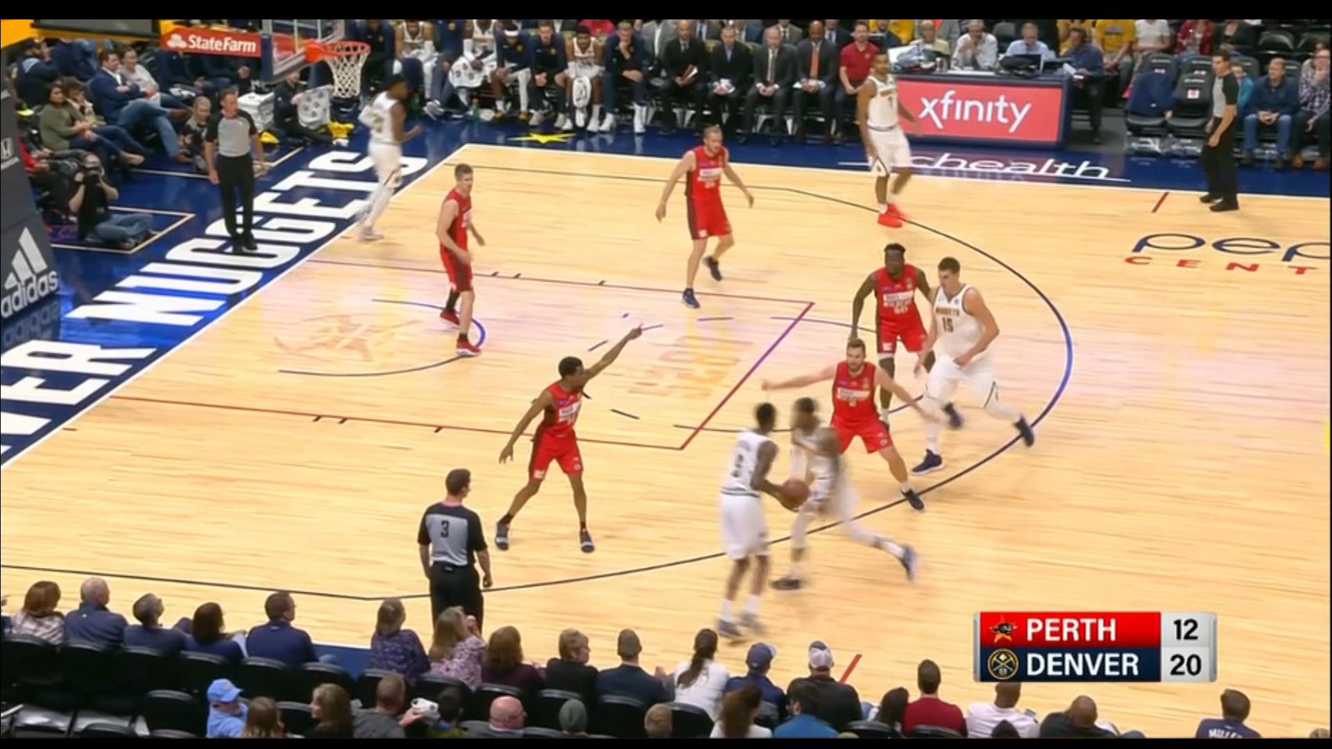

  23. It's a zoom out and crop top/bottom. You can't restore the full original 16:9 picture. If you want a 16:9 frame without distortion you have to crop some of the picture at the left/right, or leave some black borders top/bottom.
    letterboxed (picture registered with the original broadcast for A/B flipping, not centered):
    [Attachment 46939 - Click to enlarge]
    zoomed:
    [Attachment 46940 - Click to enlarge]

  26. I did the math, the cropping and resizing are correct. A/B flip between koberulz's live broadcast image and my letterboxed image. You'll see they are the same within a pixel or so -- aside from the black borders (and the fact that they aren't the exact same frame).
