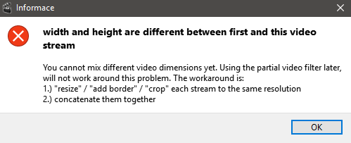

  8. Member Bernix's Avatar
    Apr 2016
    Europe
    Just curious what happened with two different sizes of videos. Here is the expecting result.
    [Attachment 46905 - Click to enlarge]
    So user must be blind to miss this
    Bernix

  10. Member Bernix's Avatar
    Apr 2016
    Europe
    O.k. this version isn't already night build. Actually it says 2018, but don't remember when change it. So probably some (but solid night build at the end)
    And yes, you are absolutelly right. When it works, do not update, should be paraphrase of your smart statement.
    + there is after this message another message, that appending was unsucceful.
    Bernix
