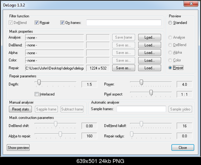

  2. Attached is a short video made from your sample image in post #1 and a BMP image suitable for the VirtualDub Delogo 1.3.2 filter by Karel Suhajda. My image in post #16 was made with these. Here's the delogo dialog with the BMP image loaded:
    Also included is a batch file that uses ffplay to play the video with its delogo filter. You'll need to change the path to ffplay.exe. Then just drag/drop the video onto the batch file to play it.

  4. The BMP file I provided was specifically for the video that came with it, not some other video that's of unknown frame size. I believe that's the reason you can't enable the repair option -- your video and the BMP image need to have the same dimensions. I don't know the dimensions of your source video since you've only provided a few cropped/scaled images. The point of sending a matching pair was so you could see a working example.

  5. What is the resolution of your video?? Your repair image is 1920x800. That looks like it is only one field from the frame. This is why I disagree with the advice to copy/paste the frame because some copy operations only end up working on one field (as one example, if you use any version of Vegas, and set the preview resolution to anything other than "Best," you only get half-sized videos when you copy). If your video is 1920x1080 (the typical HD video format) and you try to repair with an image that is 1920x800, and if your logos are at the bottom, then that repair mask will be completely misaligned. You can test this theory by looking halfway down the video, in the Delogo preview window, and see if you notice some fuzzing where the logos would be if there were halfway up the screen from the bottom.
    The right way to do this -- and it is so trivial to do that there is absolutely no reason to do it any other way -- is exactly what I showed in the video: in Delogo, on the Analyze Frame line (the first line in that big group), you click on Save Frame. You save it as a bitmap (BMP) file and then open that file in Photoimpact. Proceed from there.
    Hi I must really apologies to you. I didnt realise that video.mkv was a test I tried that .bmp image included and yes its worked
    is there a way to make the blur more faded
    The right way to do this -- and it is so trivial to do that there is absolutely no reason to do it any other way -- is exactly what I showed in the video: in Delogo, on the Analyze Frame line (the first line in that big group), you click on Save Frame. You same it as a bitmap (BMP) file and then open that file in Photoimpact. Proceed from there.
    Ok yes you are right the video is 1920x800
    and I have exported this image from movie in VD
    made a red box over subs
    opened VD opened video which is 1920x800
    added delogo and said load the image above. but when I looked at preview the subtitles are still there. mind you maybe its because I have not yet saved as avi

  8. Originally Posted by loa909 View Post
    Your red box isn't perfectly red. It has RGB values of 248,20,20, not 255,0,0. It's also a PNG file, not a BMP file. But that may be imgur's conversion. Try this BMP image:

  11. Yes, I said both in my tutorial, and then again here in this thread, that the red MUST be pure RGB red: 256,0,0. If it isn't, the mask won't work at all.
    As for adjusting the blur, I also covered that in my tutorial (not to be snarky, but did you look at it more than once?). At approximately the 1:10 mark in that video I say, "You an adjust the depth, power, and pixel aspect ratio" to make the repair look better. These controls will adjust various aspects of the blur, just like you asked. Also, as I said in the tutorial, make sure to click the "Interlaced" check box, if your video is interlaced.

  15. Originally Posted by loa909 View Post
    all i need to know now is where to have these 3 sliders
    Why don't you just press Show Preview, move the sliders around, and see what they do?

  17. Member loa909's Avatar
    Mar 2007
    Well when I say show preview. and try to move sliders it says not responding, so VD freeze up cant do anything. I was just asking as if I move sliders before i say preview they will then move, but was just asking so i can then set them up

  19. Originally Posted by loa909 View Post
    It's slow (depending on the speed of your computer and how big an area is being processed) so just wait.
  20. The place where the logos used to be will be replaced with a blur of the adjacent pixels. You are not going to have some magic where the logo is erased and then replaced with some perfect clone of the adjacent area. What you show is exactly what I'd expect to see.
  21. Originally Posted by Bernix View Post
    And power as small as white from subs are not visible.
    The subs will never be visible because the filter uses inpainting, not blurring.
    The only way to get less blurring is to use a more form fitting mask. But that's not really practical with subtitles over an entire video. You'd have to make a different mask for every subtitle.
