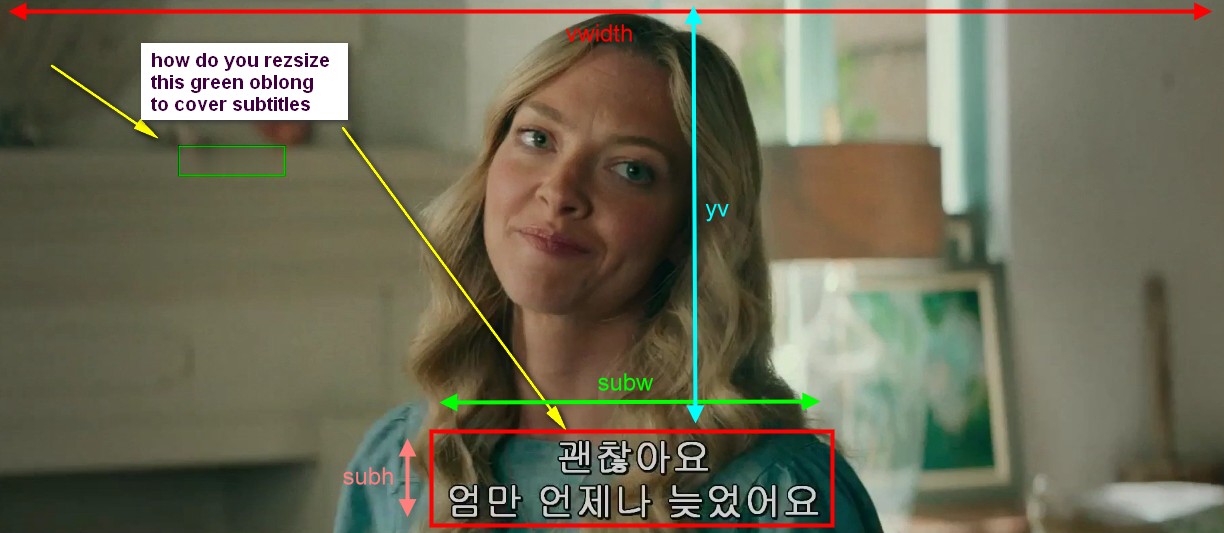

    I dont know if you are around pandy as you did these scripts for me below to blur logos. but how do i move the green oblong to cover logo
    I dont know which is best script to use
      @setlocal
    @set ffply= "C:\ffmpeg-3.4-win64-static\bin\ffplay.exe"
    @set filename=%1
    @rem video width
    @set vwidth=720
    @rem subtitle area width
    @set subw=160
    @rem delogo filter is centered on video
    @set xv=(%vwidth%-%subw%)/2
    @set yv=217
    @set subh=47
    @%ffply% -report -hide_banner -v 32 -stats -i %filename% -an -vf "delogo=x=%xv%:y=%yv%:w=%subw%:h=%subh%:show=1"
    @endlocal
    @pause
      @setlocal
    @set filename=%1
    @rem video width
    @set vwidth=720
    @set subw=160
    @rem subtitle area height
    @set subh=47
    @rem vertical position for delogo filter window
    @set yv=217
    @echo "delogo=x=%xv%:y=%yv%:w=%subw%:h=%subh%"
    @echo copy above line to ffmpeg
    @echo .........................................................................
    @endlocal
    @pause

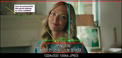

  6. Here's some hints for the second script:
    Change one value at a time to see what effect it has on the video.
    There are four numbers that you need to change in the batch file:
    vwidth=720
    subw=160
    subh=47
    yv=217
    The comments in the batch file describe what those values represent.
    For example: vwidth is the full width of the video. The image you posted is 1224 pixels wide. I don't know if that is really the width of the video but try changing that value to 1224. What happens when you play the video?
  7. Member loa909's Avatar
    Mar 2007
    vwidth=720
    subw=160
    subh=47
    yv=217
    I tried 1224 it seemed to move it to right a bit. also I have now tried different numbers to get the green oblong box to cover over subtitle. tried now 15 times just cant get it right. is there a easy way of making the green box cover all subs in a movie.

  9. Originally Posted by loa909 View Post
    Some video editors show coordinates in their UI. If yours doesn't, export a frame of your video from a player or editor. Load the frame in an image editor. Then use the tools there to determine the values to use. Assuming the black bar at the top of your sample image isn't part of the video frame:

    [Attachment 46858 - Click to enlarge]
    Thanks for the info on what each line means. I have made note of that. what part of script. changes how much or less blur the subtitles get

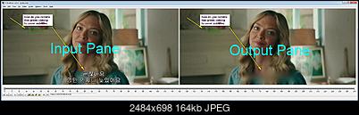

  13. Seem inserting picture works on forum but not on PM.
    [Attachment 46865 - Click to enlarge]
    With help of the https://www.videohelp.com/software/VirtualDub2 and filter crop subtitle area can be "measured" (efficiently crop video to make visible only subtitle area) and manually place on ffmpeg script.
    Perhaps also delogo filter in virtualdub2 may work alternatively to ffmpeg filter (i assume it may be easier to use GUI with some interactivity instead numerical coordinates). FFmpeg is one of my favourite tools but other tools may be simply better.

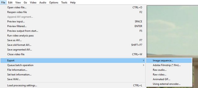

  16. You have to export an BMP image from VirtualDub, use a paint program to paint red over the logo, then import that new image into the delogo filter.

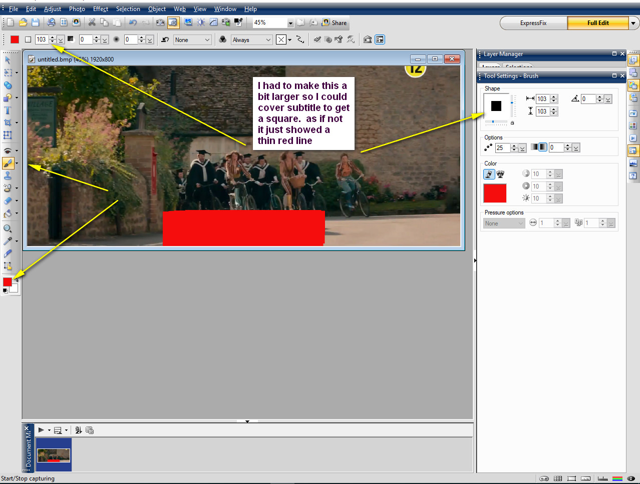

    I have selected paint brush in photoimpact also changed to red
    That's what I quoted earlier. Also have turned off feathering etc
    But when I try to paint on image. Nothing happens. Meaning red colour is not painting over image.
    Also I'm sorry if I annoyed you. REF: PM. I only did that as didn't think you would see my replies in forum.

  18. Photoimpact has a layers dialog, similar to Photoshop. You should only be using a single layer for this, but if somehow you have put your image on another layer, and that layer is not selected, nothing will happen. Right click on the image and select "Merge All," if it is not grayed out.
    You may also have somehow saved the image from VirtualDub with the wrong number of colors. Select Image Properties in the File menu, or press Alt-Enter in order to see the image properties. It should show "Data Type: RGB True Color (24-bit)." If it doesn't, go to the Adjust menu and select "Convert Data Type."
    As stated above, the image should be saved as a BMP file.
    Finally, double-check that you have actually selected "Paintbrush." The tools menu have icons that let you select a large number of tools. These are accessed with the little down arrow on the icon. Once you have selected the Paintbrush tool, you should see the icon in the attached screenshot, and when you hover the mouse over that icon, it should say "Paintbrush."
    Go back to my tutorial and use the YouTube pause button so you can inspect the Photoimpact settings more closely. Everything is shown in that tutorial.
    If you can't get this to work, perhaps you should go back to AVISynth.

  21. Member Bernix's Avatar
    Apr 2016
    Europe
    Hi,
    it is under File/export/single image. Suggesting export with png or bmp. And delogo expecting support alphachannel so in delogo import PNG. But for your purpose probably whole rectangle has to be red, so no need for alpha channel. Alpha channel is good for holes in logo and BMP doesn't support it.
    Also supposing you will use load under mask properties. You will know if you do it right in preview immediately (supposing)
    Bernix

    I dont have export/single image in VD. it says this as when I say ok. it starts to make loads of bmp images on my desktop. like video frames
  23. Member Bernix's Avatar
    Apr 2016
    Europe
    Hi,
    o.k. was in VD2. So choose small segment few frames, or if you are able to choose just one. So run this and it will export just selection. At least should, and Iam conviced it will.
    Bernix

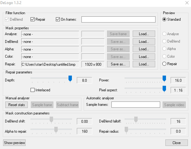

    Ok a question for john meyer. I have done exactly as you said in your video
    Then I open VD open video, add filter delogo v1.3.2 clicked on load where it says repair. but I dont get any subtitles being removed

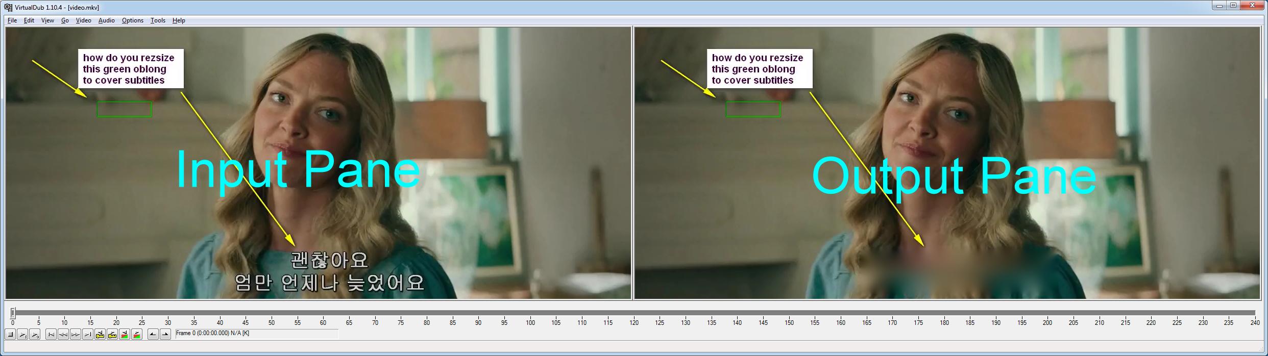

  26. You're probably not looking at the output pane in VirtualDub:
    Use View -> Swap Input/Output Panes to swap their locations.
  27. Member loa909's Avatar
    Mar 2007
    [Attachment 46880 - Click to enlarge]
    Yes tried output too, but subtitles are still there. not blurred at all so thats it I give up now
    thanks all for your help. but its just getting me down now, as something must be wrong all I want to do is blur out subtitles. I find pandys scripts ok. but need to know how to adjust the blur. as i have seen some videos which had subs blurred, and it looked great. but mine dont
  28. Originally Posted by loa909 View Post
    Is some other part of the picture blurred?
  29. Member Bernix's Avatar
    Apr 2016
    Europe
    Probably repair is wrong... Have you tried to load it for example to some different. Also you have loaded in repair, but repair is set to 0.0. Try set higher value probably. Used to use delogo long time ago and has no problems. Also you have not selected repair, ticket it

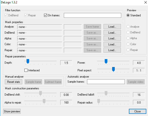

    I dont understand what you mean by
    also I have tried ticking repair, and you say
    I cant as its ghosted out stuck on 0.0
