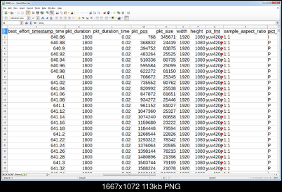

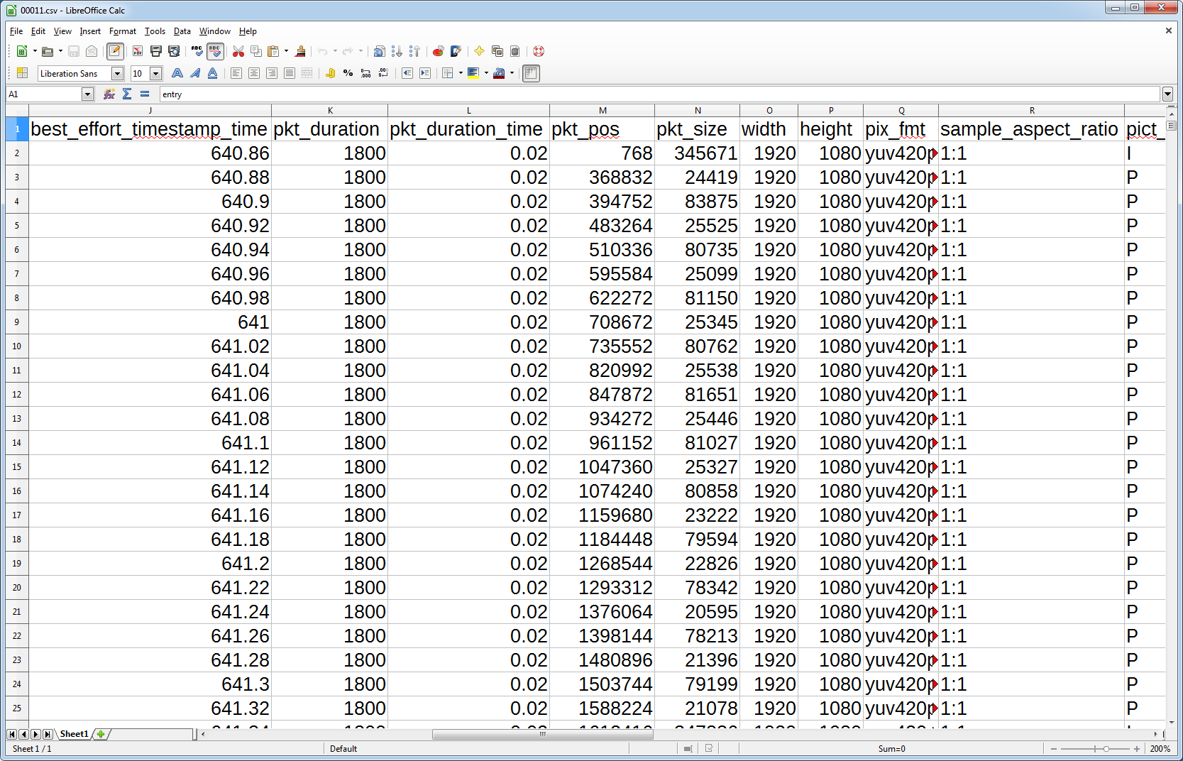

  8. Pandy posted an ffprobe batch file that displays information about every frame of the video:
    https://forum.videohelp.com/threads/390460-Ffmpeg-print-video-file-fps-every-sec#post2530898
    The program shows all frames are 1920x1080, SAR 1:1, with a duration of 1800/90000 seconds (20 ms, 1/50 second).
    ffprobe's csv file imported into a spreadsheet:
    I don't see VLC changing the video frame size during playback, but if you have played the video before it asks if you want to start where you left off last time. This is done by inserting a ribbon between the menu bar and the video window. If you're looking at the bottom of the frame it looks like the frame is shrinking when that ribbon goes away (after 5 seconds, even if you pause the playback) and the video frame shifts up. This might explain a pause/jump on some computers when it plays the video.

  16. If you look at the ffprobe results you'll see that the timestamps start at 640.86 seconds. Maybe that has something to do with it. What if you append all the segments that make up the one video? Does the whole thing play smoothly?
  17. I'm really sorry jagabo but i'm not entirely sure I understand about the timestamp. Could you explain a little more what this means? When you say append all the segments, do you mean create a single video with them? Sorry to seem thick, i'm no expert with all this stuff
