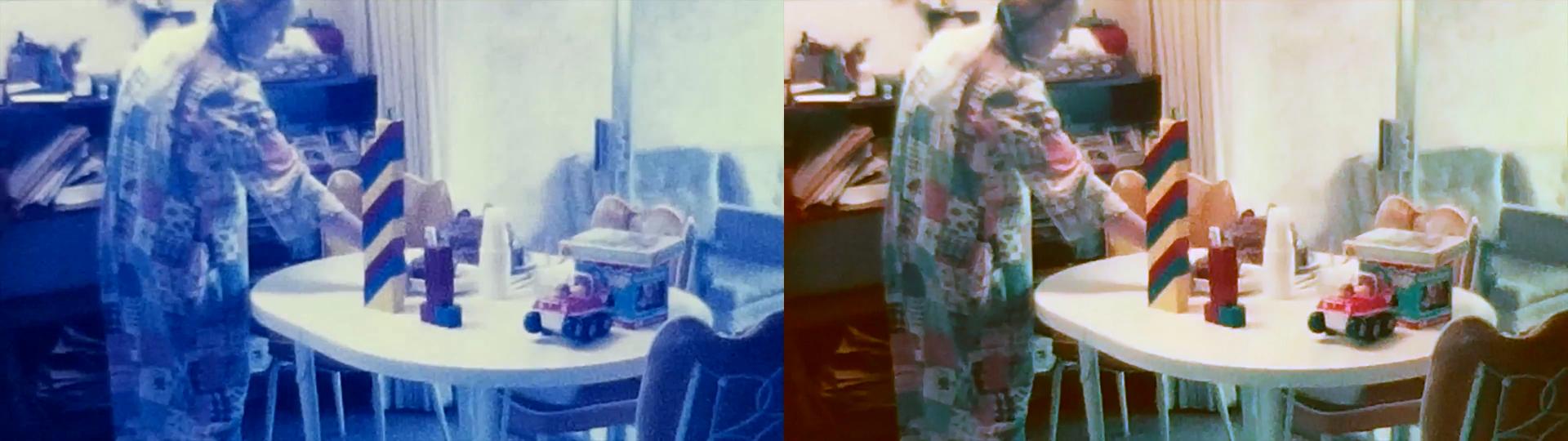

    For the OP: Even with the youtube video one can bring out some color. Here's a side by side comparison with some quick color adjustments. It needs a lot more work but it should give you an idea what can be done.
  12. That is a pretty ugly transfer.
    The most obvious thing is the blue cast. If you hold the film up to the light, or if you put it on a light table and look at it with a magnifier, does it actually have this blue cast? Many of these transfer systems must first be "white balanced" using a white card, or a similar operation. I ask this question because I've seen a lot of fading of various types of film stocks, and it is pretty unusual to have the blue layer be the only one that survives. Therefore, I suspect the blue may be from lack of calibration, rather than from the film itself, but you can prove me wrong if you can actually look at that section of film with a loupe.
    So, the first thing is to determine if your film really looks like this.
    Second, the playback speed is obviously wrong because it is playing too fast. Most transfer units have you specify the playback speed before you start capturing. While there are no hard and fast rules for 8mm film, you should start by telling your equipment to create the MP4 file to play at 16 fps. If you are transferring Super 8, the playback is always 18 fps.
    There are other issues, but these two are so overwhelming and must be fixed before you start refining your technique, that I didn't go any further than that.
