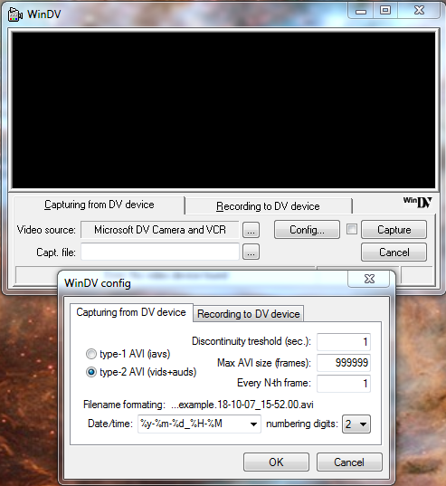

    you may have to go tapeless and leave the tape door open for the cam to stay on allowing you to record over the firewire to the computer's hard drive in dv format as long as you have space available there, it's 13GB/hr.
  5. aBigMeanie aedipuss's Avatar
    Oct 2005
    666th portal
    iirc you can initiate recording using the control panel of windv without touching the cam. if the cam is on and detected by windv you should be able to just click it's capture button. make sure to set the options in windv something like this to maximize the time it will run.
    [Attachment 46848 - Click to enlarge]
