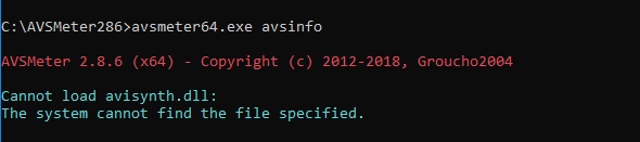

If I run AVSmeter64 this is what I get:
[Attachment 46847 - Click to enlarge]
However if I do the 32 version of the command I get a whole bunch of info:
Code:C:\AVSMeter286>avsmeter64.exe avsinfo AVSMeter 2.8.6 (x64) - Copyright (c) 2012-2018, Groucho2004 Cannot load avisynth.dll: The system cannot find the file specified. C:\AVSMeter286>avsmeter.exe avsinfo AVSMeter 2.8.6 (x86) - Copyright (c) 2012-2018, Groucho2004 VersionString: AviSynth 2.60, build:Mar 31 2015 [16:38:54] VersionNumber: 2.60 File / Product version: 2.6.0.6 / 2.6.0.6 Interface Version: 5 Multi-threading support: No Avisynth.dll location: C:\Windows\SysWOW64\avisynth.dll Avisynth.dll time stamp: 2015-03-31, 06:40:58 (UTC) PluginDir2_5 (HKLM, x86): C:\Program Files (x86)\AviSynth\plugins [C 2.5 Plugins (32 Bit)] C:\Program Files (x86)\AviSynth\plugins\yadif.dll [1.7.0.0] [CPP 2.5 Plugins (32 Bit)] C:\Program Files (x86)\AviSynth\plugins\ChromaShift.dll [2018-10-05] C:\Program Files (x86)\AviSynth\plugins\EEDI2.dll [0.9.2.0] C:\Program Files (x86)\AviSynth\plugins\nnedi.dll [1.3.0.0] C:\Program Files (x86)\AviSynth\plugins\nnedi2.dll [1.6.0.0] C:\Program Files (x86)\AviSynth\plugins\SSE2Tools.dll [2018-10-07] [CPP 2.6 Plugins (32 Bit)] C:\Program Files (x86)\AviSynth\plugins\AddGrainC.dll [1.5.2.0] C:\Program Files (x86)\AviSynth\plugins\DePan.dll [2.13.1.3] C:\Program Files (x86)\AviSynth\plugins\DePanEstimate.dll [2.10.0.2] C:\Program Files (x86)\AviSynth\plugins\dfttest.dll [1.8.0.0] C:\Program Files (x86)\AviSynth\plugins\DirectShowSource.dll [2.6.0.3] C:\Program Files (x86)\AviSynth\plugins\eedi3.dll [0.9.1.0] C:\Program Files (x86)\AviSynth\plugins\FFT3DFilter.dll [2.1.1.0] C:\Program Files (x86)\AviSynth\plugins\KNLMeansCL.dll [2018-10-07] C:\Program Files (x86)\AviSynth\plugins\masktools2.dll [2.2.18.0] C:\Program Files (x86)\AviSynth\plugins\mt_masktools-26.dll [2.0.48.0] C:\Program Files (x86)\AviSynth\plugins\mvtools2.dll [2.5.11.2] C:\Program Files (x86)\AviSynth\plugins\nnedi3.dll [0.9.4.0] C:\Program Files (x86)\AviSynth\plugins\PlanarTools.dll [2018-10-07] C:\Program Files (x86)\AviSynth\plugins\RemoveGrainSSE2.dll [2018-10-07] C:\Program Files (x86)\AviSynth\plugins\RepairSSE2.dll [2018-10-07] C:\Program Files (x86)\AviSynth\plugins\RgTools.dll [0.97.0.0] C:\Program Files (x86)\AviSynth\plugins\TCPDeliver.dll [2.6.0.7] C:\Program Files (x86)\AviSynth\plugins\TDeint.dll [1.1.0.0] C:\Program Files (x86)\AviSynth\plugins\VerticalCleanerSSE2.dll [2018-10-07] C:\Program Files (x86)\AviSynth\plugins\yadifmod2.dll [2018-10-07] C:\Program Files (x86)\AviSynth\plugins\yadifmod2_avx2.dll [2018-10-07] [Scripts (AVSI)] C:\Program Files (x86)\AviSynth\plugins\AnimeIVTCmod_v2.20.avsi [2018-10-07] C:\Program Files (x86)\AviSynth\plugins\colors_rgb.avsi [2015-03-30] C:\Program Files (x86)\AviSynth\plugins\QTGMC.avsi [2018-10-07] C:\Program Files (x86)\AviSynth\plugins\smdegrain.avsi [2018-10-07] [Uncategorized DLLs (32 Bit)] C:\Program Files (x86)\AviSynth\plugins\libfftw3-3.dll [2018-10-07] C:\Program Files (x86)\AviSynth\plugins\libfftw3f-3.dll [2018-10-07] C:\Program Files (x86)\AviSynth\plugins\libfftw3l-3.dll [2018-10-07] [Uncategorized files] C:\Program Files (x86)\AviSynth\plugins\Where_to_put_these.txt [2018-10-07] [Plugin errors/warnings] _______________________________________________________________________________________________________________________________ Plugin C:\Program Files (x86)\AviSynth\plugins\yadif.dll is not an AviSynth 2.6 or 2.5 plugin. Note: C-Plugins must be loaded explicitly with "LoadCPlugin()" _______________________________________________________________________________________________________________________________ LoadPlugin: unable to load "C:\Program Files (x86)\AviSynth\plugins\SSE2Tools.dll", Module not found. Install missing library? Dependencies that could not be loaded: MSVCR71.dll _______________________________________________________________________________________________________________________________

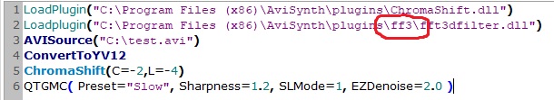

Finally I got this crap to work, I had two issues.
First the FF3DFILTER has a bunch of files not just the DLL file so I created a folder under plugins just for FF3DFILTER and dumped all the files in there. I modified the cript to reflect the change:
[Attachment 46851 - Click to enlarge]
