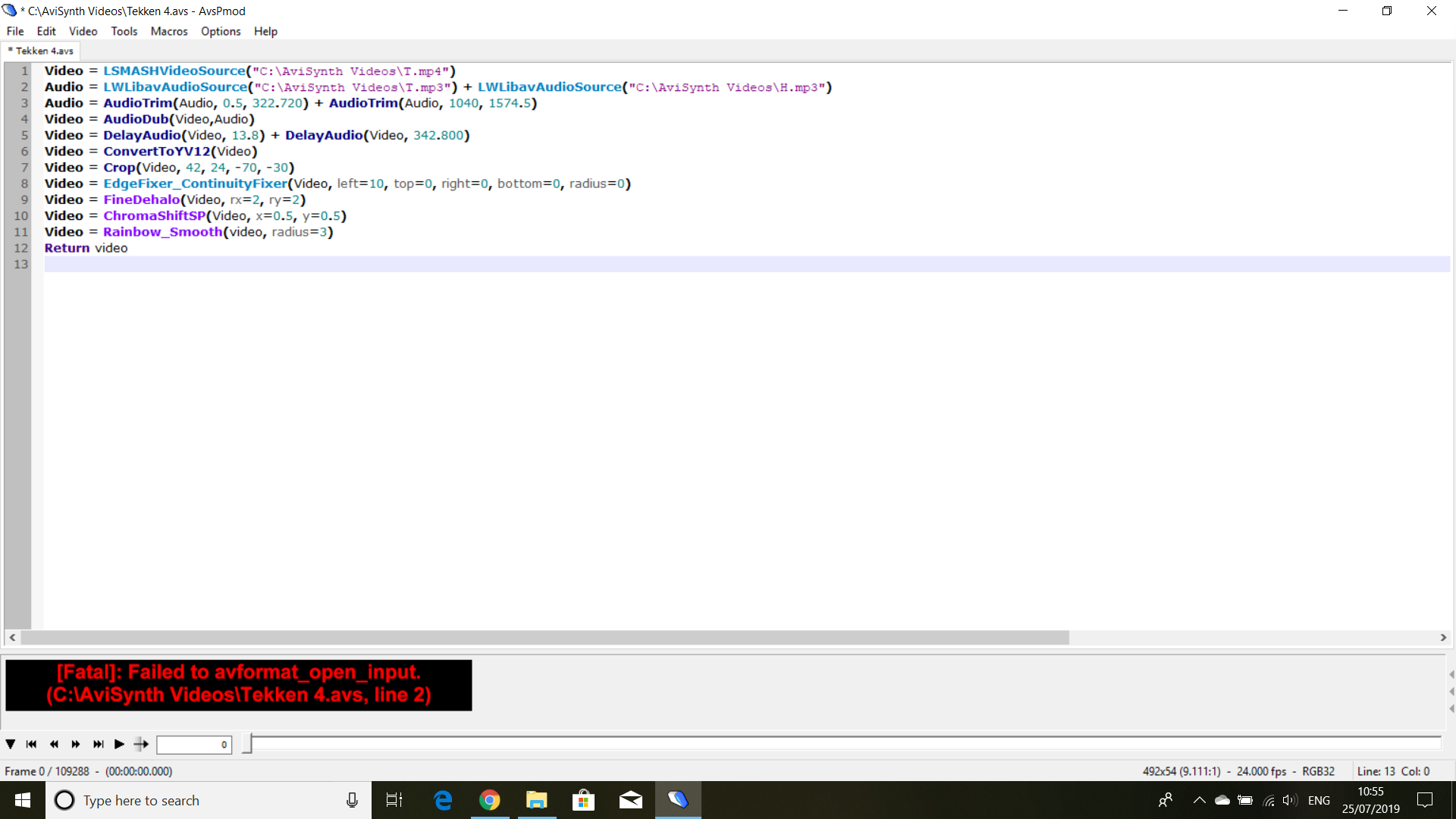

Hello, I've figured out how to trim and attach audio together. Now I know that I need to use delayaudio in order to place audio at wanted video time. But the problem is that the second audio starts right after the first audio which is not what I want. I also want second trimmed audio to start at specific video time that I've specified. In the screenshot I've attached you can see I've added delay audio command for the first and second trimmed videos. I've set 13.8 seconds delayed for the first trimmed video and 342.8 seconds delayed for the second one. The first one works as I expected, but the second one doesn't. Can anyone correct me? Thanks.
[Attachment 49654 - Click to enlarge]
