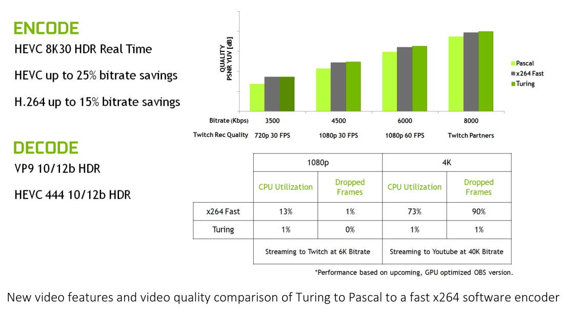

    Nvidia said Turing (RTX 20xx) has up to 25% HEVC and up to 15% AVC bitrate encoding improvement. Nvidia themselves are comparing it to x264 preset fast (though they don't explicitly say whether "it" is HEVC or AVC. I guess "streaming to Twitch/Youtube" implies AVC?).
    [Attachment 46919 - Click to enlarge]
    https://www.nvidia.com/content/dam/en-zz/Solutions/design-visualization/technologies/t...Whitepaper.pdf
  12. If you think about the claims, if they are true, then, at least for me, it effectively ends the debate about software vs hardware encoders. Taken one by one:
    Encode HEVC 8K30 HDR in real time - Anyone that has even tried to do 4K HDR knows how slow it is, if these RTX based cards can really encode 8K30 HDR HEVC in real time I think they will effectively kill the market for software based encoding.
    HEVC up to 25% bit rate savings and up to 15% bit rate savings for H264, both compared to x264 fast. This claim is very interesting, saying that the new NVENC found on RTX cards offers that much bit rate savings is the same as saying that at the same bit rate as x264+fast that RTX's NVENC HEVC offers up to 25% better quality and their AVC encoder offers up to 15% better quality, which means NVENC HEVC may come close to x264+slow and NVENC AVC may come close to x264+medium.
    While I realize that these results will be very much source dependent, I do know that the developer's of Davinci Resolve have said there software will make use of the RTX's Tensor Cores to improve quality and performance and it's been rumored that Adobe Premiere will also make use of the new features.
    If NVIDIA stick true to form the reasonably priced RTX2050 and RTX2060 models (I'm assuming that's what they will be called) should be out early next year, and I will end up buying the GTX1050 equivalent. This time though I will buy a 4GB model, not the 2GB model, I was doing a test encode using the Meridian sample that NetFlix created to be used for codec testing and after applying a couple of gpu accelerated filters and using NVENC HEVC through ShotCut, I found that I was 7.7GB out of 8GB system ram (I also had a bunch of Firefox tabs open), 5GB of swap and with the exception of 48MB of vram, the entire video card's ram was being used up.
    Luckily Ubuntu is not Windows and I could still use the system without it locking up or freezing and was able to shut down Firefox and free up some system ram (though it was still about 5.5GB used), but I will definitely spring for the larger buffer this time around.
  13. Originally Posted by sophisticles View Post
    I think the 25% and 15% respectively are meant in comparison to Pascal. But granted, the paper isn't all that explicit on that either.
  14. Originally Posted by sneaker View Post
    Rereading through the chart, I believe you are right, the chart does show Pascal losing to x264 fast which in turn is losing to Turing, so I think you are correct, the percentage improvement is relative to Pascal which makes it slightly better than x264 fast.
    Still, I think most users would be happy with x264 fast quality, which should be roughly equal to x265 ultrafast quality, if it means they can encode 1080p video at 300+ fps (I can hit that with a GTX1050 with the right ffmpeg settings) with z264 fast quality.

    Currently, NVIDIA is making use of both AI-based and non-AI-based algorithms for denoising,
    choosing whatever is best for a particular application. In the future we expect AI-based denoising
    to continue to improve and replace non-AI-based metho

    Another question I have: Why are all tests compared to x264 fast or very fast? With all the advancements in technology you'd think they would move up the ladder and target higher qualities like the Slow or Slower settings. For instance, Quick Sync, why not just build it so that it can, by default, produce a higher quality result (as compared to x264)? After all the iterations since Sandy Bridge, why not just improve it to a very high quality hardware? But then again, it's Intel. They've been monkeying around for years with their core counts until Threadripper comes along and well, puts and end to that.
    Certain encoding complexities do not lend themselves to parallelization on GPU . GPU is better at certain tasks than CPU, and vice versa . Why can't I play my video games at 120FPS+ at UHD with CPU ? Similar reasons.
    In fact, the tests where Intel MSS HEVC encoder (not quicksync), score better than x265 result because it's actually a primarily CPU based encoder, with some GPU acceleration on the side. As a result, the FPS is much slower than the consumer HEVC quicksync version
    The more parallelization , the more threads, the fewer redundancies can be used - and that is the bottom line basis for modern codec compression. Thus compression efficiency is negatively impacted. The absolute highest quality is always with 1 thread, but it's just not feasible in most situations (way too slow), and the difference is usually negligible for low thread counts, except for very low bitrate scenarios
    And now, the advancements are with new codecs, like AV1, which just wipe the floor with x264 and x265 but much slower. I'd love to see some GPU acceleration there
