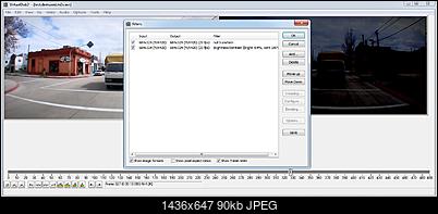

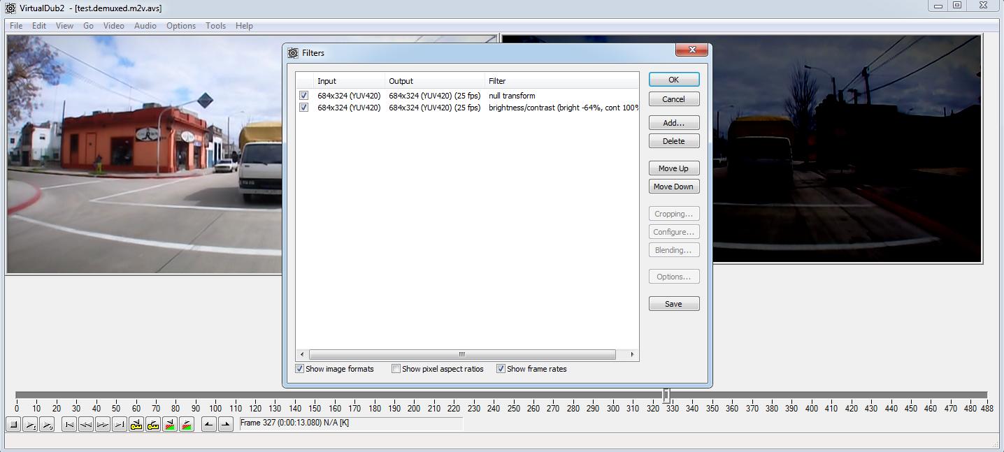

  15. Originally Posted by LMotlow View Post
    If you are viewing the output of an avs script in VirtualDub and using VDub's "full processing mode", the video output is converted by default to uncompressed RGB when you save the new AVI.
    That behavior changed several years ago. VirtualDub in full processing mode now only converts to RGB when actually filtering. And even then only if using a filter that doesn't support the incoming color format.
    If it receives YUY2 from an AviSynth script and you save as uncompressed you will get uncompressed YUY2 in the AVI file. If you select a compression codec that supports the YUY2 that's what the codec gets. It's the same for YV12.
