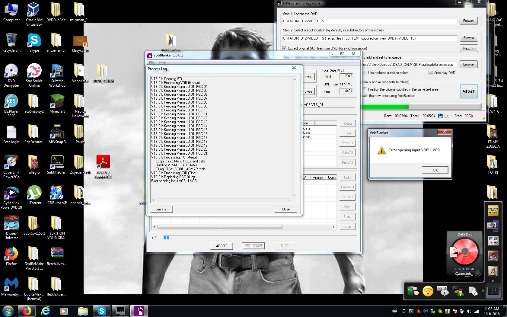

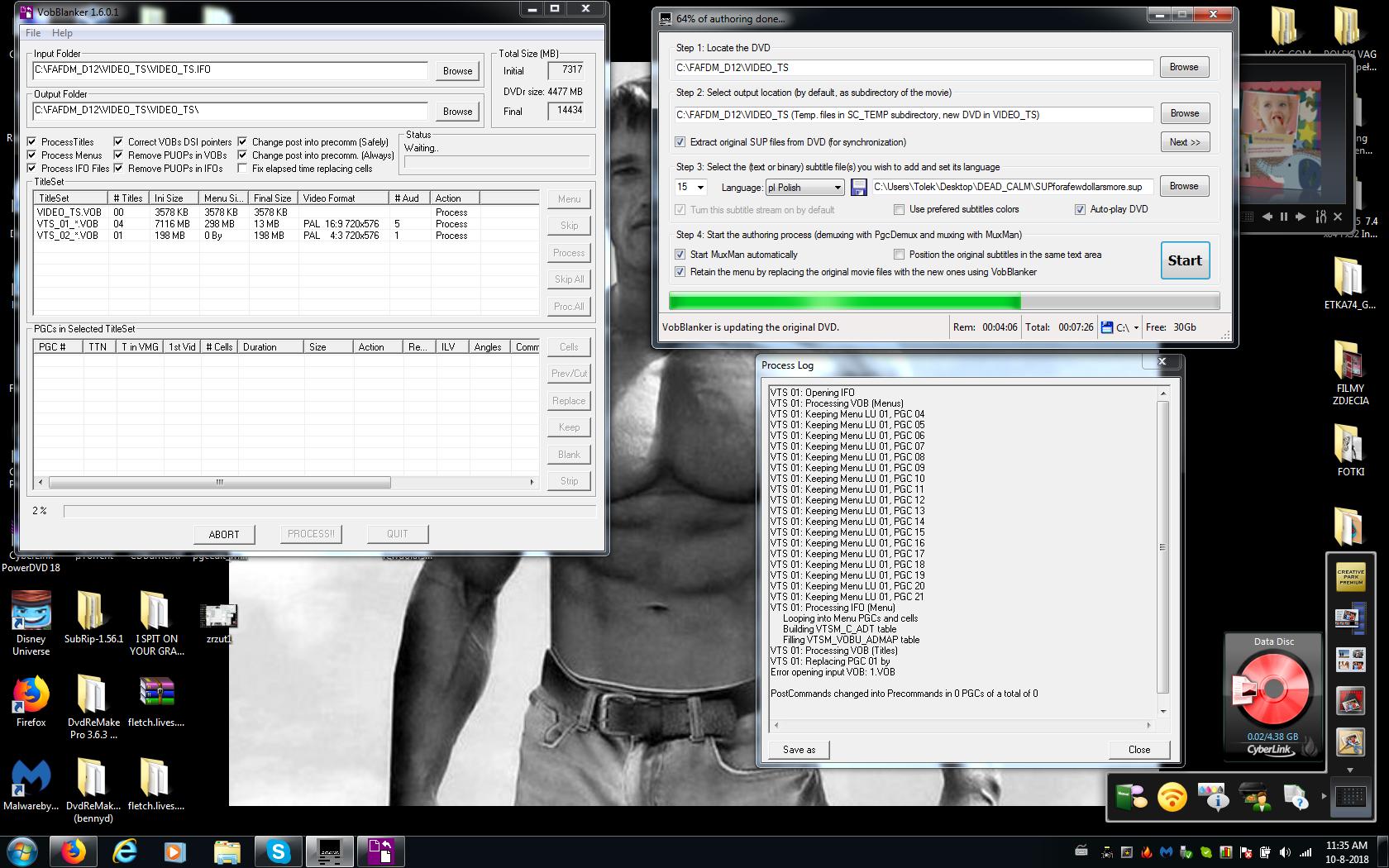

    While authoring dvd , Subtitle Creator works well with Pgc edit and Muxman, finally VobBlanker is enabled and error message open Vob is displayed. /error open Vob/ Why VobBlanker can not open the vob file, is it badly tied to the hard disk? Did you have such a case? It happens me not on every DVD movie.
    I could put subtitles without VobBlanker it work's fine ,but then I don't have menu in authored dvd, the movie switch on without menu with new subtitles but works fine,but I want orginally menu.
    VobBlanker opens IFOs. Did you decrypt the DVD to the hard drive correctly? How did you decrypt it? What program did you use? Show me a picture of the VobBlanker screen you see after opening the DVD.
  12. So this was made by someone and you got it from somewhere else (perhaps a download) and it's a burned and not a stamped retail DVD . So, all bets are off. My guess is that it's scratched. Or maybe the person that shrank the size didn't know what he was doing and messed it up.

    I bought this dvd in England. It's original DVD in box with cover and dvd has label. It is original for 100 %
  14. Okay then, sorry. It's either scratched or perhaps has advanced copy protection. Maybe try DVDFab to decrypt it. I have no idea why VobBlanker won't open it.
