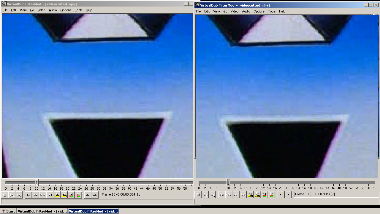

I encoded video (1.5mb mpeg-2) in H264 (it became 750kb), with help of the tuned x264, and after a detailed check of each pixel in different frames and scenes I saw that after compression in 2 times quality was not lost at all. Only places where it was lost are blocks. How to disable deblocking? What parameters are missing?
ffmpeg -i ivtced.yuv -aspect 640:480 -c:v libx264 -tune zerolatency -preset placebo -crf 16 -refs 4 -me_range 64 -bf 16 -trellis 1 -subq 9 -qcomp 0 -x264-params no-deblock videocutted.h264
Left window - original, right window - re-encoded
[Attachment 46754 - Click to enlarge]

Are you sure you want to disable deblocking completely , not just modulate the alpha/beta strength ?
Code:-x264opts no-deblock

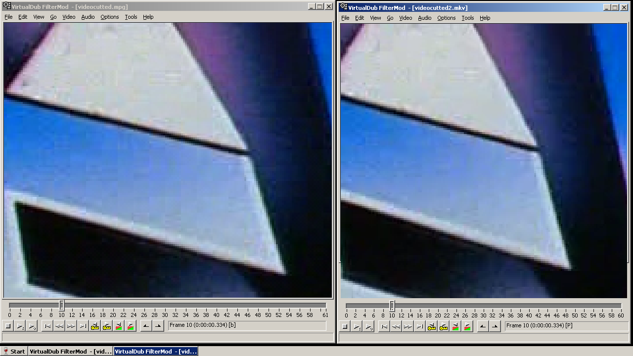

Thank you very much. That helped. However, this was not enough for me and I had to disable AQ, and set qp to 14 to achieve exactly same quality (size is less than original by 1% due to removal of noise on a black background). Now I have another question: how to disable denoiser (black)?
Command:
ffmpeg -i videocutted.mpg -aspect 640:480 -c:v libx264 -tune zerolatency -preset placebo -qp 14 -refs 4 -me_range 64 -bf 16 -trellis 1 -subq 9 -qcomp 0 -aq-mode 0 -x264opts no-deblock videocutted.h264
[Attachment 46755 - Click to enlarge] -
It's not "exactly" the same quality . Use a lower qp , higher bitrate or higher crf if you want it closer to the same quality . Of course filesize will increase . In the end, bitrate is the most important (lower qp's if that's what you're using)
To disproportionately distribute more bitrate to flat and darker areas, you actually need to use AQ (if using bitrate or crf rate control, it's disabled if you're using -qp) . qp with a qcomp of 0 tends to be less efficient, but I know you're trying to be close to visually lossless . In that case you can't get around using lower qp's . A fixed qp with qcomp 0 will be less efficient in general (you need larger filesize)
To retain fine noise on black backgrounds (or any fine noise) you usually have to reduce deadzone values , but at some ponit a low enough qp will also do it -
Parameters deadzone, deadzone-intra and deadzone-inter are not in ffmpeg. How else can I turn it off?
ffmpeg -i videocutted.mpg -aspect 640:480 -c:v libx264 -preset placebo -qp 15.5 -refs 16 -me_range 64 -bf 16 -trellis 0 -subq 10 -qcomp 0 -aq-mode 0 -x264opts no-deblock -x264-params no-dct-decimate=1 videocutted.h264 -
almost anything that isn't included in ffmpeg libx264 directly can usually be specified through -x264opts . You can include no-dct-decimate too instead of using both -x264opts and -x264-params . Separate switches are separated by a colon
default values for deadzone-inter and deadzone-intra are 21 and 11 respectively . Lower values will preserve more fine detail, but result in larger filesizes. Like everything , it's a tradeoff. If you look at the tune grain preset it's set to 6 and 6 .
