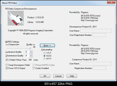

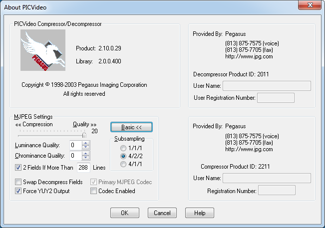

    Here's PicVideo's MJPEG configuration dialog with an interlaced setting:

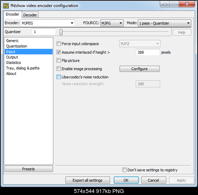

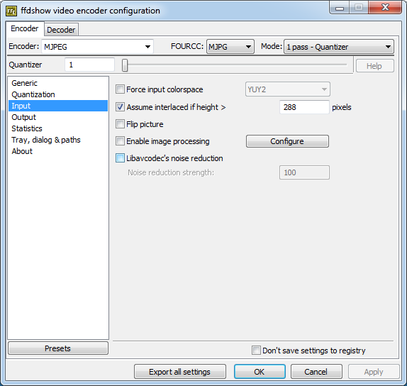

    ffdshow also has an interlaced setting:

    Once again - MJPG is not standardised - it is ad hoc implemented way to deal with video signal when JPG (or rather DCT) technology (mostly silicone) was available. Provided screen shots do not tell anything about how signal is processed internally - it can be processed as separate fields thus progressive frame with half of vertical resolution and doubled framerate, it can be only flag associated with content, it can be finally proper interlaced processing i.e. interlaced frame, alternate DCT scan type etc. This was my point from begining... MJPEG is suboptimal for interlaced as way how interlaced is processed is large grey (undefined) zone. MPEG-2 I frame is very similar to MJPG but there is clear specification how to deal with interlaced video.

    The OP isn't making MJPEG video, he already has MJPEG video and is looking at how to deal with it. I suspect his video is progressive. But he needs to verify it.
