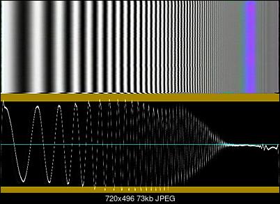

    The alternating black and white lines increase in frequency from left to right. As the frequency increases the contrast (amplitude) of the recorded signal decreases (the source signal had the same amplitude across nearly the entire frame). Where do you want say the limit is reached? One common way is to state where the signal is reduced to -3 dB (about 50 percent). Another common way uses -10 dB (10 percent). The latter gives a higher number.

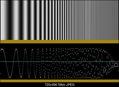

    As a reference, here's the same test pattern recorded directly from the DVD player's composite output (what was recorded by the VHS deck):
    As you can see, the amplitude of the pattern remains constant to much higher frequencies.

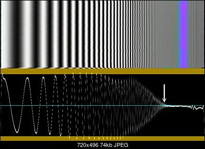

  17. If you want some analysis of the resolution of the VHS cap:
    If you take the distance from the peak below the arrow (I'm being pretty generous here) and the peak to the right of it you get 4 pixels. Since that's a transition from bright to dark then back to bright it's two lines. That makes one line 2 pixels. A 720 pixel wide frame divided by 2 gives you 360 lines of resolution across the entire frame (or 270 across a 3:3 portion of the 4:3 frame). I assume manufacturers would take their readings closer to 10 percent remaining amplitude because that gives better number than taking it a 50 percent. If you take the reading a few pixels to the left you get 5 pixels from peak to peak. That equates to 288 lines over the entire frame. So exactly where you take the measurement will make a significant difference.
