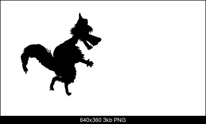

  4. I don't know anything about the software you're using. But most editors have the ability chroma key -- make certain colors transparent. You would then replace the transparent areas with the color you want via an overlay. An example:
    wolf on white background (already binarized to black/white):

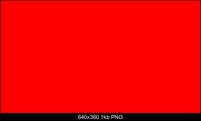

    a red image to use as the background color:

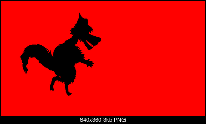

    Overlay the red image over the wolf image using the wolf image itself as a transparency mask (usually called an "alpha channel" or matte in video):
    In short, all the white pixels have been replaced with red pixels.

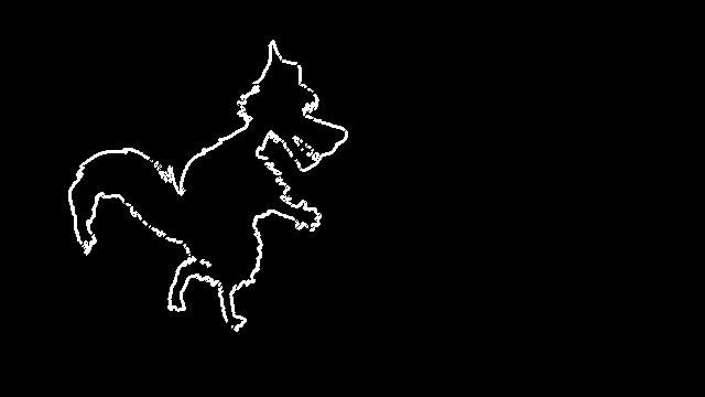

  10. It sounds like you may be using edge detection (ie, pixels whose intensity differs significantly from those around it are part of an edge) followed by the average brightness. For example, an edge mask built from the earlier wolf image:
    White represents edges, black not edges. Bigger objects and objects with more complex outlines will have more edge pixels and hence the edge images's average brightness will be higher.
    You might be able to streamline that by bypassing the binarization step. Edge detection will probably work on the original image too -- since you have dark objects on a bright background. In fact, you may not need edge detection at all. The objects themselves may be different enough in size that just the average brightness of the original (or binarized) frame will let you recognize single objects.
    Note that I'm using "average brightness" here but since the the pixels that make up the frame are (more or less) black or white and there is a fixed size frame the avarage brightness is a proxy for the number of white pixels, or the percentage of white pixels, etc.
