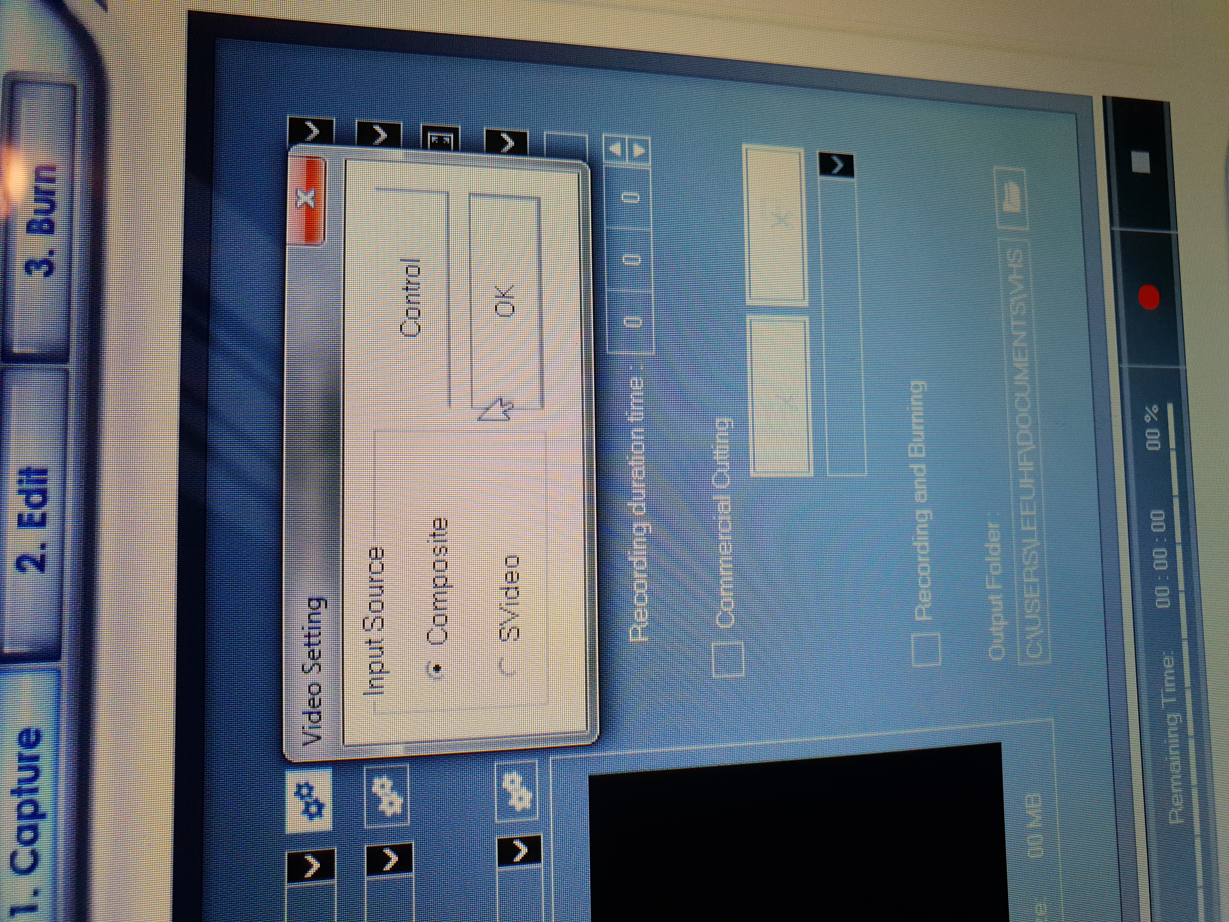

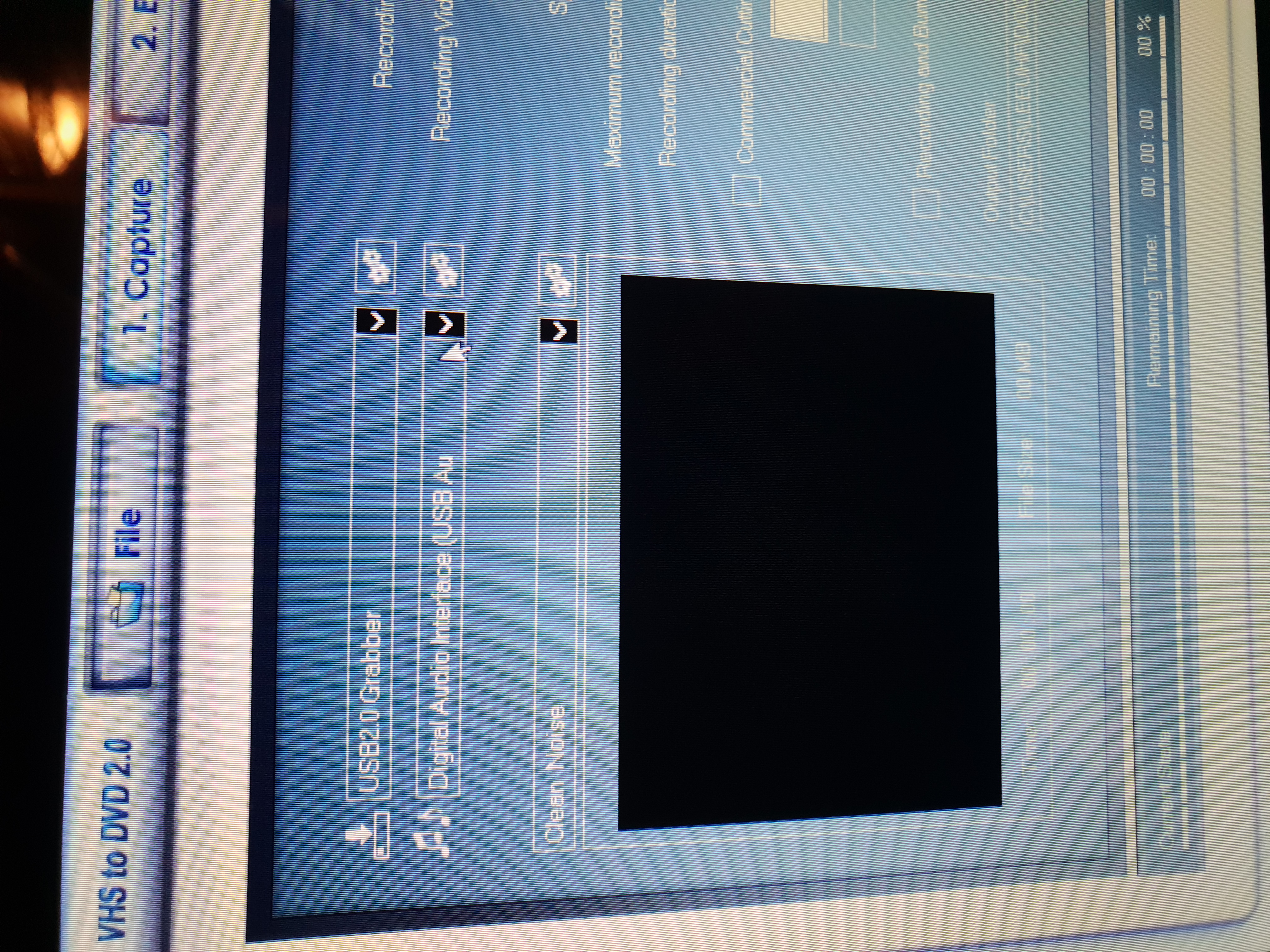

    Using VHS to DVD 2.0.
    I first installed the drivers from the disk then the software.
    Using the USB device provided I connected it via scart (the 3 phono leads not S-Video as it doesnt support that on the VHS player)

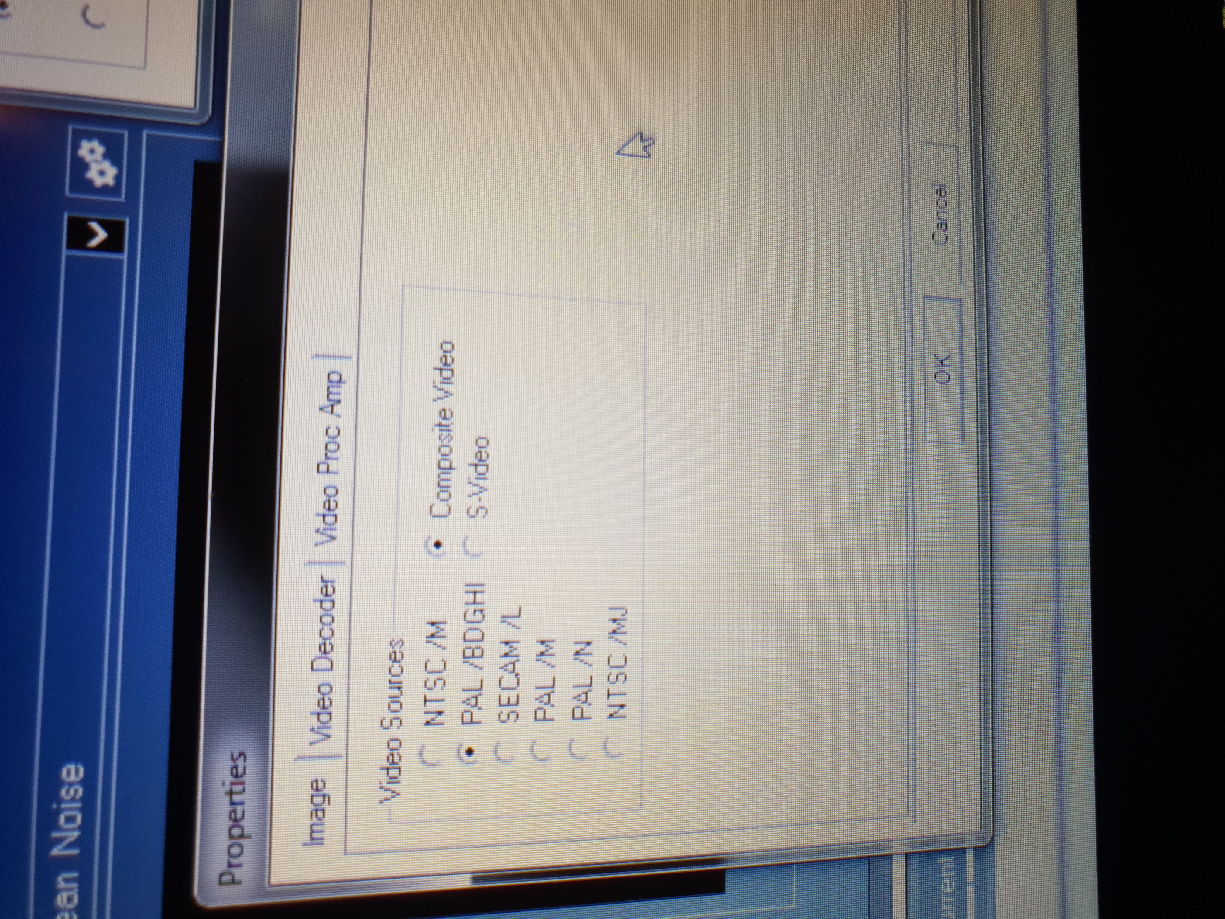

    Its set to USB2 grabber click in the settings to this
    Click Composite> Control
    Image set to PAL M
    Video DEcoder - Video Standard set to PAL_M

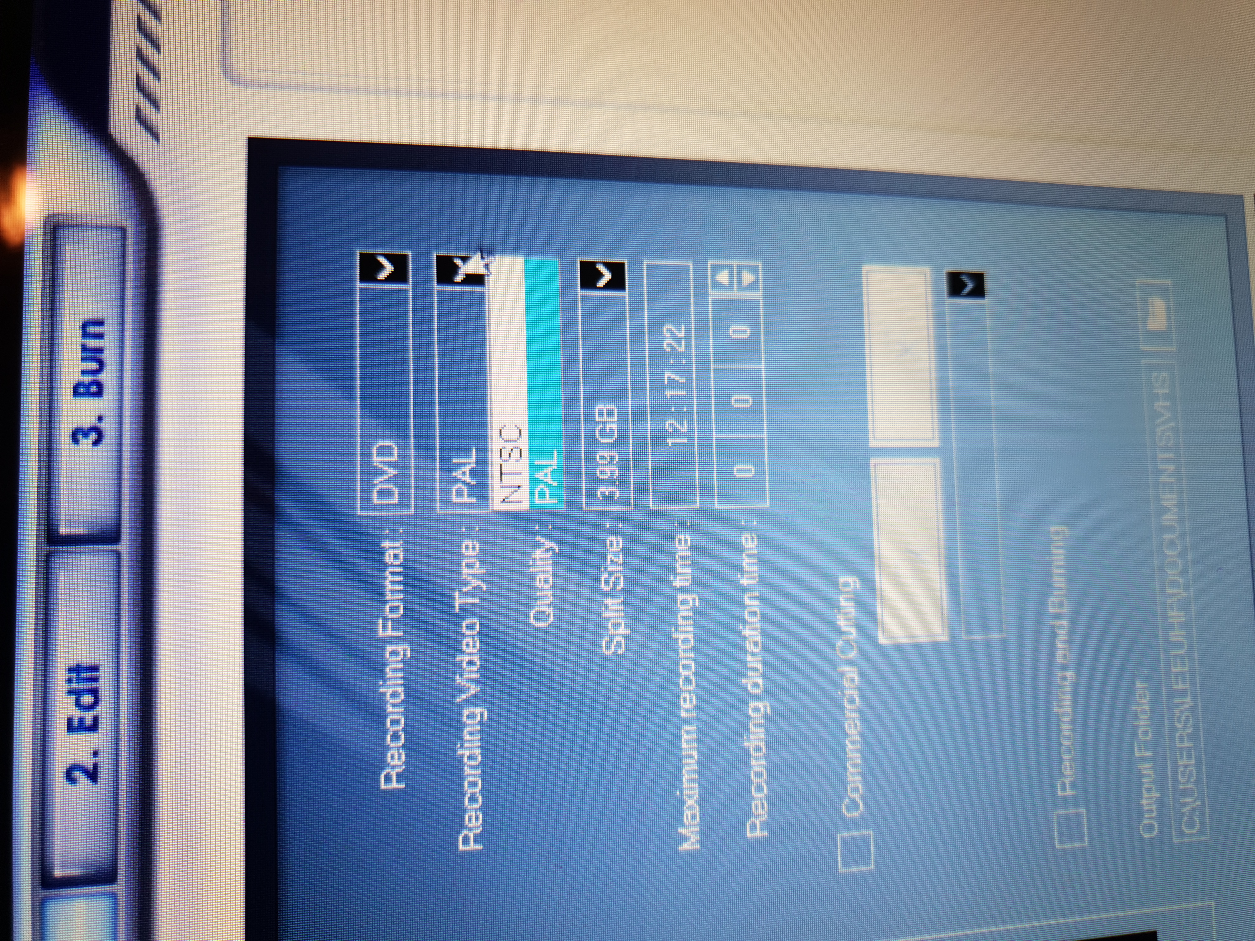

    Recording Format - VCD
    Recording Video Type- PAL
    Quality - Best
    Sokut suze 640mb

    Most capture software doesn't automatically select the correct video system used for input. You need to change the capture software's video system and Image settings from PAL M to PAL I since the VHS tape was recorded on UK equipment.

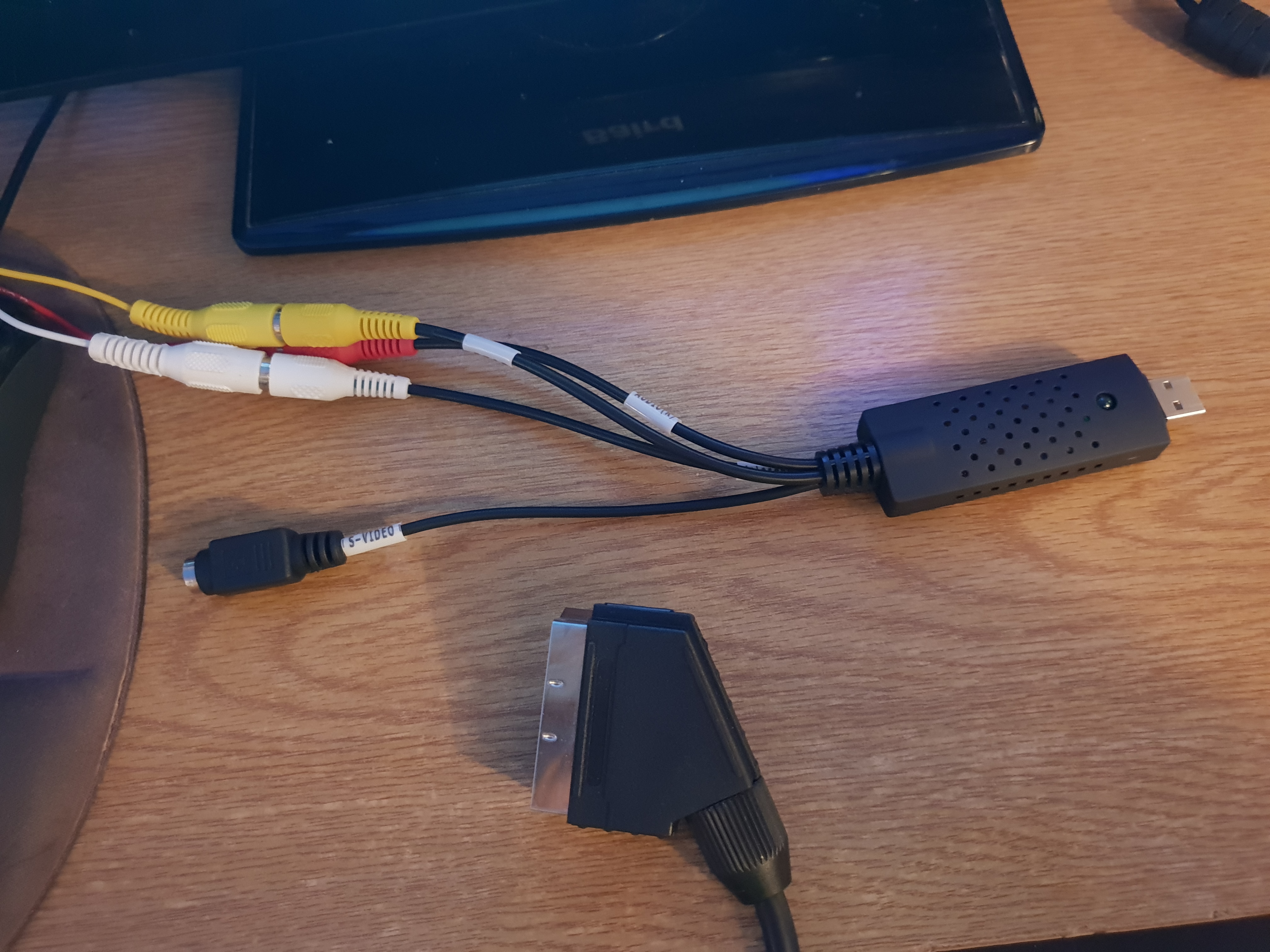

    One thing you really should check first is that the scart cable is in an output socket on the VCR and not an input. Easiest way is plug the yellow cable in to a tv or test with a scart to scart cable.
    The VCR manual will tell you whether you choose Line 1 or Line 2 when connected to a PC.
    Jul 2007
    +1 to DB83's post
    In addition, I just found out from another forum that some scart to composite cables are directional, either for input or output only.
  20. Member DB83's Avatar
    Jul 2007
    Yip. This is a possibility if the scart end is not fully wired.
    There are also these adapters which have scart on one end and composite sockets on the other. And they have a switch for either input or output.

    Originally Posted by leeuhf View Post
    USB > 3 colour female Phone > scart)
    It's traditional for the arrows to point in the direction the signal is flowing. Since your intent is to capture video from the VHS player with your device:
    VHS SCART > SCART adapter RCA > USB capture device
    This is important because some SCART adapters are for sending SCART to RCA, others from RCA to SCART. Some are bi-directional (but only one direction at a time). They will have a switch to control which way you want to use them:
    https://www.amazon.com/Adapter-Switched-Recorder-Television-Projector/dp/B00S69TW0G/

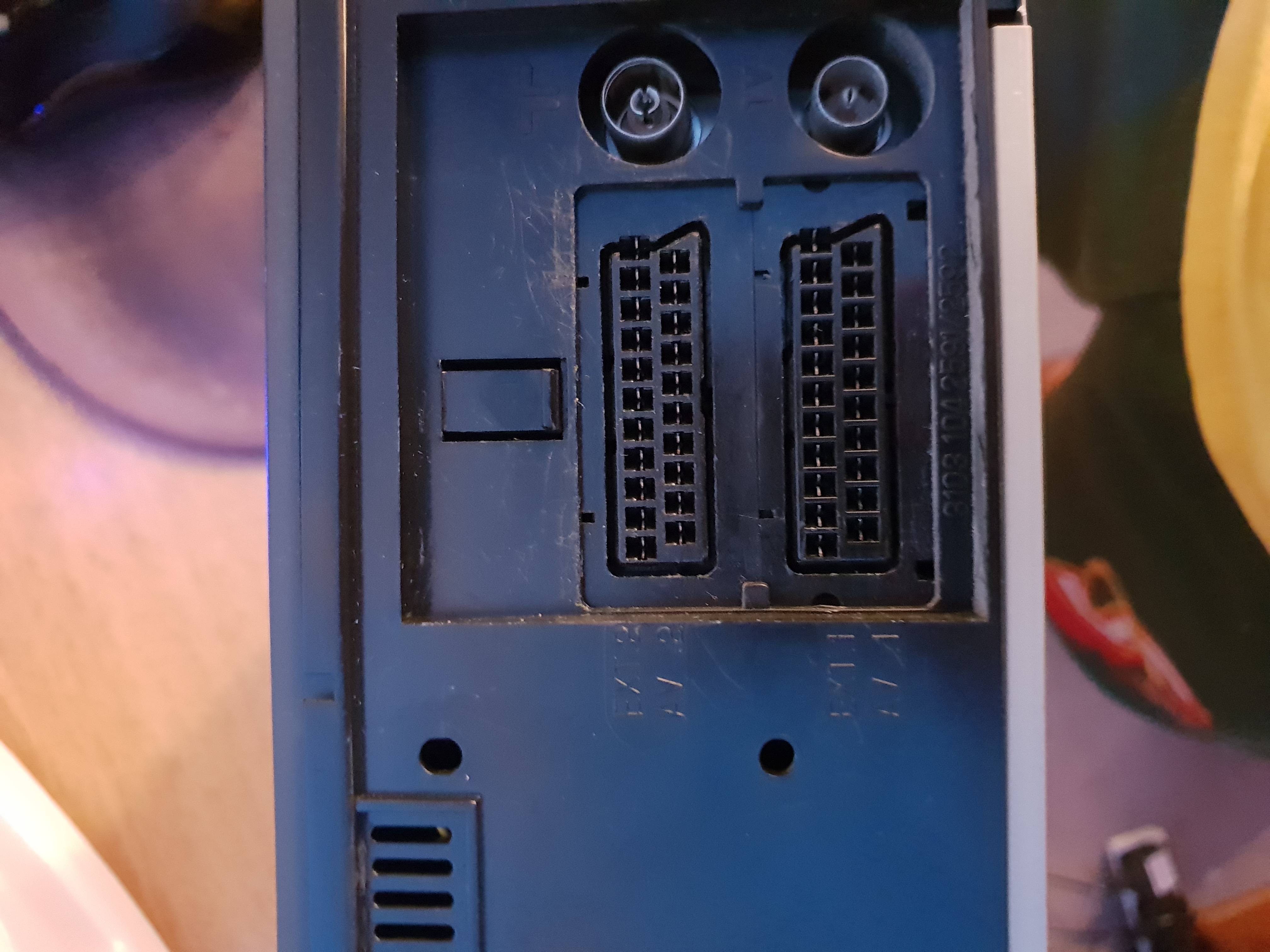

    Your VHS deck probably has two SCART connectors. One is for sending the signal from the VHS deck to a TV for playback of VHS tapes. This is an "output" and the deck probably has something like that written near the connector. The other connector is an input. It is for recording other sources onto VHS tape. The connector probably has IN or INPUT written near it.
    It might be best for you to post pictures of the SCART connectors on the VHS deck, the adapter, and the capture device.
    Ill post pictures and video tonight this sounds promising as It has 2 x scart connectors. But It calls them 1 and 2

    Having a female end for the cable is not, normally, an issue.
    The cable is, typically, quite short so you then use a standard composite male to male for the ultimate connection ( since the distance from VCR to PC could be quite long) to the capture device.
    One thing that occurred to me is that the OP actually connected the wrong coloured cable from connector to capture device. Whist they may all look the same most of us know that red or white in to yellow will mean a blank screen. To clarify. You connect red plugs to red sockets. White to white. And Yellow, which is the video signal, to yellow.

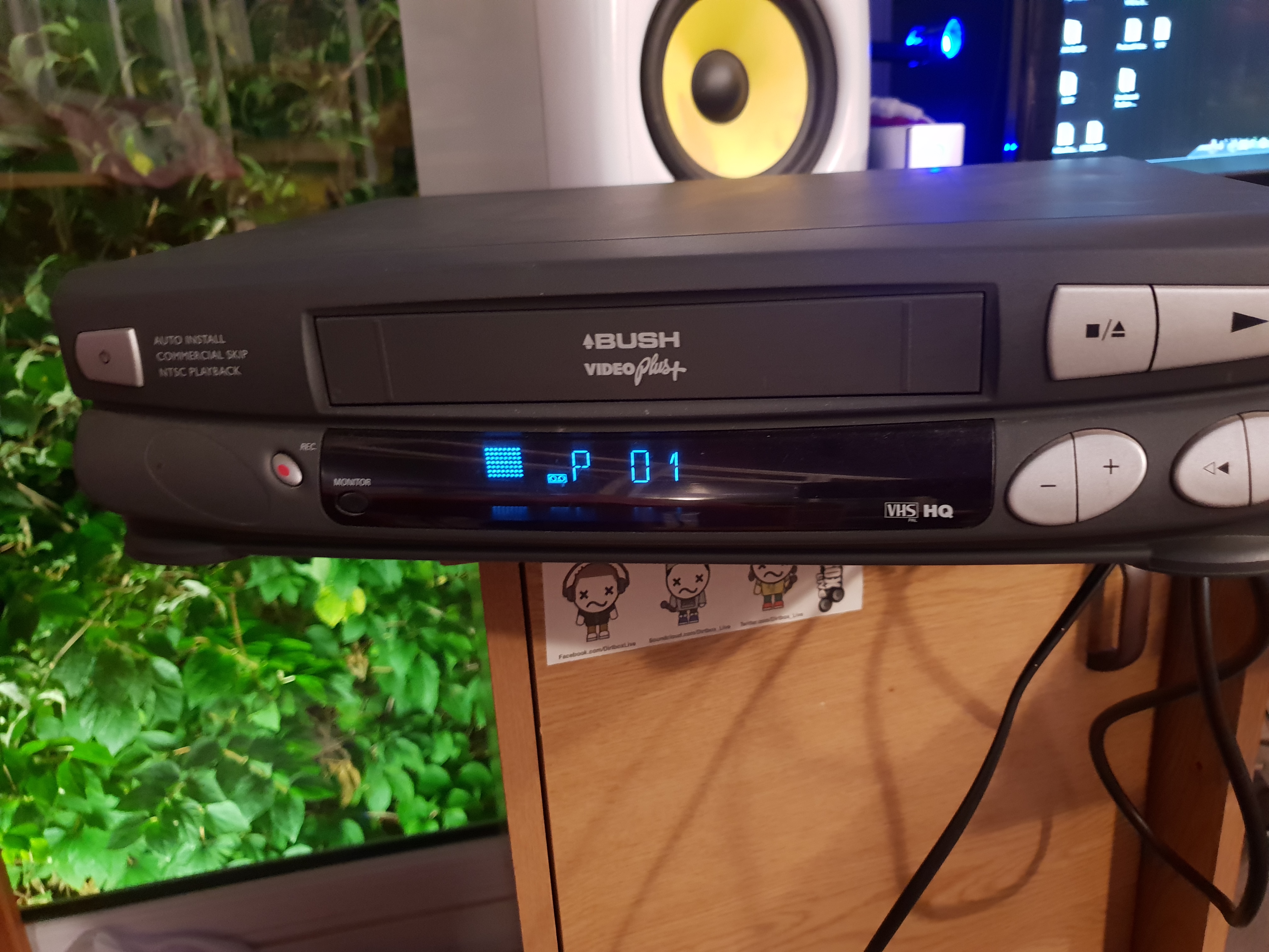

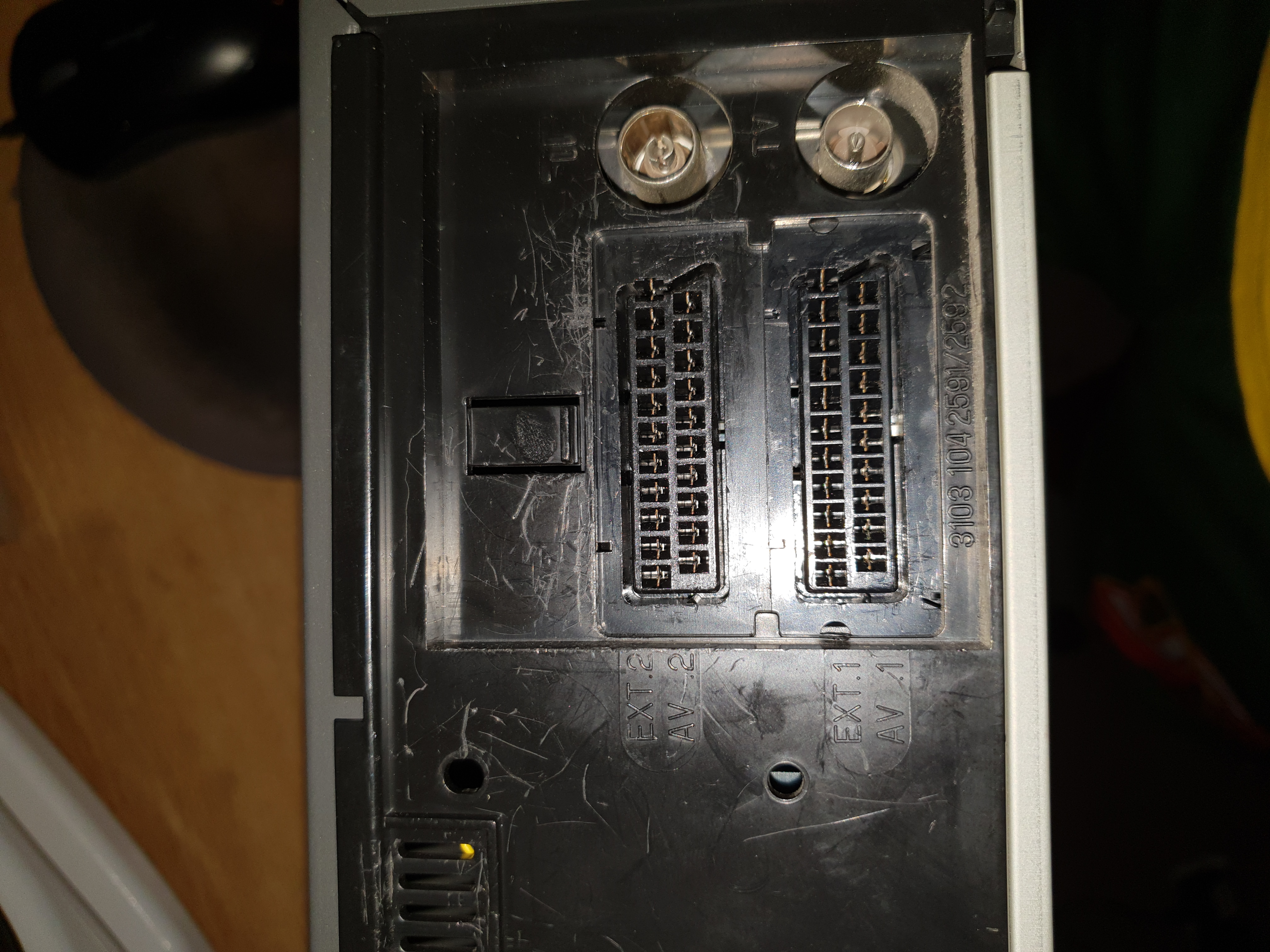

    The player is a. Bush video plus Image
    [Attachment 46716 - Click to enlarge]
