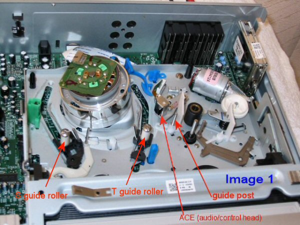

  5. Im a complete newbie when it comes to the names of parts on the vhs! Where exactly is the transport and pinch roller? Sorry to ask you to specify again!

    It's labeled "ACE" in this photo. A smooth vertical piece that the tape rides against. Be careful while you are working there not to touch any part of nearby video drum. The control/audio head may need to be demagnetized as well as cleaned.
    [Attachment 46682 - Click to enlarge]

    https://goughlui.com/wp-content/uploads/2014/02/DSC_1879.jpg
    The stationary audio/control head is at far right, the pinch roller is to the right of that (out of the picture)
