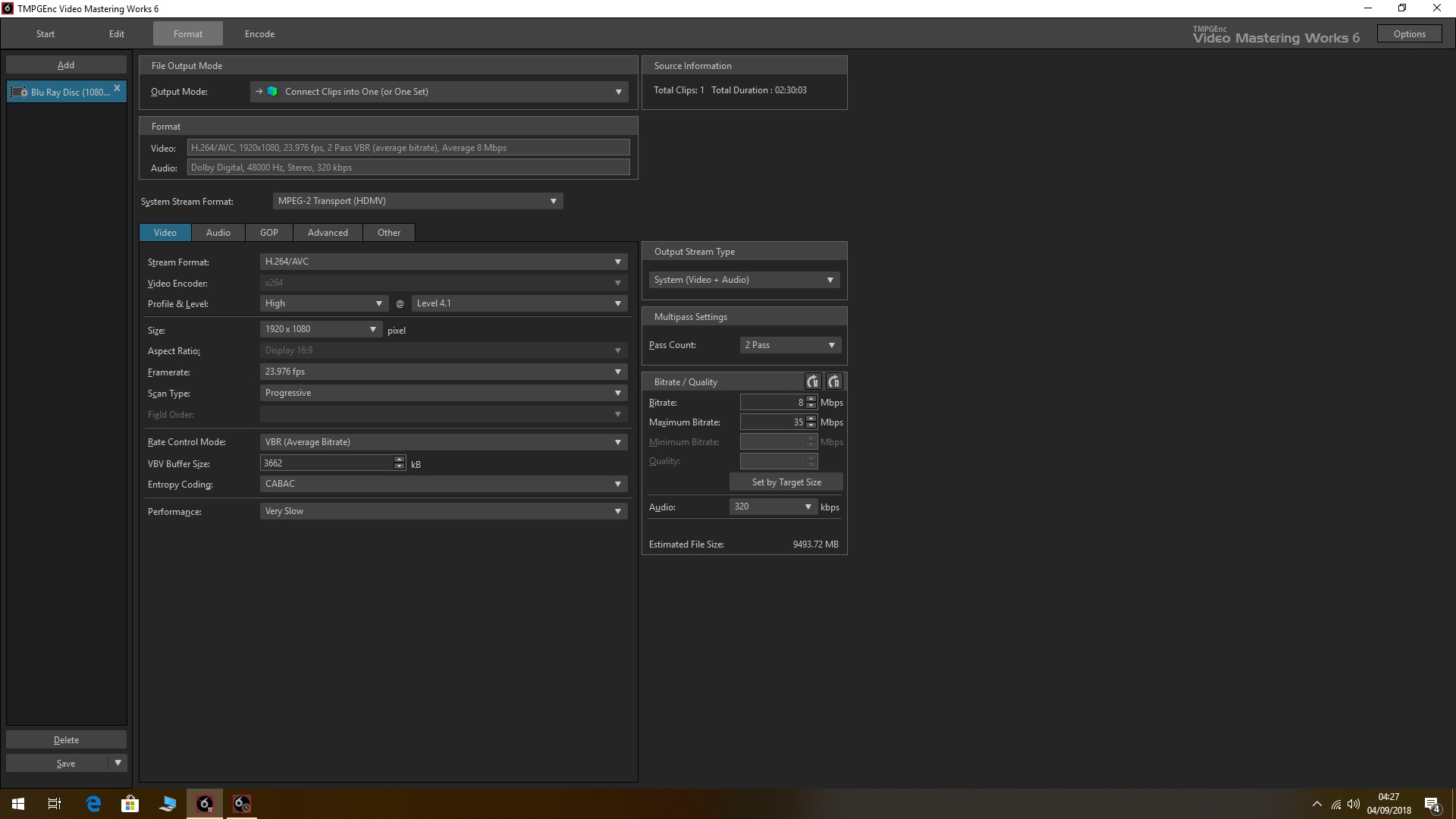

    These are the settings that TMPGEnc uses.
    [Attachment 46674 - Click to enlarge]
  16. They use a capitol B in kB so that probably means kBytes. 3662 kB is 29296 kbits, a reasonable number for Blu-ray compatible VBV.
  17. tmpgenc manual says:
    - Maximum Bitrate [--vbv-maxrate]
    - VBV Buffer Size [--vbv-bufsize]
    so most likely tmpgenc in your case uses:
    --vbv-maxrate 35000 --vbv-bufsize 29296
  18. Inconsistent GUI in that screenshot. Poor design choice swapping bytes vs. bits notation .
    I would double check with small test run to see what actually gets passed
    Feb 2006
    England
    So, if I did use CRF 21 with that VBV, would it be ok for Blu Ray players?
