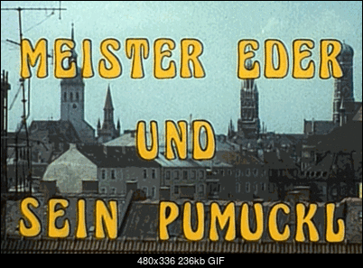

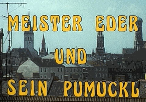

  1. Is QTGMC denoising in default mode?
    I think so, but is this right?
    Look at the letters.
    Original:
Name:	without QTGMC.gif
    After QTGMC:
Name:	with QTGMC.gif

  5. Is QTGMC denoising in default mode?
    yes
    it is as intended by the author of the script.
    If you don't like the behavior adjust the settings. You might want to read http://avisynth.nl/index.php/QTGMC that should also clear up what the suggested 'sourcematch=3' does. You also probably want to read up on the 'lossless' option.
    As a side note, looking in the QTGMC script you can see the defaults that are used for each preset:
