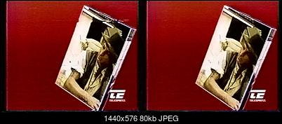

    There are some places where the two frames (after QTGMC) are identical except for a dropout (and other noise) in one. You can copy the good frame over the bad frame to fix that.
    In some places you can use a motion interpolating filter to substitute good frames for frames with dropouts and other distortions. On the left the original frame, on the right a frame by interpolating motion between the two frames surrounding it (ReplaceFramesMC):

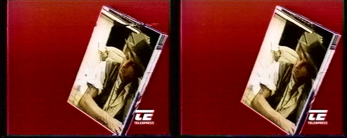

  11. Jagabo, it definitely looks better!
    Can you please explain me how to use it?
    Where can I find ReplaceFramesMC and MDegrain? I cannot find them on http://avisynth.nl/index.php/External_filters
    Sorry for the numerous questions, but I feel I'm close to the goal

  15. This is some really heavy and slow filtering but maybe it's something like what you want. I didn't apply any "manual" fixes with ReplaceFramesMC. There are some distortions in the rotating box but they're not too noticeable.
  16. That function is capable of great things, but it requires the patience of a saint
    Ahah, good to know
    Johnmeyer and Jagabo, thank you very much! Your results are both excellent
  17. Here's the script I used in post #15:
    Mpeg2Source("Telexpress.d2v", CPU2="ooooxx", Info=3) # use the deringing feature, no deblocking
    AssumeTFF()
    ColorYUV(gain_y=130, off_y=-18, gamma_y=100, opt="coring")
    BilinearResize(width/2, height)
    QTGMC(preset="slow")
    # replace the opening text with a single frame, averaged from the first 8
    subst = Trim(0,7)
    subst = Merge(subst.SelectEven(), subst.SelectOdd())
    subst = Loop(subst, 20,0,0).AssumeFPS(last.framerate)
    subst + Trim(20,0)
    even = SelectEven()
    even = MergeChroma(even, even.TemporalMedian(2)).RemoveDirtMC(150)
    odd = SelectOdd()
    odd = MergeChroma(odd, odd.TemporalMedian(2)).RemoveDirtMC(150)
    Interleave(even,odd)
    rmask = MaskHS(StartHue=100, EndHue=130, MaxSat=150, MinSat=30).Blur(1.0).BilinearResize(last.width, last.height).ConvertToYV12()
    filtered = TNLMeans(ax=8, ay=8, az=8, h=16)
    Overlay(last, filtered, mask=rmask)
    MergeChroma(aWarpSharp(depth=5), aWarpSharp(depth=20))
    Spline36Resize(width*2, height)
    ChromaShift(c=-4, l=-6)
    Stab(dxmax=0, dymax=2)
    I normally wouldn't use TemporalMedian(2) to fix the chroma because it would cause too much color artifacting. But this clip doesn't have any fast motion, the color is already screwed up, and VHS has very low color resolution anyway, so it's ok here.
    150 is normally way to high for RemoveDirtMC(). But again, motion here is pretty low so it doesn't screw things up too much. It fixes a lot of the dropouts so I think it's worth using here.
    I then build a mask that marks all the red areas, and create a strongly smoothed video with a temporal/spacial filter, TNLMeans. Finally, I replace the red portions of each frame with that heavily filtered version. TNLMeans with such high values is very slow.
    The luma is slightly sharpened, the chroma more strongly sharpened, the chroma is shifted to better align it with the luma, and some vertical bounce is reduced with Stab().
  18. Thank you
  19. Here's a list of frame replacements that can be added to the end of the previous script:
    ReplaceFramesMC(26)
    ReplaceFramesMC(28,3)
    ReplaceFramesMC(38)
    ReplaceFramesMC(40)
    ReplaceFramesMC(57,5)
    ReplaceFramesMC(126)
    ReplaceFramesMC(251,5)
    ReplaceFramesMC(567)
    ReplaceFramesMC(569)
    ReplaceFramesMC(652,2)
    ReplaceFramesMC(696)
    ReplaceFramesMC(698)
    ReplaceFramesMC(721)
    ReplaceFramesMC(764,4)
    ReplaceFramesMC(1015)
    ReplaceFramesMC(1017)
    ReplaceFramesMC(1089)
    ReplaceFramesMC(1091)
    ReplaceFramePrev(1120)
    ReplaceFramePrev(1121)
    I also cropped away the crap in the borders and restored them with pure black. The original video (simple bob) and filtered, side by side, attached.
