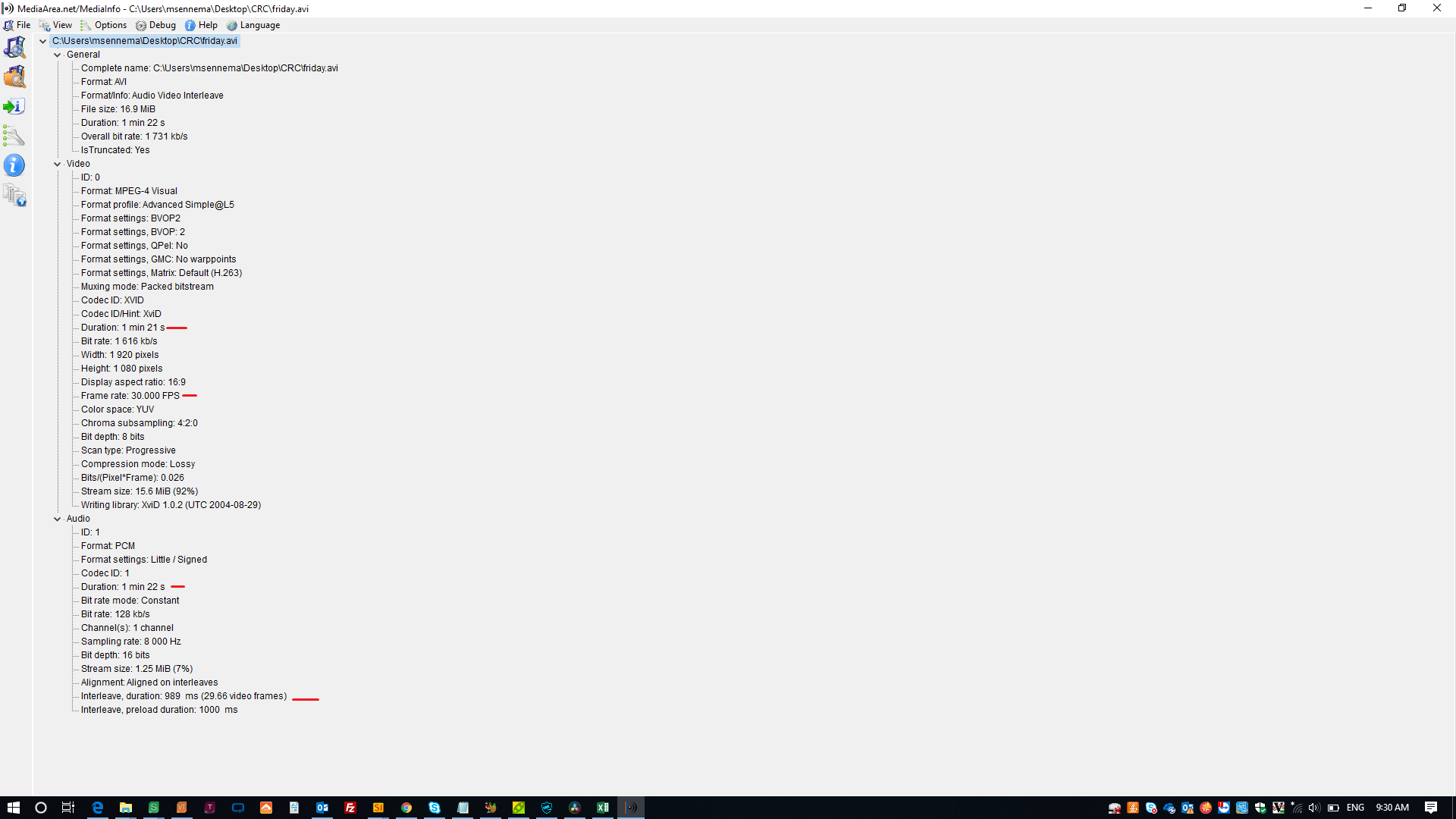

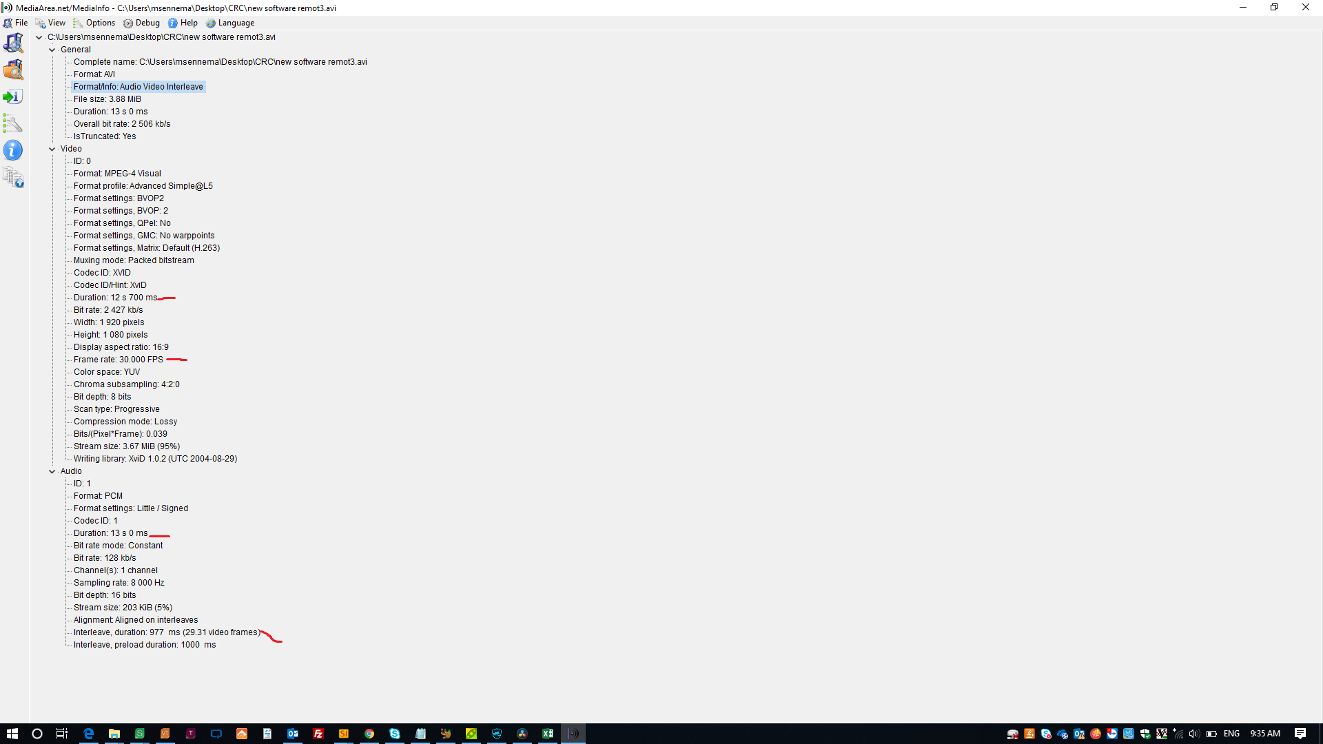

    Long story short is I am working with a Networked DVR which exports an interlaced .avi file. When I play back these files the lip-sync is off anywhere from 200-500 ms. Never the same. In reading a lot of posts I tried many different ways to line this back up easily, but haven't found anything that works. I was hoping using HandBrake may work, and run the file through "constant frame rate but it seems to be the audio that slips. Here are two different files, screen grabbed using MediaInfo.
    VIDEO 1

    VIDEO 2

    As you can see the audio duration is always longer then the video, and the frame rate is variable and drops to 29.66fps and 29.31fps in these examples. (always different) Is there a way to easily get these in sync without doing it manually and aligning by sight?
