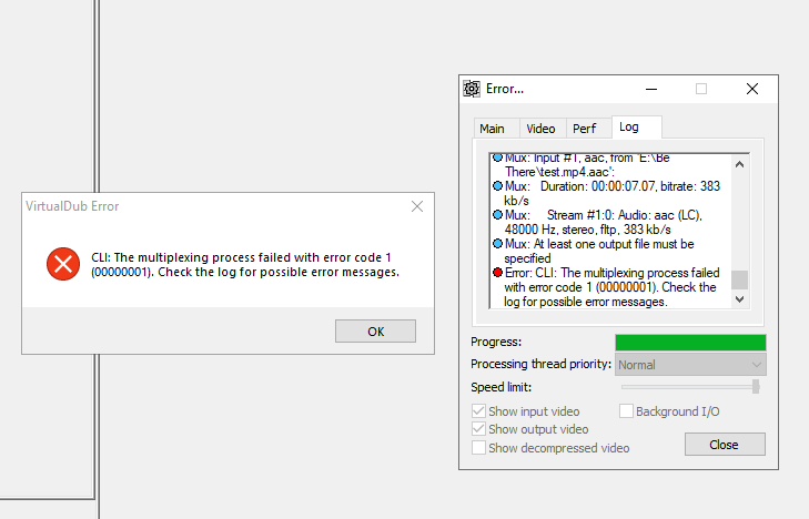

    Also tried it in vdub2 as suggested by poisondeathray. I know vdub2 exports mp4 but I'd rather the external encoder working as well.
    There's a bit more detail on the error which might give clues:
    [Attachment 46617 - Click to enlarge]
    And the log file is attached.
  10. You are missing "%(outputname)" from the muxer settings.

  12. I reuploaded the fix. Try again with VirtualDub2. It should fix the "CLI: multiplexing failed with ...." message. It will not fix the livelock you have with the old VirtualDub. That seems to be a deeper problem and is not because of wrong settings. Maybe it's a problem with the input drivers or VfW/ACM codecs.
