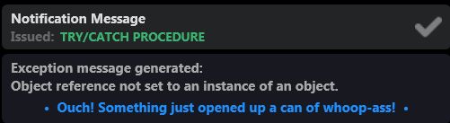

  16. I love Box 4 v3 and use it all the time. Yesterday I started receiving the following message for every file I tried to converter from mkv to mp4. I have no idea what this message is trying to tell me, or if there is something I can do to fix it.
    [Attachment 67048 - Click to enlarge]
    Not sure that worked, so here is another link to the message screenshot
    https://prnt.sc/Q968YsAeuwWN

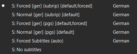

    Having another run with BOX4, because of having the need of handling many files and use loudnorm.
    I found a bug when putting in and out mkv. All tracks are marked default, here is an example how this looks in a player with subtitles:
    [Attachment 90423 - Click to enlarge]
    With MKV it is not important to set a track to default, but one can.
    It is a must have setting for mp4 only.
    Absolutely necessary for Box:
    - "Keep the Chapters" - Chapters are gone with newly created files
    - "More than 100 files in queue" (make this a thousand or so) - When adding more than hundred files from different folders by dragndrop at one point in queue, files are obviously randomly picked from source folders; you cannot throw files into it and hit start and let it work, i just recognized this limitation, because files were missing after a long run.
    Perhaps you could manage these few bugs in a cold winter night?
