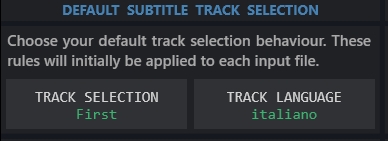

  6. I wanted to add a little suggestion about the feature I asked and the author gently included (forced sub auto selection). I think a better and clearer way to achieve this goal would be adding a selection option "Forced" here:
    [Attachment 48130 - Click to enlarge]
    ...so you will have the total control...forced+choosen language and you can't be wrong
  7. Originally Posted by sharer777 View Post
    Totally agree.
    If @video.baba decides to implement this "forced subtitles auto selection", taking advantage of the occasion,
    hopefully add the warning signal once task list's finished.
    Anyway after having tested for two days, it works great and it's really fast.
    Thanks again.

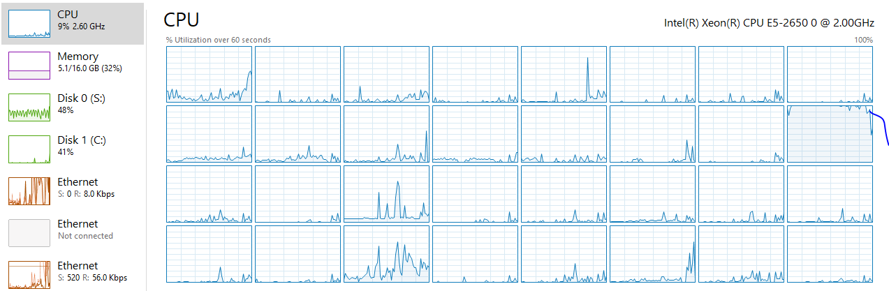

  8. Why is only one core being maxed out while the rest are barely being used during encoding?
    I assume this is a FFMPEG limitation?
    [Attachment 48213 - Click to enlarge]
