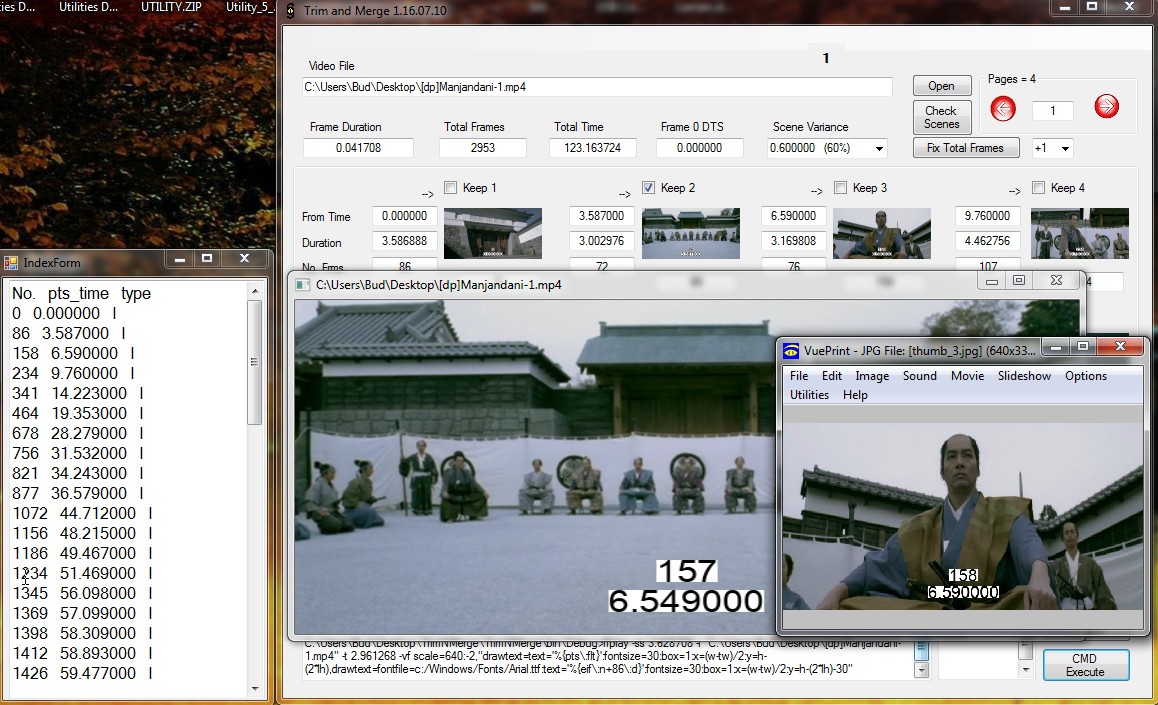

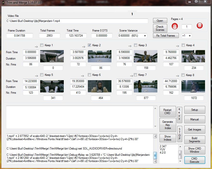

    Oh this is a task I may not survive the criticism of but to start, I use 2 main scripts which each create 2 files, one formatted and one a summary of that.
    List All Frames and Types:

    Both CMD files have '::@echo off' at top. This allows errors to show but can be changed to '@echo off' after no errors show and it works. Anyone who has worked with CMD batch knows how tricky it is for quotes and where and when things are entered . These work fine on my version [Version 6.1.7601] of Windows .
    The one to cut is over 97 lines so I'll save that one until these work fine. I'm running out of time it seems but I am trying to incorporate the batch files as well as working CMD console into a project that displays the key frames or scene change location with the frame number and time embedded. Left clink plays the sequence and right click displays the actual image frame. Sequence should end on the frame preceding the next frame.
    [Attachment 46822 - Click to enlarge]
    [Attachment 46823 - Click to enlarge]
