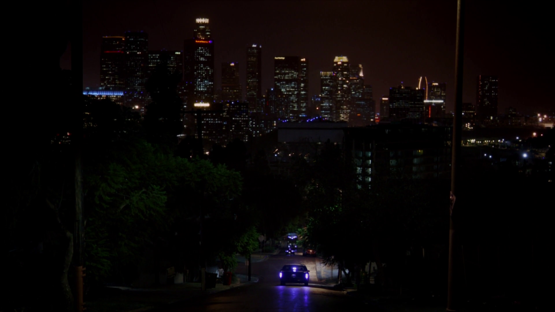

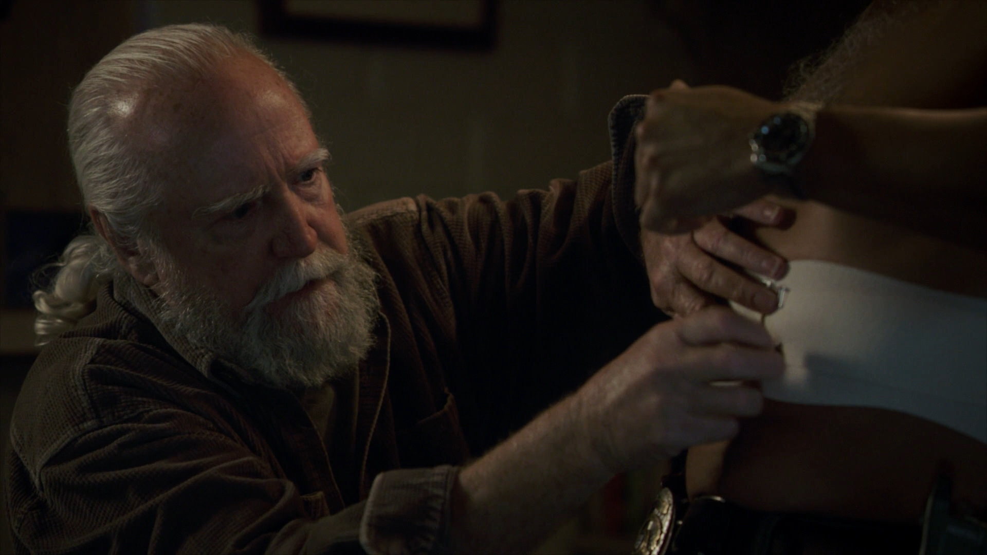

  8. If that vlc screenshot was the output of your commandline in the 1st post, it looks close and that would imply that it's not actually encrypted. It's probably just U / V plane issue, you might have to play with some orientations
    does this look correct ? it's just swap uv (done in avisynth)
    It can be done if ffmpeg too
    https://ffmpeg.org/ffmpeg-filters.html#swapuv
    But it's better to get the correct vtag or settings than having to applying a filter (it would be faster) . Forcing the vtag to something else might work, such as IYUV , or I420, or NV12, or NV21, some other 4:2:0 fourcc. You'll have to try some out that are 4:2:0
    https://www.fourcc.org/yuv.php

    thanks I want to use staxrip how to make him take the raw ?
  10. Originally Posted by JAX75 View Post
    I don't use staxrip, but it can use avisynth, so possibly rawsource()
    RawSource("B S01E01 [1080p].raw", 1920, 1080, "YV12", fpsnum=24000, fpsden=1001)
    you can try "I420" instead (or NV12, or N21, one of them should work) , or use swapuv() in the script with YV12
  11. thank you for your help I used RawSourcePlus
    RawSourcePlus("1x01.raw", 1920, 1080, "I420", fpsnum=24000, fpsden=1001)
    [Attachment 46609 - Click to enlarge]
