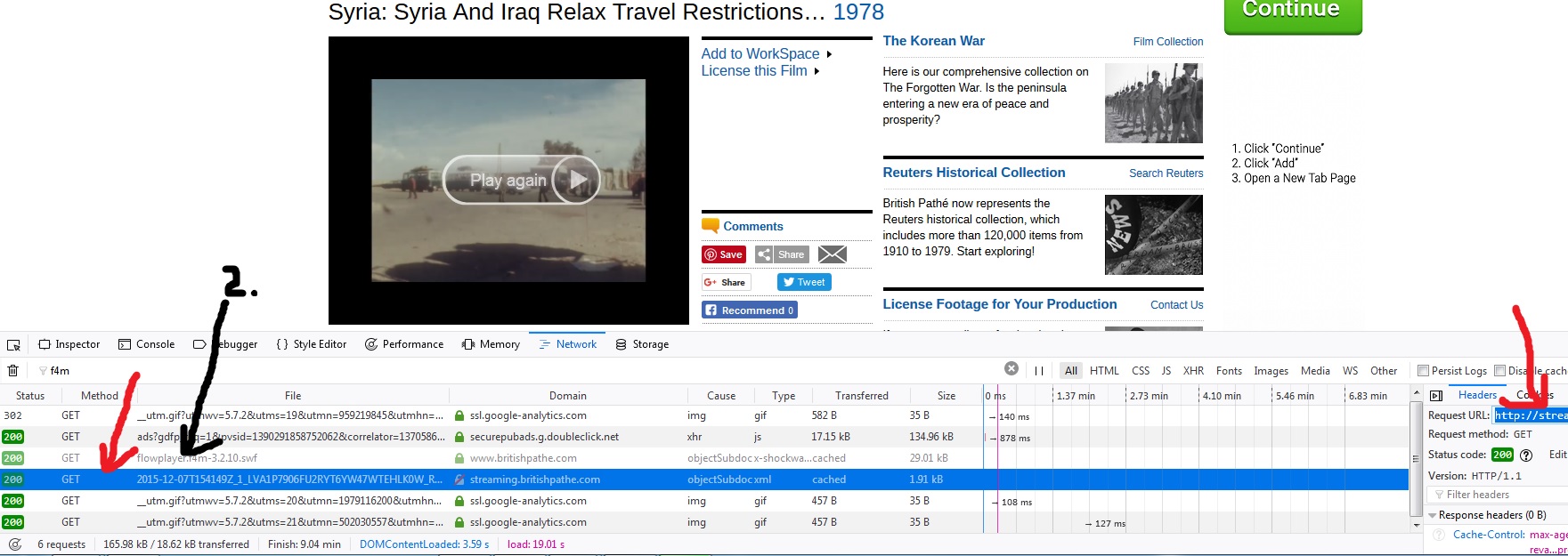

  2. I'm on Win7 Pro SP1 and i used FF (sorry not mac) but its quite simple to download.
    I F12'ed and refreshed the page for the network traffic and typed f4m in "Filter urls" and F5'd again while video is playing. This manifests 6 Requests from your browser and one of them is a GET under Network/Domains - streaming.british.pathe RED arrow.
    Click on this and get the REQ Url from the far right of the page; RED arrow again - it 'calls' an url of
    http://streaming.britishpathe.com/hds-vod/MEDIA-5/archive/W0KL/2015-12-07T154149Z_1_LVA1P7906FU2RYT6YW47WTEHLK0W_RTRWNEV_F_SYRIA-SYRIA-AND-IRAQ-RELAX-TRAVEL-RESTRICTIONS-FOLLOWING-SIGNING.MP4.f4m
    Load this into Jdownloader and the file is yours. (Or if its running it will indicate a DL avail).
    [Attachment 46611 - Click to enlarge]
    Footnote: Media Info Lite reports the downloaded mp4 is mis-named and is a swf video. And note the black-arrowed swf player too in the Network traffic. (2). This seems to buffer the little file very well for playback whereas I found when I played it back in 'conventional' media players it locked up here n there. (I DL it a few times over to make sure I hadnt got a dodgy DL).
