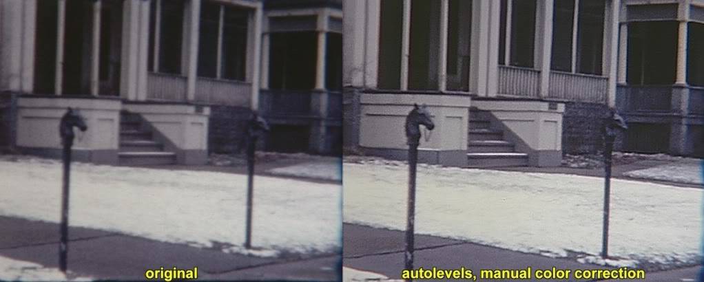

Hi, I have some difficulty understanding the english context of some words, and jagabo knocks me out, haha...But I think he has already gotten used to my jerkinesses
You're the guy who did it:
[Attachment 46571 - Click to enlarge]
Incredible!
