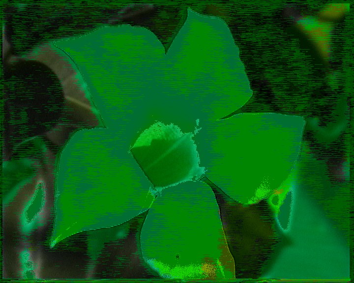

    Jul 2007
    Hmm strange, must be an issue my end then. To confirm, this was your input for that file?
    ffmpeg -i sample.avi -top 1 -f yuv4mpegpipe - | ffmpeg -i - -i sample.avi -map 0:0 -map 1:1 -c:v ffv1 -threads 8 -coder 1 -context 1 -g 1 -slices 24 -slicecrc 1 -c:a flac -compression_level 12 -aspect 4:3 out.mkv
    When I use that I get this error in ffmpeg (v. 4.0.2)
    Thread message queue blocking; consider raising the thread_queue_size option (current value: 8)
    pipe:: Invalid data found when processing input
    And the output looks like this
    https://forum.videohelp.com/images/imgfiles/hE8NQVv.jpg

    Jul 2007
    commandline looks the same unless there was a typo somewhere
    this is what I used exactly (copy/paste)
    ffmpeg -i sample.avi -top 1 -f yuv4mpegpipe - | ffmpeg -i - -i sample.avi -map 0:0 -map 1:1 -c:v ffv1 -threads 8 -coder 1 -context 1 -g 1 -slices 24 -slicecrc 1 -c:a flac -compression_level 12 -aspect 4:3 output.mkv
    Maybe update your ffmpeg ? I used zeranoe's windows build , maybe a few weeks old. Maybe your ffmpeg binary wasn't compiled with updated utvideo library ?
    It plays ok with ffplay, other media players
    I updated ffmpeg to the latest from zeranoe. With the release build, 4.0.2 I still got the progressive labelled output and the lav version was older:

  20. Originally Posted by Killer3737 View Post
    With the latest nightly, I do get the same as you, interlaced and Lav version Lavc58.24.101, but the output still looks like that, with the error messages.
    Green output ? in ffplay too ? Not all players/decoders support ffv1 1.3 . Check the output in some updated players with updated decoders too. Recent ffplay should decode ok
    do you still get the pipe error ?
    I get the thread_queue message too (not the pipe error) , but shouldn't affect the actual output, just the processing speed .

  22. Member
    Jul 2007
    Yeah, green, and still the pipe error. It wasn't green when doing it directly, only with your pipe workaround. Definitely an encode issue, because the size/bitrate is smaller.

  26. Not sure what' s going on, but check the pipe output in ffplay - is it "green" for you ?
    ffmpeg -i sample.avi -top 1 -f yuv4mpegpipe - | ffplay -i -
  27. Member
    Jul 2007
    EDIT:
    Heh, well this was ridiculously stupid. I'd been running all of these through powershell, I thought to try old Command Prompt instead and hey presto, it's fine.
  28. Originally Posted by Killer3737 View Post
    EDIT:
    Just curious - Why would that make a difference in powershell ?
  29. Member
    Jul 2007
    EDIT:
    I have no idea. Either my machine is really borked, or Windows being Windows I guess.
  30. Member
    Aug 2010
    San Francisco, California
    Thank you for this, poisondeathray! I was concerned that the pipe might change video data but I ran framemd5 comparisons on a plain MKV and a piped MKV and they are video-identical.
