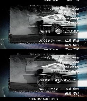

  4. Try using 23.976 fps CFR and converting the credits with:
    FrameRateConverter(NewNum=24000, NewDen=1001)
    That converter errors on the side of blended frames rather than distorted frames. It will look at lot better with the scrolling credits over a moving picture. It won't be perfect but it will look better at normal playback speed. SmoothFPS2() on the top, FrameRateConverter() on the bottom:

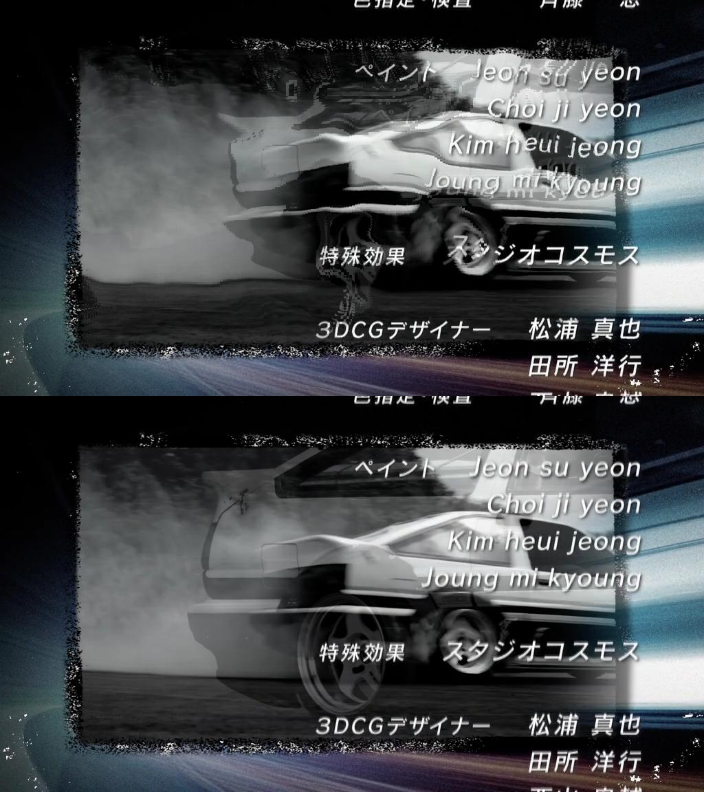

  18. This is just plain 23.976p . A simple IVTC .
    There are some repeat frames, but that's intended and part of the animation style. Most people would leave it at 23.976p with the repeats . Typically this style/type of animation does not have 59.94 CG elements . But credits can be 29.97p or sometimes 59.94p . I didn't look at your credits sample - was that "original" or processed ?
    That mp4 you uploaded is blended and messed up. Not sure how you made that ? Maybe you resized it while it was still in fields ?

  23. The credits overlay (the actual scrolling credits) are actually 29.97i (they are 59.94p speed when bob deinterlaced) , but the background is mostly 29.97p where the live action/band is playing . (There is some cartoon insert of cars near the middle, that's really messed up)
    Some people would leave this section at 29.97p , others at 59.94p. Me personally, I would use 29.97p because the credits aren't really that important - it's not vital that they are super smooth. Just smooth.
    There are dedicated scripts that deal with "interlaced credits", but anything you do will involve some sort of trade off for this credits section (if the main section sample was representative, that part is quite clean and easy)
