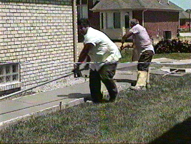

  1. Hi. First time poster. I spent some time searching and found a number of threads that had a similar issue, but not many concrete solutions.
    I'm trying to digitize some 8mm tapes for my parents. So far nearly all of them have gone fine, but I have a handful of problematic TDK-brand tapes that do not playback properly in certain spots. Specifically there's a 2 minute passage where the video repeatedly struggles to maintain a signal. However the picture shows up when I fast forward or rewind while in Play mode. In other spots on the same tape, playback is fine but there is a horizontal band across.
    I've attached examples of both. My playback device is a Sony DCR-TRV330 Digital8 camcorder. The tapes are TDK MP120 8mm (the rest have all been a mix of either Sony or Maxell and have had no problems).
    I've seen multiple suggestions about cleaning heads of the playback device, but not sure how helpful that would be as it can otherwise read every other tape perfectly fine and only has trouble with TDK tapes. This isn't my area of expertise though, so I'd appreciate any guidance I can get.

    That's a classic video head clog. Your tapes are damaged and shedding in these places. When you run in fast scan, the clogs are rubbed out. You can try winding the tapes from end-to-end a few times to shake out the loose junk. Then use duster spray on the camcorder to blow out the debris.

    Misalignment is also likely.
    Either current camera, or past camera that made tapes.

    The sample you posted illustrates a damaged tape that causes a head clog. There may be alignment issues as well, but you still have a problem with the condition of the tape. Cleaning the heads may only work for a few seconds.

    The tape might not be damaged,if the camera had loose tape guides then the picture would get recorded with different heights causing that issue,only way to fix that is to capture the video while adjusting the tape guides manually to match,i have done this myself and it isn't perfect but you will get all your video with
    bit of trial and error matching.

    Thank you so much for responding. The videos were recorded on a different camcorder. That camcorder broke. I am using now a different camcorder to replay them to catalog what is on each one. I have found now that it is something wrong with the camcorder. As I tried to play back four different tapes this happened. So I took a tape that I already knew worked fine and put it in and this same thing happened on that. So I know it is a problem is the camcorder itself. Is there a way I can fix this?

    Check the tape guides to see if they are loose,this happens on a lot of older 8mm camera.

    If the guides are loose tightening might not help if they are not properly adjusted first,it could be some other failure causing the issue but i always look at the tape guides first.
