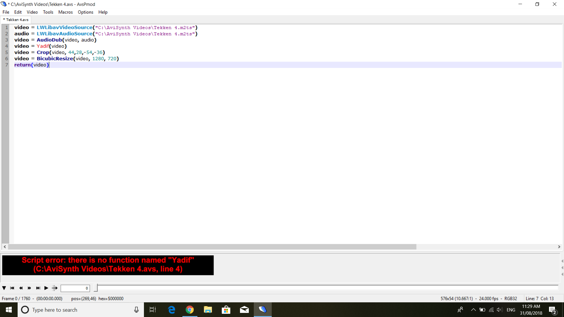

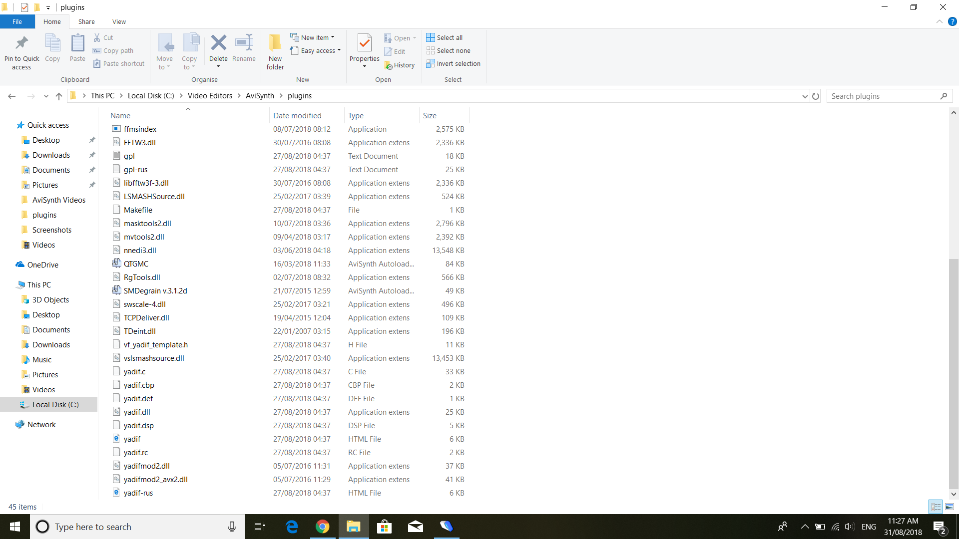

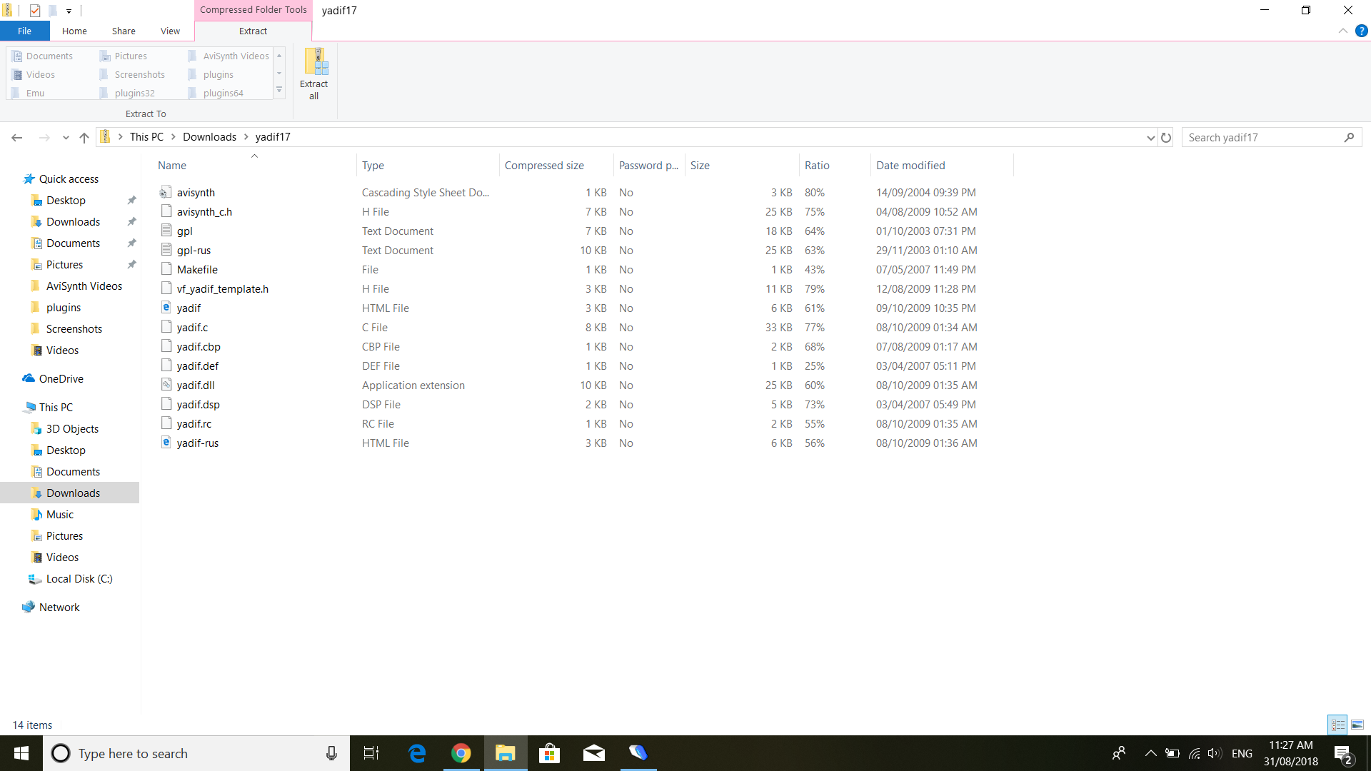

  4. I downloaded and installed Yadif in AviSynth Plugins, but AviSynth does not seem to recognise it. Here's how I installed. Image
    [Attachment 46647 - Click to enlarge]
    . Image
    [Attachment 46648 - Click to enlarge]
    . Image
    [Attachment 46649 - Click to enlarge]
  5. Yadif is a little different than most AviSynth filters. It won't autoload when in the plugins folder. You have to use a special import in your script:
    Load_Stdcall_plugin("C:\path\to\yadif.dll")
    On my computer AviSynth is installed in: "C:\Program Files (x86)\AviSynth\". I put yadif.dll in AviSynth's plugins folder (even though it doesn't autoload on its own). Then I use an avsi script in the plugins folder to autoload yadif.dll so I don't have to remember to manually include it in my script. The Yadif.avsi script looks like:
    Load_Stdcall_plugin("C:\Program Files (x86)\AviSynth\plugins\yadif.dll")
    If you have AviSynth installed elsewhere you'll need to modify the path to match.

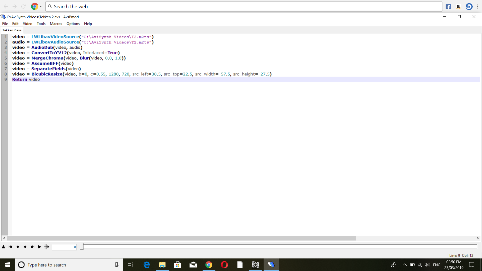

  7. Blur() has no input video:
    video = MergeChroma(video, Blur(video, 0.0, 1.0))
  8. I need another help with deinterlacing. QTGMC or Yadif do not really help with some interlaced videos, but separate fields does help removing undesired horizontal line artifacts. However, the video gets shaky when I use that deinterlace. Is there any AviSynth filter that stabilises it?

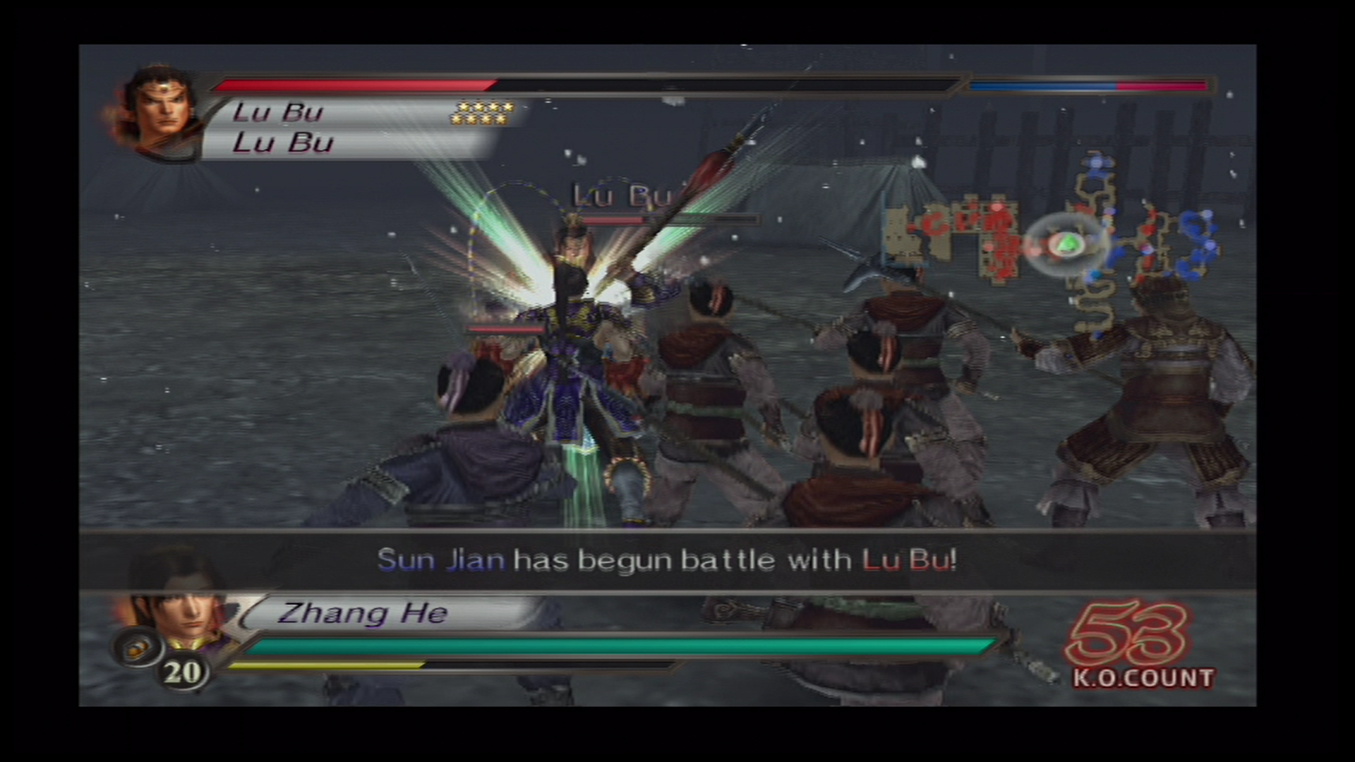

  19. Hi, I also have another question about deinterlacing. As you can see the image, you can see interlaced artifact on the face. Normally, my captured interlaced videos don't show this, but this game is unique. Can you tell me what type of deinterlacing would be a solution for this? Image
    [Attachment 50506 - Click to enlarge]
  20. Supply a short sample of your SOURCE VIDEO. How many times to you have to be told this?
  21. Okay, sorry about that. Here.
  22. QTGMC didn't have any problem with that here.
    LWLibavVideoSource("12-10-2019_01.m2ts")
    QTGMC()
    There's a little bouncing up and down on some of the horizontal elements but otherwise it's very cleanly deinterlaced. At the original frame size:
    [Attachment 50522 - Click to enlarge]
    Though there is some kind of problem with the source. Some ghosting a little below some horizontal elements.
