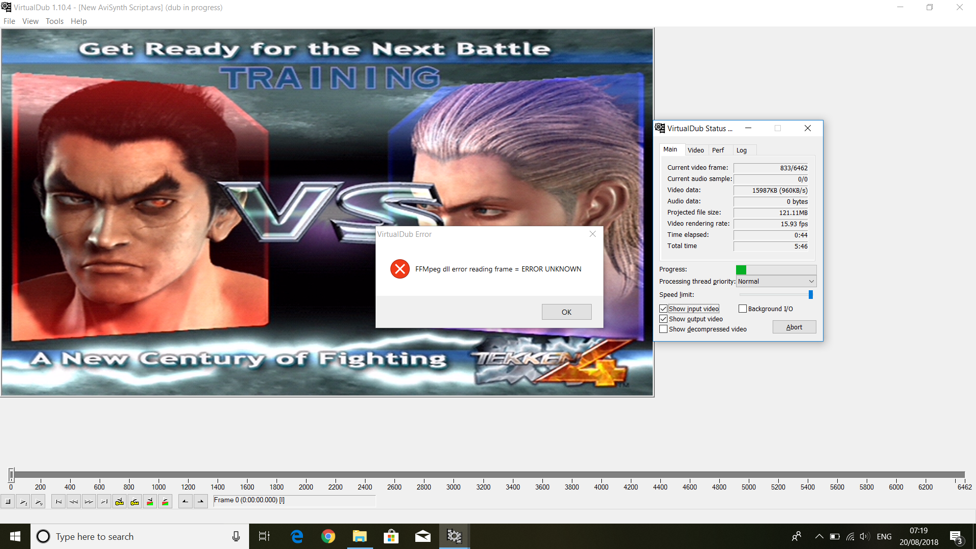

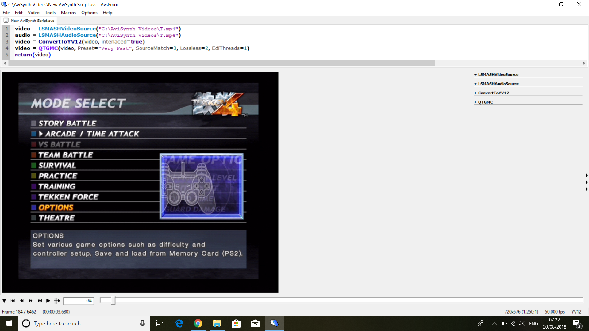

Virtualdub crashes every time I render videos with scripts. It does not happen when I render with just videos. Here are images of the script I used and error I receive. I use LSmash Source filter as you can see on the image. Virtualdub only accepts avi files, so I used FFMPEG Input Driver to make it handle all type of files. I don't know if it crashes VirtualDub Input Driver or something else because I did not use FFVideo Source.Last edited by jseo13579; 20th Aug 2018 at 09:32.
VirtualDub can open AviSynth scripts with its AVI source filter. There's no need for VirtualDub's ffmpeg source filter when opening AviSynth scripts.
