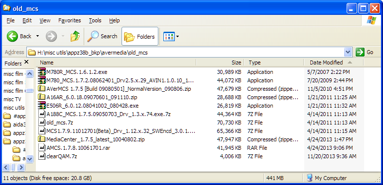

    Original driver? What was the version number? I took a look on my PC and I have the following:
    2.50.0.19 03/06/07
    2.50.0.29 06/02/08
    2.50.0.31 02/02/09
    2.9015.30 09/17/08
    I also have some versions of their Media Center software, see this image file,
    perhaps give this version a try may have been the most recent
    http://www.mediafire.com/file/cqla16so2l7ixq4/AVerMCS+1.7.5+%5BBuild+09080501%5D_Norma...ion_090806.zip
    Or possibly this one:
    www.mediafire.com/file/cj7jk5lcj1f6s3m/MediaCenter_1.7.5_latest_10040802.zip

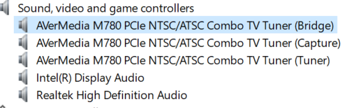

    Have you looked in the device manager to see if there is any problems? What version of the driver do you
    have installed?
  10. No problems in device manager in Win 7 or 10. The drivers install automatically and the version is 2.5.64.32 from 6/11/09. I've tried 4 different versions of SmartDVB and the ATSC tuner won't start in any of them. The DVB part of the tuner works in all of them and of course I don't need that. Very frustrating.

    Mar 2008
    That seems to be the driver for the 64 bit OS, I don't know of any earlier versions. I was running this card on
    XP about 10 years ago with the 32 bit drivers. Perhaps your card is damaged.
    Do you not have an old XP box you can test it with ?
