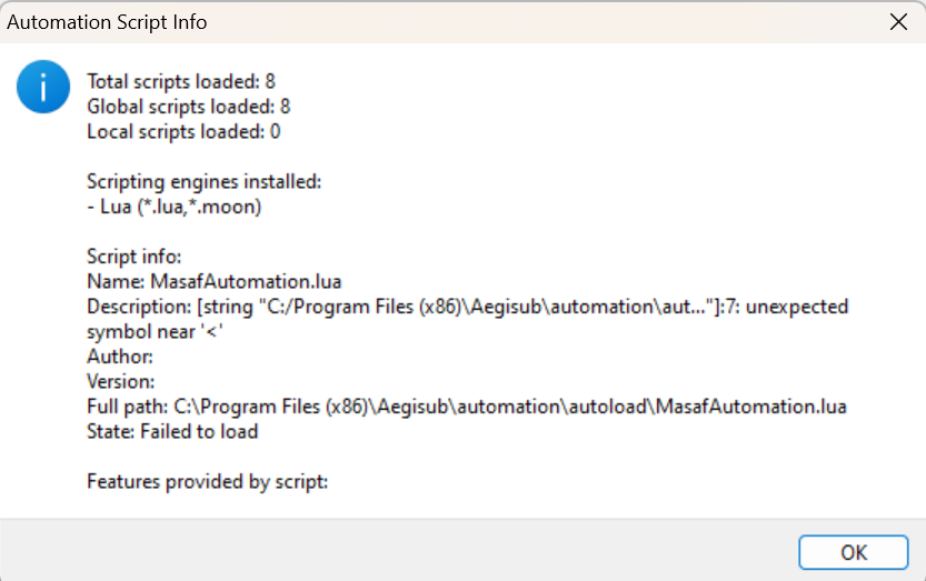

    Jun 2024
    Hanoi, Vietnam
    Hi, I have put MasafAutomation in folder Aegisub\automation\autoload, but when I open Aegisub, the following error message is shown. Can you fix this issue or show me how to edit the file so that it can work? I don't know about coding but can copy-paste a solution into NotePad++. My OS is Windows 11.
    [Attachment 79750 - Click to enlarge]
