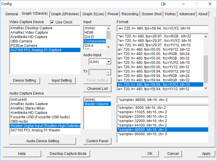

    This image shows "some" audio capture devices found in AmaRecTV.
    It is missing "Line In" from the Realtek. It does show the Digital input.

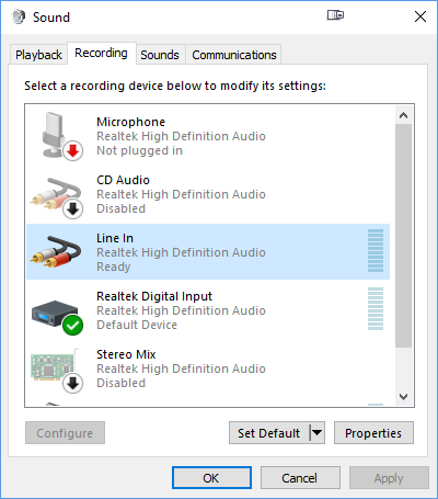

    This is a list of both Realtek devices found in Windows.
    [Attachment 46505 - Click to enlarge]

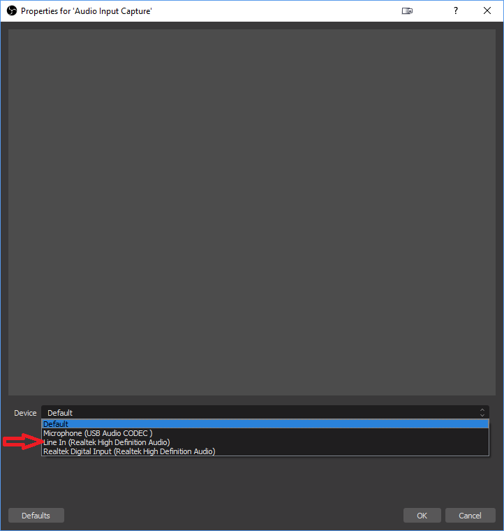

    Here is OBS on the same host, clearly showing both inputs. Not sure why OBS can but AmaRecTV can not.
    [Attachment 46506 - Click to enlarge]

    What happens if you set the default recording device in the Windows Sound dialog window to "Line In"?

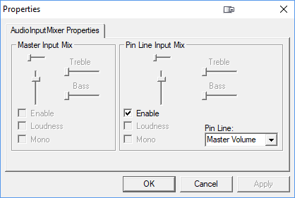

    So Line In aside... I'm still also concerned about the Digital Input. This input is selectable, but it seems to be recording silence. Even if I can not get the analog Line In, I really would like to capture from SPIDF again. When I select the "Realtek Digital Input (Realtek High Deffinition..)", no sound is captured. Just what sounds like an empty track. I can see the track in the file using VLC's info.
    Does this window show any problems? I don't know what this setup screen is for. I get here from clicking "Audio Device Settings" when selecting the Realtek Digital Input.
