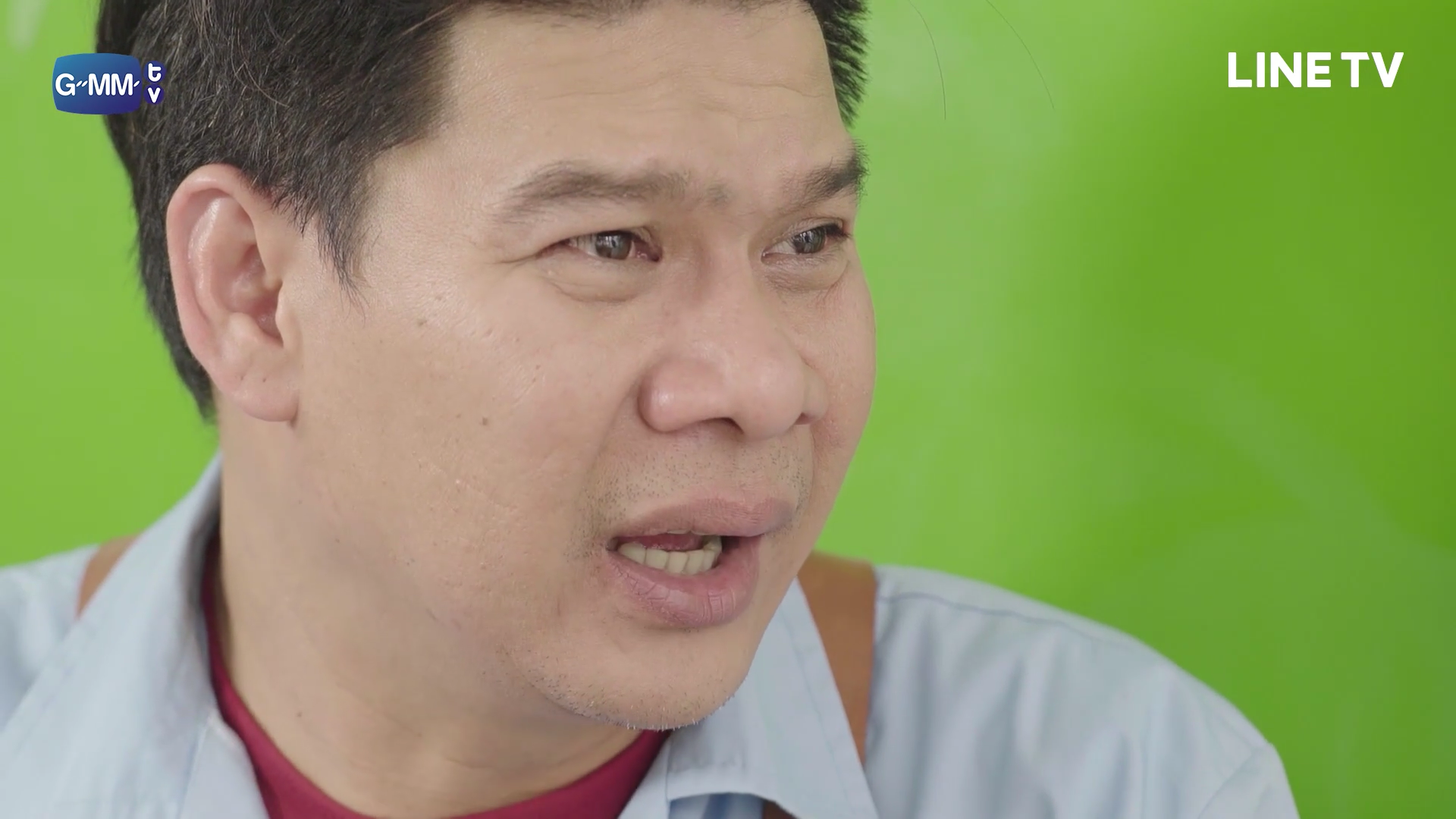

    I want to remove Logo with avisynth.
    The clip that want to removel logo is LINE TV. That has two logo. And same clip also is at the youtube.
    But That clip which at the youtube hasn't logo.
    So. I can remove Logo. I use Crop and Layer at the logo area.
    I made a function.
    function LogoEraser(clip Original, Clip Replace, int FrameStart, int FrameEnd, int "Offset")

    Until this problem occurred, it was okay.
    The two clips have different colors.
    Original Youtube.

    Original LINE TV.

    I think..I can use Twist function.. But I didn't... I couldn't adjust... T_T
    I search at the google. But I couldn't.
    I could search Just use BMP File. isn't Other Clip.
    I guess.. I have a 2 ways..
    One way is useing Twist.. or Adjust colors.
    The other is useing Filter some delogo. But it's Quality lower that Original clip.
    Last. I'm sorry.. I do not know if I wrote my thoughts well in English.
    Thank you for read my post. I hope your comment.

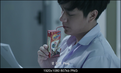

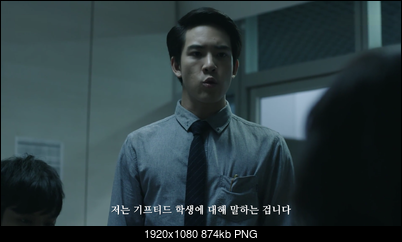

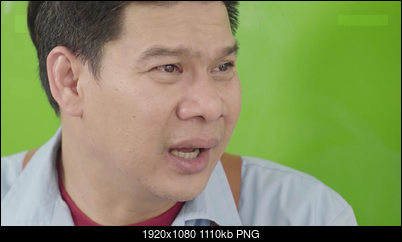

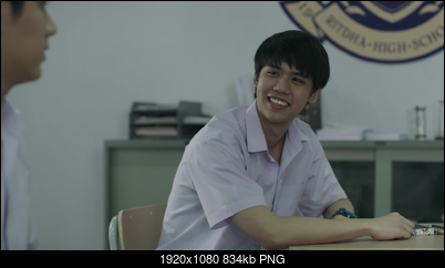

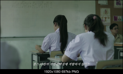

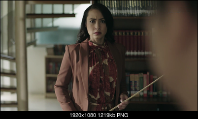

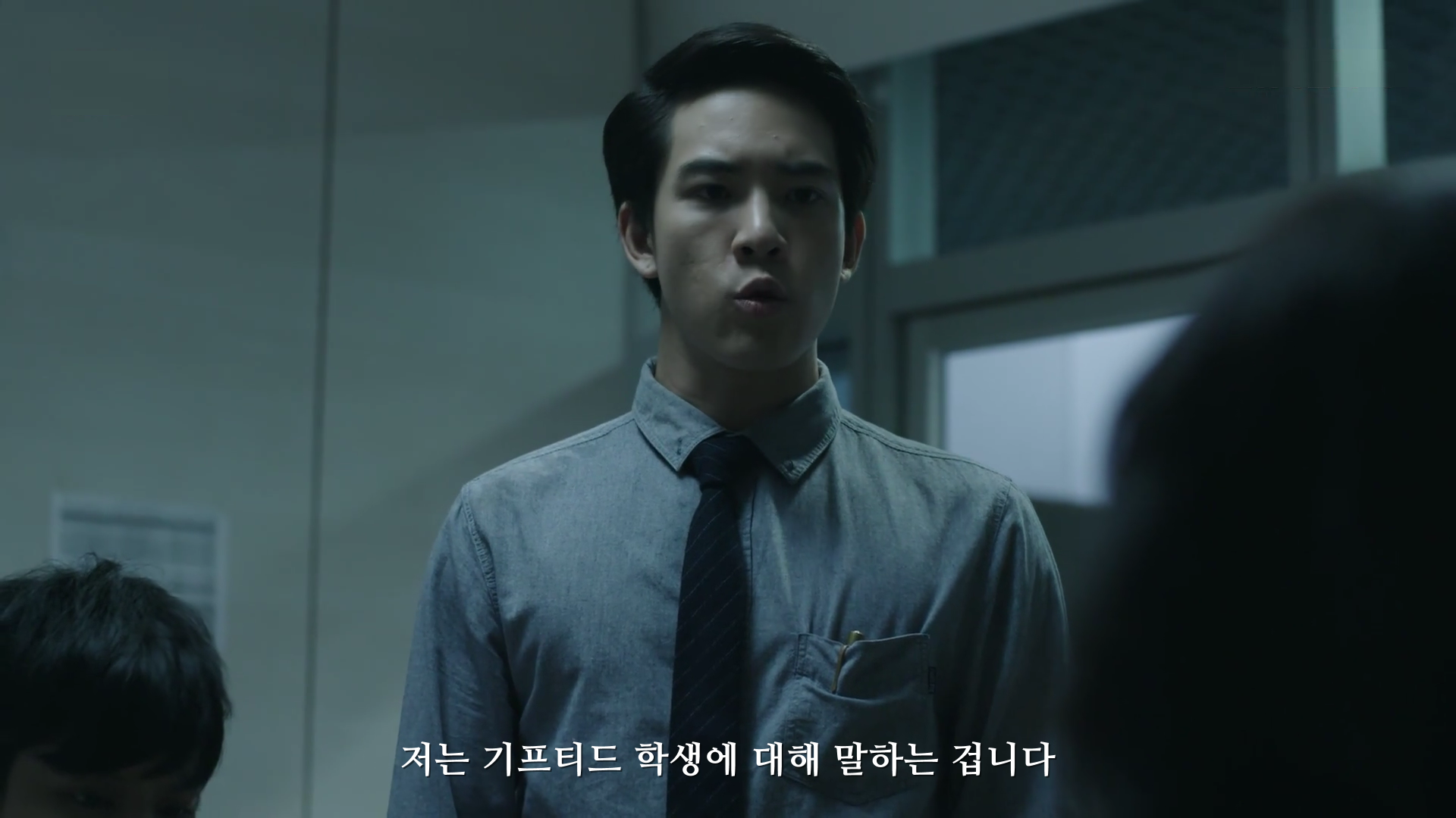

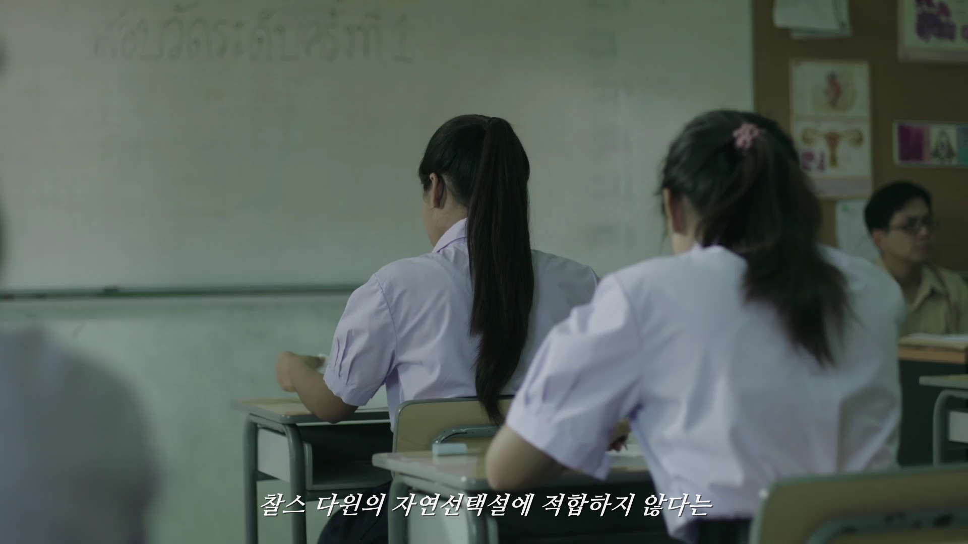

    But sometimes different colors at some screen.
    I guess.. It depends Blue color.. right?
    Could you give tips for me?
    Some of Those picture has nothing problem.
    But The others picture has problem.. a little colors different.

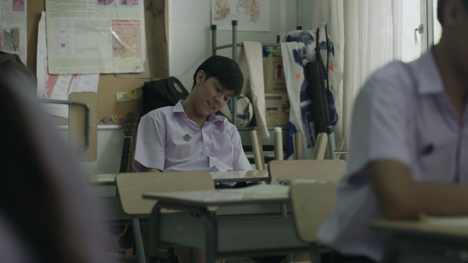

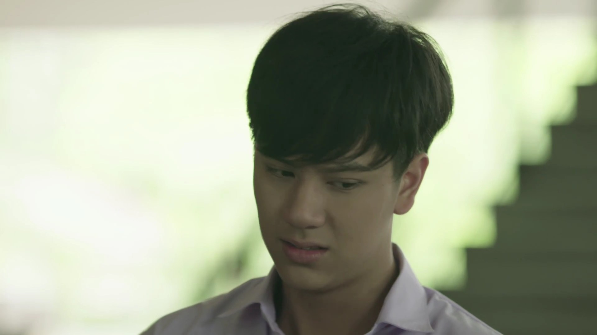

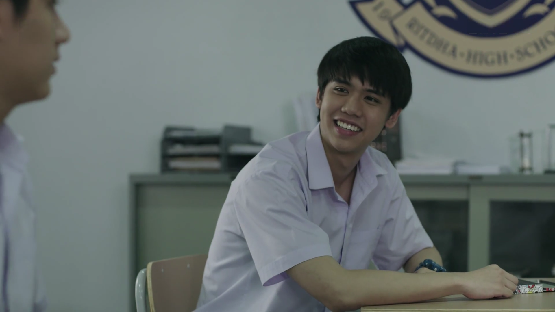

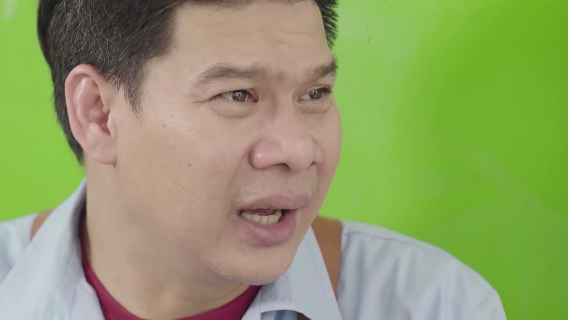

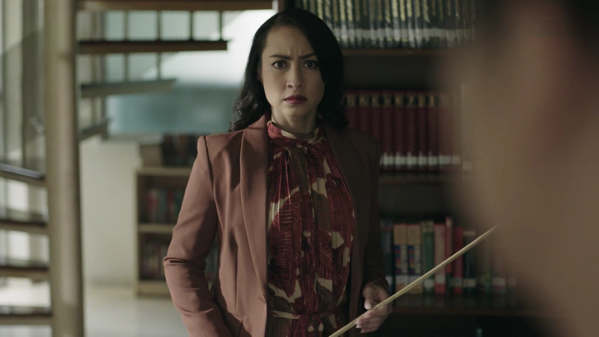

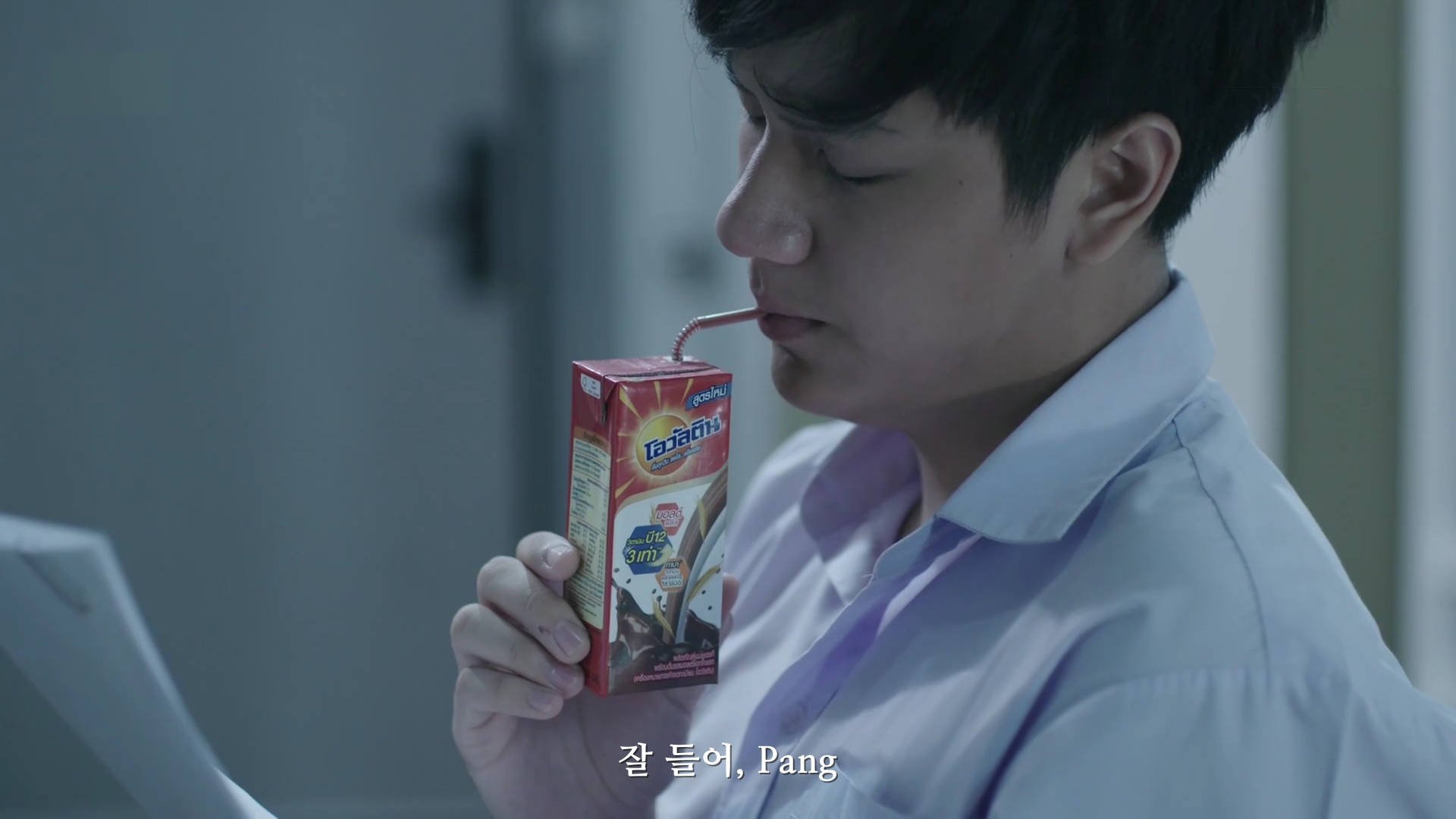

ID:	46495Click image for larger version
ID:	46496Click image for larger version
ID:	46497Click image for larger version
ID:	46498Click image for larger version
ID:	46499Click image for larger version
ID:	46500Click image for larger version
  6. Rec.601 vs rec.709 effects green the most, red moderately, and blue the least. It has no effect on greyscale. My suggestion was for fixing the problem you're having erasing the logos. You're not going to fix the general color problems of your videos using ColorMatrix(). All those color variations in your samples are artistic choices in color grading (or just badly produced video!). 6.png is the only one that has near natural colors.
    You need to figure out which color matrix your sources use and compensate for them. In general, HD video uses rec.709, SD uses rec.601. And it's best to specify the color matrix when you encode.
    You should also verify how your system and software are set up to display video and produce screen shots -- so you see the colors correctly.
