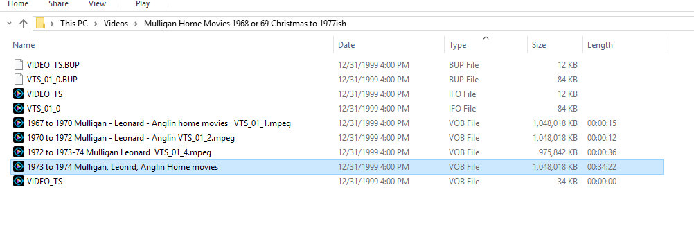

    I attached a screen shot - the file I am having issues with is '1973 to 1974 Mulligan, Leonard, Anglin Home movies'

    Essentially you have renamed the vob files. Hence they can not be recognised.
    Rename them back to what they were ie remove all the text BEFORE vts... and rename the troublesome vid to vts_01_3.vob and the mpeg part back to vob.
