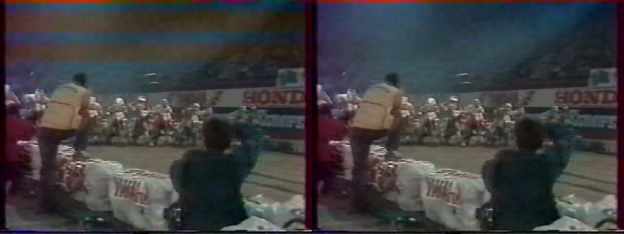

    I would like suggestions to repair this video and apply the correct filters to try to improve it
    Sample:
  2. Member Caiosouza's Avatar
    Nov 2013
    Capćo da Canoa, RS, Brazil

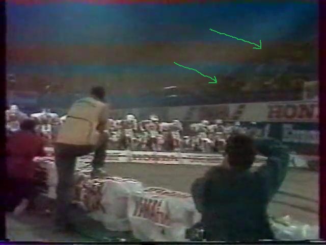

    Can I remove these stripes from the video?
Name:	Sample-1986 Supercross Bercy.mp4_snapshot.jpg
    Aggressive temporal NR and aggressive chroma NR would severely reduce it.
    But the clip also suffers from block noise, mosquito noise, and deinterlace artifacts.
    It was just a crappy transfer from a rotten non-quality VCR. Probably nth gen, copy of copy, each using lousy VCR along the way.
    It can never be 100% removed, but it can be severely reduced.
    CCD and Dyn MMX NR in VirtualDub improved it some.
    But KNLmeansCL may be even better.
    With help of poison here at VH, I (re)wrote a script that did great with worse source:

  5. I don't have a supported GPU so I can't use KNLMeansCL. Another option with TNLMeans:
    LSmashVideoSource("Sample-1986 Supercross Bercy.mp4")
    Spline36Resize(width/2, height)
    MergeChroma(RemoveDirtMC(100).TNLMeans(ax=4, ay=4, az=4, h=6).aWarpSharp(depth=20))
    TemporalDegrain(SAD1=100, SAD2=75, sigma=4)
    SmoothTweak(saturation=1.3)
    Santiag()
    aWarpSharp(depth=5)
    Sharpen(0.3,0.0)
    nnedi3_rpow2(2, cshift="SPline36Resize", fwidth=width*2, fheight=height)
    In the end it's a little better but I don't think it's worth the time and effort. Sample attached.
  6. The big problems I saw was the disappearance of certain colors (mostly in the red end of the spectrum) for one frame at a time. If I were to devise a script for this, it would look something like this:
    1. Separate luma and chroma layers.
    2. Average chroma over two frames. Possibly use motion estimation to get better alignment.
    3. Recombine averaged chroma with original luma.
    You could then apply noise reduction to deal with the normal bad video artifacts that you have.

  10. If you're looking for more noise reduction increase the TemporalDegrain() settings rather than adding more temporal denoising filters.
  11. Image
    [Attachment 46483 - Click to enlarge]
    MergeChroma(TemporalMedian(2))
    That's it.
  12. Originally Posted by Chief Mouse View Post
    That's it.
    That causes a loss of color on fast moving objects. Of course, MergeChroma(RemoveDirtMC()) may do that too, just less often.

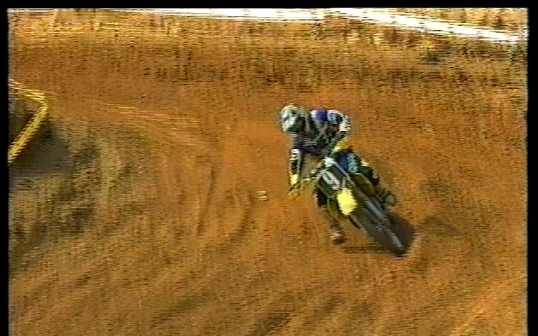

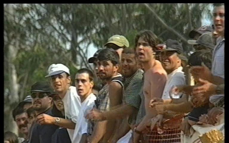

    I would like to catch the opportunity of the topic to see if there is a solution for this:
    1-How to correct this aspect ratio, I know the original VHS video was PAL 25fps 720x576 but was converted and cut wrong for NTSC 720x480 29fps ....
    (1-Sample-1999 MX 125.mpg)
    2-There are jumps in the frames, wrong framerate? what is this anomaly?
    (2-Sample-1992 Bercy SX.avi)
  14. Some of the jerkiness comes about because someone converted 25 fps pal to 29.97 fps ntsc by duplicating frames. You can remove those with:
    Mpeg2Source("1-Sample-1999 MX 125.d2v", CPU2="ooooxx", Info=3)
    TDecimate(Cycle=6, CycleR=1)
    QTGMC()
    Some of the jerkiness is just from a bad capture where several frames were dropped.
    As for the aspect ratio, There isn't any good reference within the clip but it appears that someone took a 720x576 PAL frame and cropped 96 lines off the bottom to give a 720x480 NTSC frame. It that's the case it has a PAL ITU SAR of 12:11. So resizing the frame to 786x480 (786 ~= 720 * 12 / 11) and cropping the black borders may give you the right display aspect ratio for a square pixel encoding.

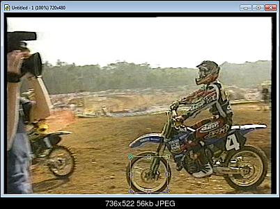

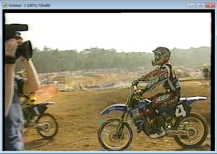

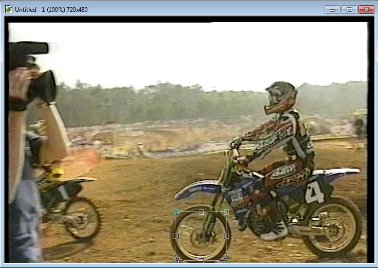

  22. Originally Posted by Caiosouza View Post
    Is Correct 3:2 to "1-Sample-1999 MX 125.mpg" ?
    No. The correct display aspect ratio after removing black borders appears to be about 1.6:1.
    Find a shot with a wheel is viewed directly from the side (ie parallel to the axle), as large as possible. A perspective something like this:
    Then check the width and height of the wheel. When the display aspect ratio is correct the wheel should have the same width and height.
  23. Member Caiosouza's Avatar
    Nov 2013
    [Attachment 46526 - Click to enlarge]
    Something like this?

  25. 1999MX-1.mpg is close. It's not perfectly aligned but it's not off by too far. It looks like the video is already close to square pixel. In this square pixel view in VirtualDub the box around the rim is 98x95 pixels:

  26. Originally Posted by Caiosouza View Post
    Could this grotesque creature improve in any way?
    You can adjust the levels but you can't fix the blown out brights. You can probably use Gradation curves in VirtualDub to get better colors.
  27. Member Caiosouza's Avatar
    Nov 2013
    [Attachment 46542 - Click to enlarge]
    This is a video source, but, the question is:how is the process to adjust the aspect ratio to something close to what it should be?
    704x432 16:10
    And fail again...

    All I did here was remove the color noise with KNLmeansCL.
    But you can do a lot more from here, with this new source, far less color/chroma damage now.
