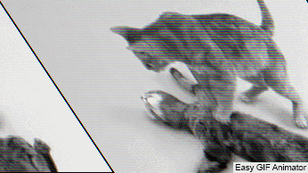

  1. I downloaded a cute GIF from Twitter, which was in an .MP4 file, of a cat giving CPR to another cat. I do not understand why Twitter calls this a GIF when the source file appears to be .MP4, but okay. I then tried to convert the .MP4 to a .GIF using Easy GIF Animator for Windows, and I get the horrific result in the attached .GIF. It looks like there is some kind of interlacing issue here. Can someone identify what I need to do when creating the GIF to have the color return and the normal frame orientation return?
    [Attachment 46449 - Click to enlarge]

    Have you looked at the mediainfo of the source file for clues?
  3. Try using mod4 (integer multiples of 4) frame sizes.

  5. Originally Posted by jagabo View Post
    You were right and this solves the problem.
    What is going on here?
    Mar 2008
    Some decode codecs mess up on mod 2, I think that's all it is
  7. A lot codecs and programs can't handle mod2 frame sizes.
    Aug 2013
    Central Germany
    The original video probably had an odd width, and the converter used optimized routines expecting image lines being aligned with WORD (2 byte) or DWORD (4 byte) RAM addresses. The lack of colors confirms this guess, it probably lost RGB color information due to misaligned colors.

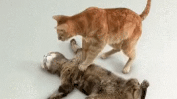

  12. Originally Posted by pone44 View Post
    twitter converts all gifs to mp4
    BTW , a higher quality version of the original commercial is here
    https://vimeo.com/35402870
    A higher quality starting point usually means you have more options to optimize it better ( whatever you're doing, whether it be gif, or something else). It will be cleaner, higher signal to noise ratio in general.
    That mp4 and gif you posted are frame sampled as in fewer frames (the original animation is 23.976p, with roughly 2x the frames for that sequence). But some other common techniques used to reduce filesize are denoising, variable frame timing (e.g. that mp4 and gif has 1 repeat frame at the end, by using variable frame timing, you can cut off that last frame and hold the 2nd last frame 2x longer, reducing the filesize), lossy encoding (not just palette color reduction, but you can "degrade" each frame too), dithering options (some produce smaller filesize with similar visual quality) . These are all quality/filesize tradeoffs, and not all programs necessarily have these types of options. Sometimes you need to use several programs
