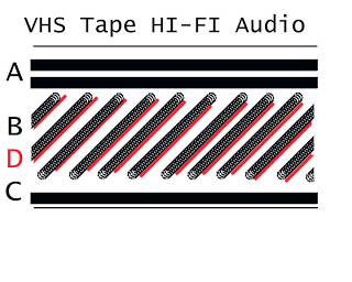

    The linear track can be mono or stereo. The linear track is recorded linearly (just like a cassette) along the side of the tape. It has a low bandwidth, especially with slower tape speeds. The Hi-Fi track is recorded by the helical scan heads, next to the video tracks. This page has a picture:
    http://videosuite.blogspot.com/2007/05/picture-but-no-sound.html
    Name:  vhs tracks.jpg
    A is the linear track(s), D is the hi-fi track. All tapes must include a linear track, and all players must be able to play the linear track. If the linear track is stereo it can be encoded with Dobly Pro Logic surround sound.
    Jul 2007
    As I recall, there were issues playback of stereo tracks on mono VCRs, particularly crosstalk between channels. Understandable given the small width given to the audio track.
  12. There should be 100 percent crosstalk when playing a stereo linear track with a mono player. Ie, it should be a 50:50 mix. The problem would be when the playback head is mis-aligned and you get an uneven mix.
  13. I believe this picture is not entirely correct - HiFi track may use different angle (so audio track will be not parallel to video) and it use different spectrum (thus provide frequency separation) - VCR record B/W signal (except linear audio) - all signals (except linear audio) are converted to FM but they are located in non overlapping (from spectrum perspective) zones - HiFi audio occupy spectrum before chrominance and chrominance before luminance - as HiFi FM has lowest frequency thus it can penetrate tape deeper than for example chrominance and especially luminance signals.
    Aug 2010
    San Francisco, California
    In VHS Hi-Fi, FM audio is placed between chrominance and luminance bands. Audio tracks are perfectly parallel to video tracks; they have to be, since the heads are on the same circle. Audio tracks are recorded deeper into the oxide and video tracks are recorded on top of them. The "different angle" is head azimuth, which makes the appropriate signal stronger for the appropriate playback head. FM capture effect does the rest.

  17. Member Cornucopia's Avatar
    No, jagabo was correct: the non-hifi audio head(s) are stationary (not rotating - the video & hifi heads do that), so when the tape passes by LINEARLY, it gets recorded, linearly, along the top edge. (Bottom edge has control track).
