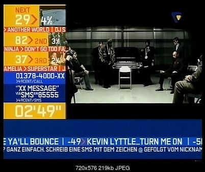

  1. I have some "jumping frames" like this.
    Correct this with following script:
    avisource("Jumptest.avi").assumetff
    separatefields()
    e = selectodd()
    o = selecteven().crop(0,1,0,0).addborders(0,0,0,1)
    interleave(e, o)
    weave
    cropbottom(2).addborders(0,2,0,0)
    The result:

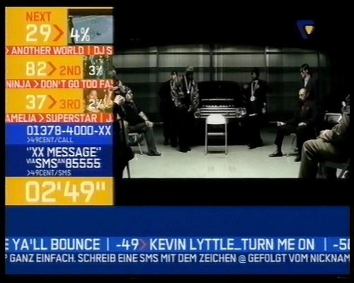

    Convert it to a 25p file, everything is OK. When you move the mouse on screenshot, the next deinterlaced frame (wich is neddn't to fix) is shown.
    Nothing jumps or have artefacts.
    http://screenshotcomparison.com/comparison/118029
    But when I use QTGMC to make a 50p file, theres something strange.
    Here you can see the two fields from the one fixed frame.
    It's jumping/glitching or so.
    http://screenshotcomparison.com/comparison/118030
    OK, it's a small issue, but I have more than one "jump" in one second sometimes and it looks very glitchy then.
    Why is this happen when I convert to 50p but deinterlacing is OK.
    Hope someone can help me. With this issue i won't go on with digitized.
    I think the picturequality is very good (see horrible other qualitys here in the forum), so I want the best result and I want a good 50p file
    PS: Don't look at the other improvement issues in this testfile clip

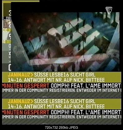

    Another broken field, here you can't see it jumping when you look at the interlaced frame, but after 50p QTGMC you will.

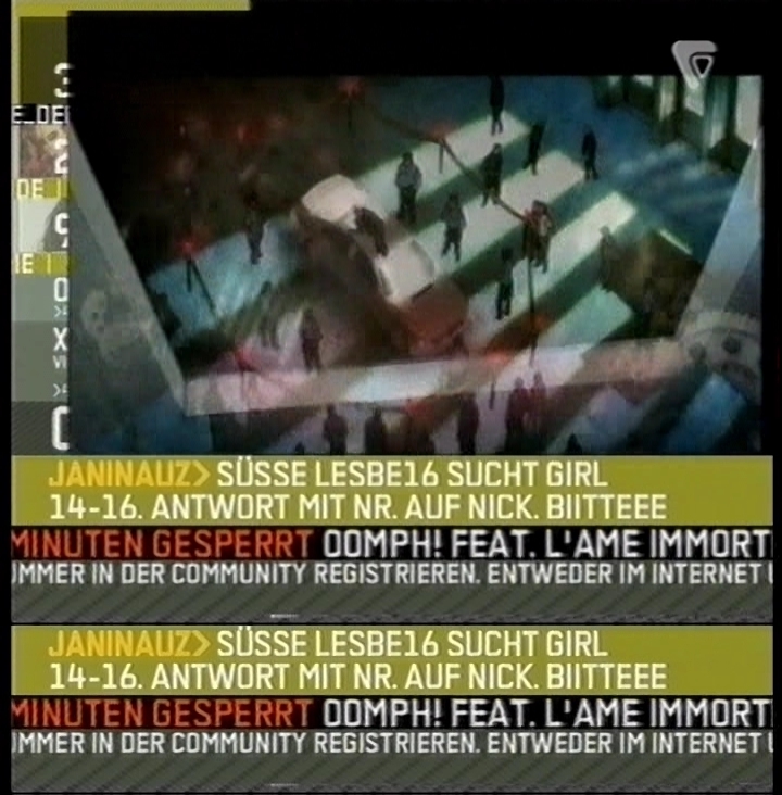

  21. The bounce in jump_04.avi is caused by QTGMC getting confused by the upper part of the picture. There's nothing wrong with the cap. You can verify this with:
    [CODE]AviSource("jump_04.avi")
    ConvertToYV12(interlaced=true)
    StackVertical(QTGMC(), Crop(0,420,-0,-0).QTGMC())[CODE]
  22. The bounce in jump_04.avi is caused by QTGMC getting confused by the upper part of the picture. There's nothing wrong with the cap. You can verify this with:
  24. The script is showing exactly what I meant it to show.
  25. I don't understand exactly.
    The bottom, smaller part looks fixed.
  26. The point was that there's nothing wrong with the source video. QTGMC just messes up when deinterlacing the full frame (the top ~3/4 of the output video). If you just deinterlace just the bottom part of the frame in isolation (the bottom ~1/4 of the output video) the text doesn't bounce.
  27. OK I understand.
    But why is QTGMC doing this? There must be any reason for ths problem...
    Just now I found an other Deinterlacer: TDeint
    Assumetff()
    TDeint(mode=1)
    And I'm happy. No little juming issues with TDeint.
    http://screenshotcomparison.com/comparison/118180
    But wait, what's that? TDeint make other glitchy things.
    http://screenshotcomparison.com/comparison/118181
    The Deinterlacer from Tom Barry isn't a good choice, too.
    http://avisynth.nl/index.php/TomsMoComp
    Guys, I'm so confused / hopeless / little bit angry / it's killing me.
    I think it's easier to build a house or a car than deinterlace a video glitchless
    I'm still open for suggestions
  28. Member Bernix's Avatar
    Apr 2016
    Europe
    Hi,
    have you tried Yadif with bob and temporal and spatial check on? It is considered as good deinterlacer also I think
    Edit: in jump_04.avi you posted Yadif do not create jump.
    Bernix
  29. Originally Posted by diginoob View Post
    Assumetff()
    TDeint(mode=1)
    Your problem with TDeint is that you need to ConvertedToYV12(interlaced=true) before calling it. But...
    There's no such thing as a perfect deinterlacer and there never will be. It's not possible to perfectly restore missing scan lines. For most material QTGMC is far better than any the others. Yadif is a distant second. It leaves little bits of crap all over the place. And buzzing, aliased edges.
  30. Originally Posted by jagabo View Post
    And this makes the line artefacts?
    Yadif does make only 25p, right?
