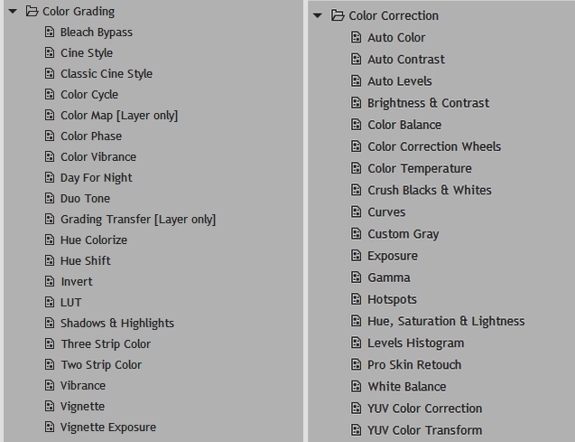

    hitfilm is considered more of a compositing tool/effects program
    The Pro version of Hitfilm seems quite sophisticated on the options for color grading. Have a look at the options.
    Now I have learn how to use it.
