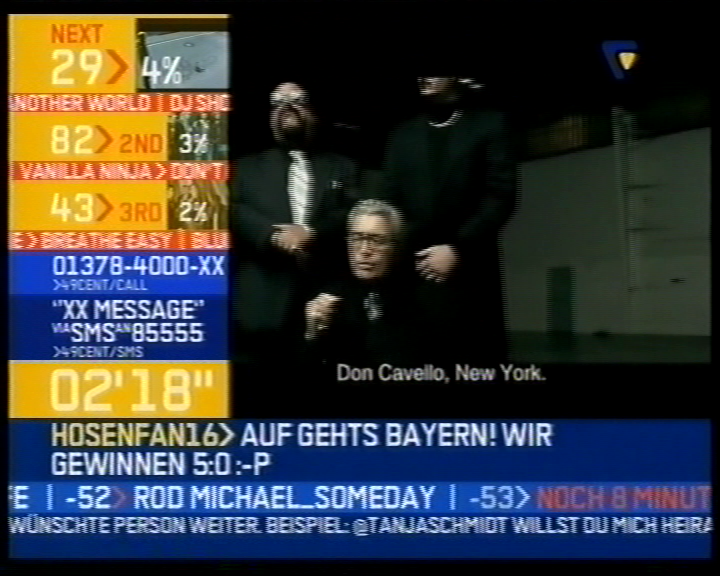

  5. This is strange.
    With SPline36Resize: (Screenshot 1)
    The dot crawls on the timer are gone, but on the left upper on the numbers etc. NOT.(I didn't realized that before)
    With TemporalDegrain: (Screenshot 2)
    The dot crawls on the time are NOT gone, but the left upper on the numbers etc. are. And it's a little bit sharping the hole picture. (Good to see at the telephone numbers)
    With both plugins I get the best result, I think. (Screenshot 3)
    Check Screenshots.
    I don't see any negative artefact, when I use both at this time. (See you?)
    But it takes, of course, a longer time to render and I've hours of material.
    (Or is there a 3rd "perfect one method" out there? )
    Should I convert to 50p before eleminate the dot crawls?
    I'm asking because the TemporalDegrain site says, that the plugin works "Progressive input only".
    But in my eyes, it works with my interlaced materials, too.

  6. I used a Panasonic DMR-EX77 DVD recorder to digitize.
    My neighbor has the exact same model and I try his recorder:
    NO heavy dot crawls at the countdown only just a little bit with I can fix with TemporalDegrain plugin!
    So what? The recorders have the same options but his have a better (whatever?). NR is off on both etc.
    Same cables/Adapters are used.
    This is strange. Again.

  7. Originally Posted by diginoob View Post
    Those are horizontal time base errors, not dot crawl. You need a line time base corrector to get rid of those.

  10. Originally Posted by diginoob View Post
    But the Panasonic DMR-EX77 has one
    Are you sure? I spent a few minutes looking at the user manual for the EX77
    https://www.panasonic.com/au/support/manual-download/players-recorders/video-recorders/dmr-ex77/
    and found no mention of TBC or "time base" or anything else like that. I then went to the "summary of settings" that begins on page 61, and the only improvement or correction settings I could find is a comb filter, which can improve dot crawl, if that is indeed the problem you have, but is not a time base corrector.
  11. Well, if I am reading that post correctly, the Panasonic engineer pretty much said that it does not have a true TBC. Also, the frame synchronizer may only affect the signal sent directly to the unit's DVD recorder, and may not improve the signal sent out via composite or S-video outputs. However, I can't really tell that for sure from what was written in that post.

  13. That TemporalDegrain is reducing the time base wiggle but it's doing quite a lot of damage to the interlacing in the live portion of the picture.
